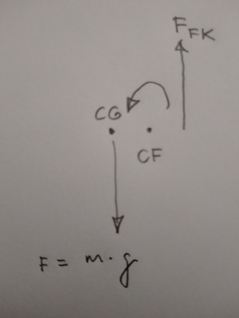

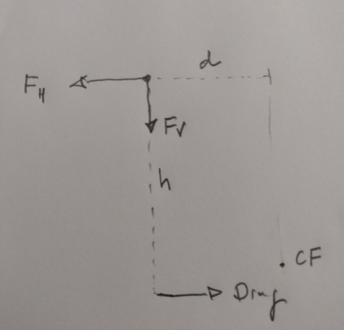

    The three causes of bow-down in a sailboat:
    1) Sail Force = sum of the horizontal component multiplied by its lever arm (F_H x h) + vertical component (due to heeling) multiplied by its lever arm (F_V x d)
    2) A wide stern and/or "heavy quarters": when heeling, it pushes more volume into the water at the stern than at the bow: the center of Buoyancy shifts aft and the bow shifts downward

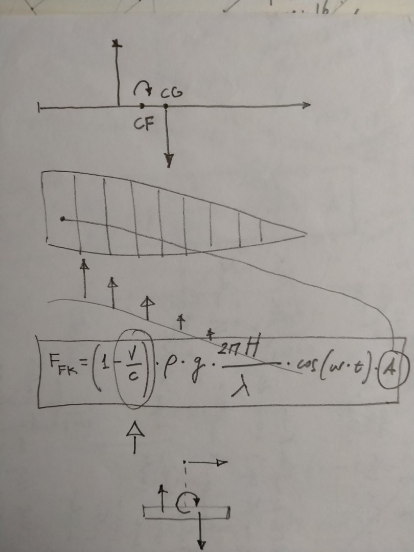

    3) The yacht's center of Gravity is forward of the center of Flotation (CF, which is where the pitch axis for hull trim passes), and the force of the wave (the Froude-Krylov force) is located aft
    If, to complete the task, we place the hydrodynamic center of a huuuge modern Keel forward of the Yacht center of gravity ...
    ... we ensure that the yacht capsizes with a beautiful pirouette:
    this is how 5 yachts capsized or disappeared into the sea in the 1997 demolition derby, where Aqua Quorum performed wonderfully.

    To stumble on the hull and keel, it only takes one second. The hull and keel trip up the yacht.
    Aleksey Krylov - Wikipedia https://en.wikipedia.org/wiki/Aleksey_Krylov
    Mr. Froude and the bearded Krylov raise the great, wide stern ... and they give the yacht a push forward and leave it in Sir Isaac's hands to complete the task
    and Sir Isaac Newton drags the yacht with the Almighty Force of the Earth = Newtons = mass x g x sin Wave slope
    And the yacht, propelled by the force of the wind, the force of the sea, and the Almighty Force of the earth, performs a beautiful pirouette.

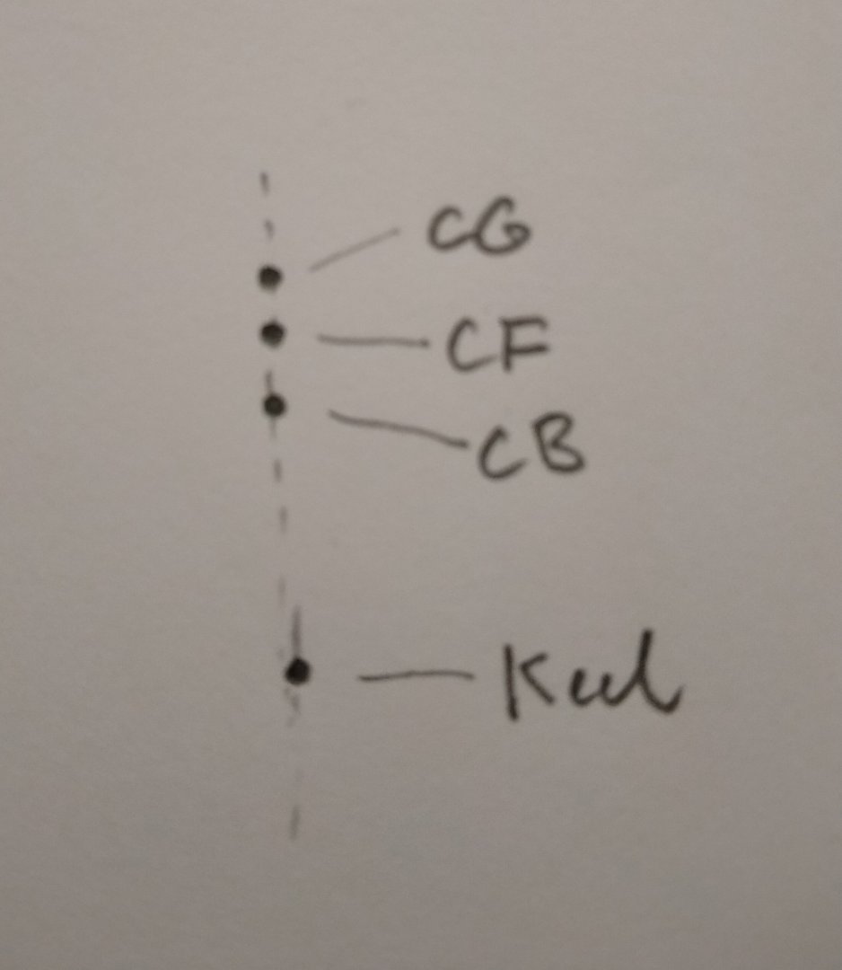

    The problem
    The problem isn't that the bow drops (Pitch for example -2°)
    The problem is that Pitch is the trigger for a tremendous explosive cocktail formed by Pitch, Roll/Heel and Yaw/Leeway
    Sighard F. Hoerner - Wikipedia https://en.wikipedia.org/wiki/Sighard_F._Hoerner
    Hörner, Fluid Dynamic Lift
    Hörner, Fluid Dynamic Drag
    "cross flow" + Mister Max Michael Munk = huuuge hydroDynamic Yaw Moment of the Hull
    Max Munk - Wikipedia https://en.wikipedia.org/wiki/Max_Munk
    + huuuge Keel forward of Yacht gravity center
    = the yacht capsizes

    Solution: Do things right, like Aqua Quorum: the centered keel
    Centered on the fundamental primordial Center of a sailing yacht: the Center of Flotation
    google: site:boatdesign.net center of flotation

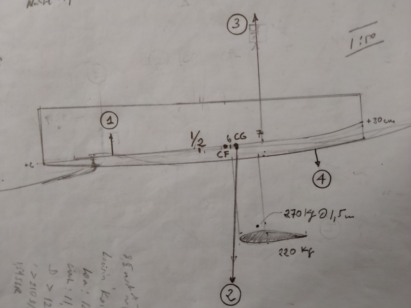

    What's the point of building off-center, unbalanced yachts just to drive the sailor crazy?
    Why not make sailboats with a little love and care and respect for science and good balance
    For example:
    - Longitudinal position of the Center of Gravity (CG)
    - Longitudinal position of the Center of Flotation (CF)
    - Longitudinal position of the Center of Buoyancy (CB)
    - Longitudinal position of the hidroDynamic center of the Keel

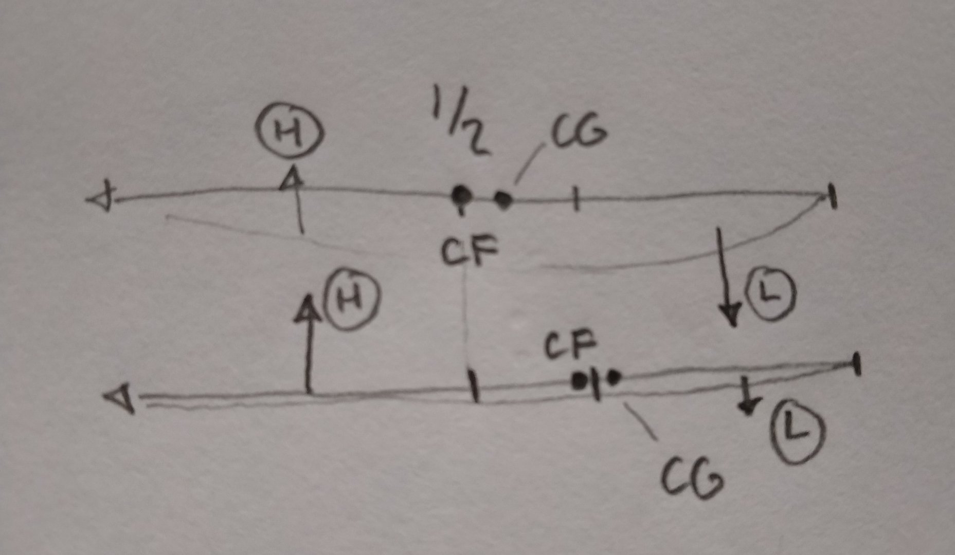

    But it's the same thing, just in different forms.
    The heavy surfboard (a 5-10 ton yacht, 10 square meters per ton) with its moderate stern would have its center of Flotation (CF) at 50% LWL and its center of Gravity at 54%, and when accelerating it creates high (H) pressure under the bow (hydrodynamic lift) and a lot of low (L) pressure (hydrodynamic suction) under the stern.
    The fast, ultralight surfboard (1-3 ton sport yacht, 40 square meters per ton) with a gigantic wide stern would have its center of Flotation (CF) at 58% LWL and its center of Gravity at 62% LWL, and when accelerating it creates a lot of high (H) pressure under the bow and a little bit of low (L) pressure under the stern.

    That would be an unstable state. It will return to a stable state where the CG and CF are vertically aligned. This is basic physics.
