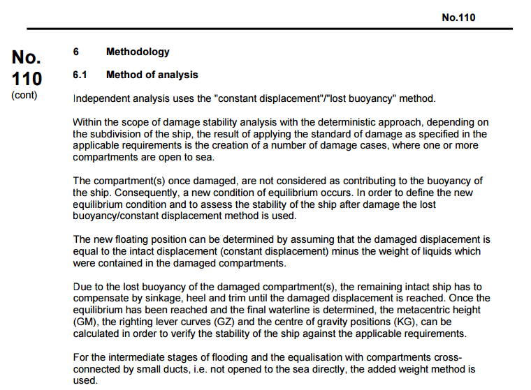

    Hi Rabah, the description of the lost buoyancy method in the files you provided is general. If you read IACS Guideline for Scope of Damage Stability Verification for new oil tankers, chemical tankers and has carriers on page 9 it clearly states:
    "The new floating position can be determined by assuming that the damaged displacement is equal to the intact displacement (constant displacement) minus the weight of liquids which were contained in the damaged compartments."
    According to the aforementioned quote there would be a change in both displacement and centre of gravity.

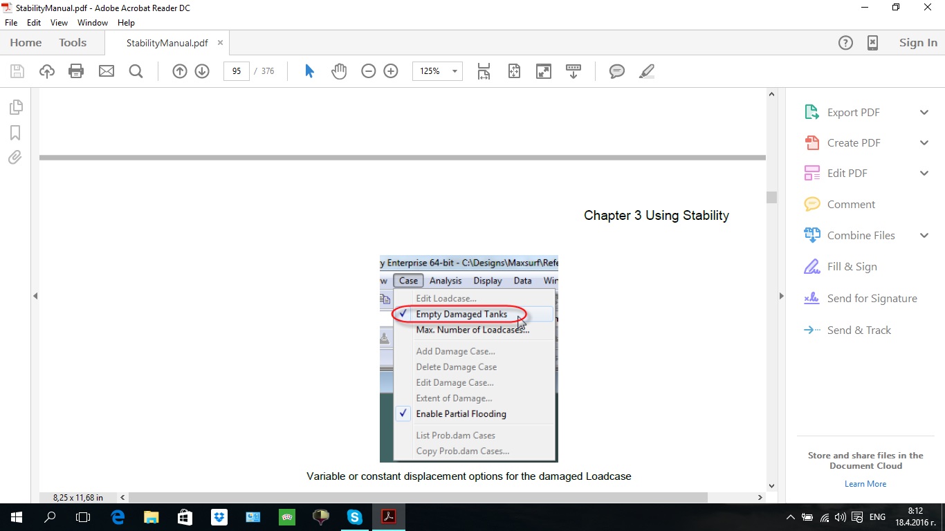

    Please see the files from Manual of Maxsurf Stability!

    The manual from Maxsurf stability gives their definition as used within that software but it is not an absolute definition. Its common/good practice to assume that cargo has been lost when a tank is damaged and an assessment is being conducted using the lost buoyancy method. See attached capture.

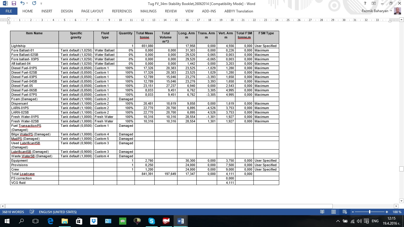

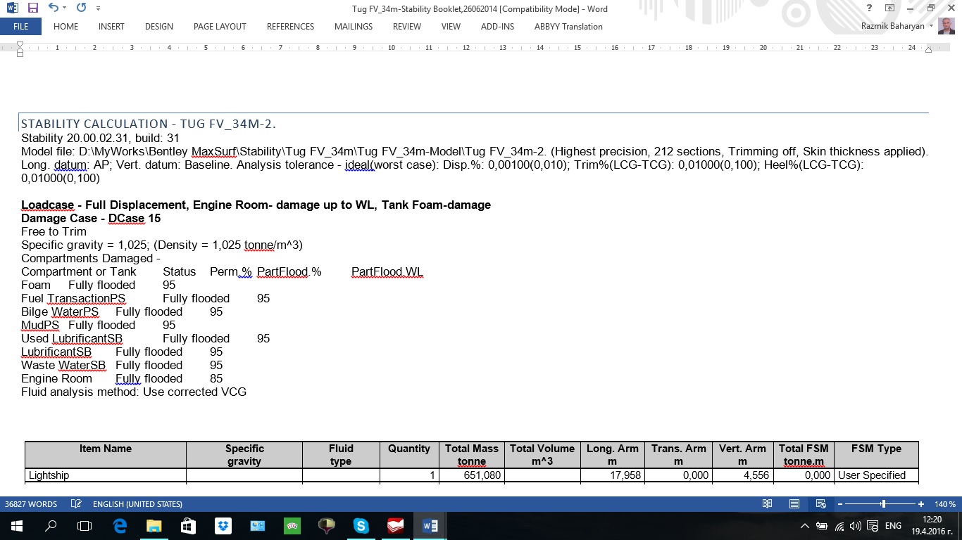

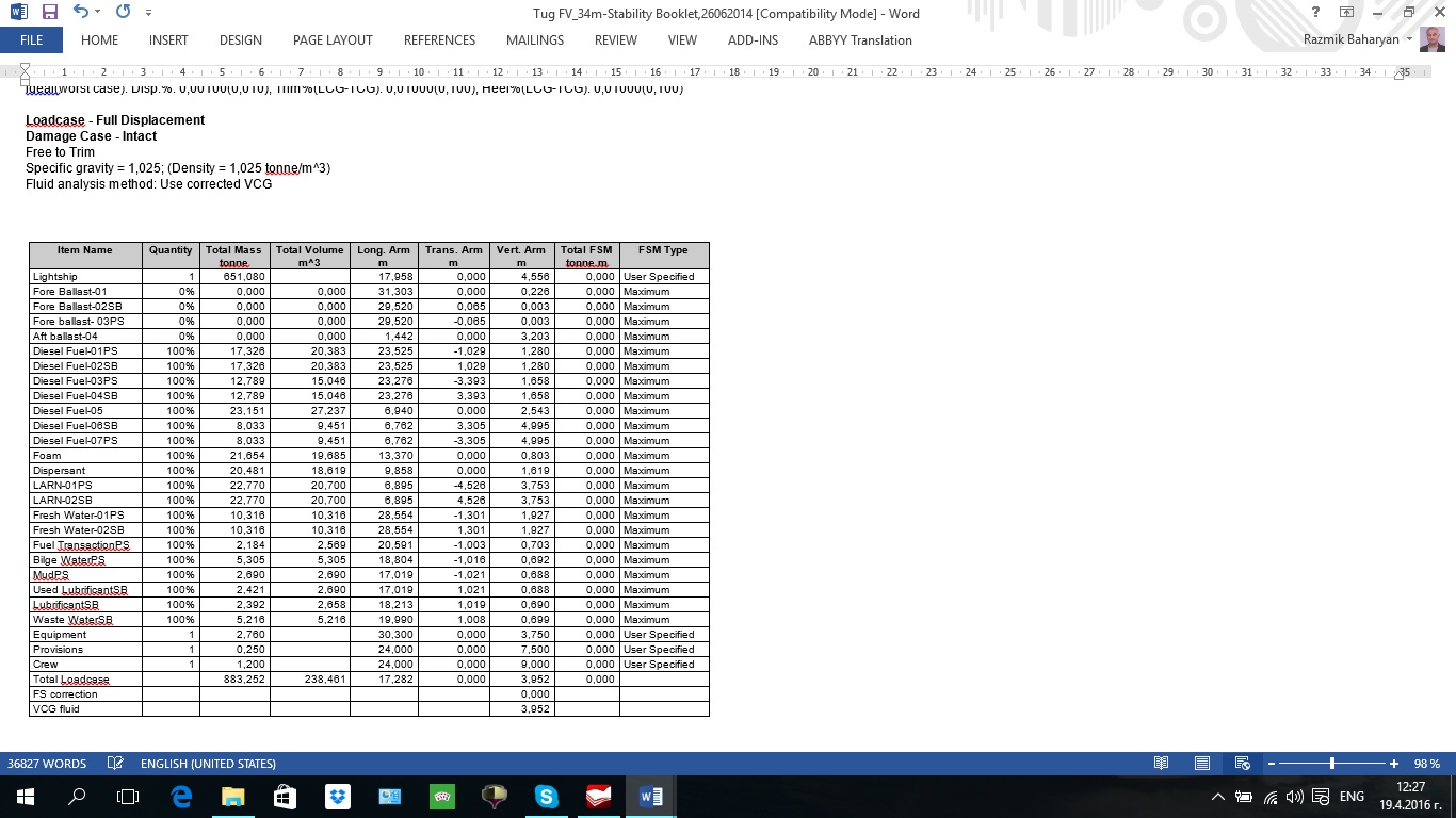

    In May 2014 I have made a calculation of the unsinkability of the tug 34m with the programs Maxsurf Stability, Sea Hydro and Dialog-Static.
    If to you it is curious see the link http://www.boatdesign.net/forums/bo...ility-unsinkability-asd-tug-fv_34m-50860.html
    See the Maxsurf Stability booklet.
    That you point that as a normative request of IACS, in effect Maxsurf Stability fulfills major virtuosity, fast and snug.
    Extraction for Damaged case 15 - damage in Engine Room, see on the following pictures.
    In the table of Load case 15 the program will equate to null of weights of fuel and other fluids in the fuel and other tanks located in the double bottom in the zone of damage Engine Room.
    For this purpose if to compare with the Full Displacement Intact Load case we shall see the following:
    Name of the case Displac,t LCG,m TCG,m VCG,m
    Full Displ-Intact 883,252 17,282 0,000 3,952
    Damage case15 841,391 17,347 0,000 4,111
    These 841,391t are constant displacement which remains without change before ultimate equilibrium position of Damaged Water-line.
    As itself you see in the concrete event of the variance in LCG and VCG is very minor.
    For me that does the program Maxsurf Stability is as precomputation of the loads as introduction in the main method “ Lost of Buoyancy ”.
