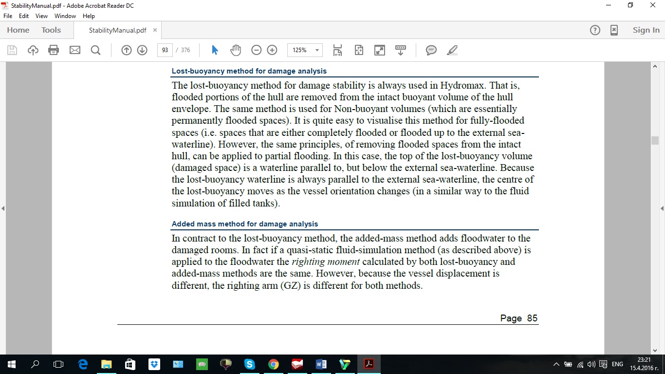

    Hi Gonzo,
    You have forgotten one very important condition - for tanks of a double bottom always there are air and measuring pipes, so that at accident of such tank outboard water easily on 100 % charges volume or if there was a fuel it expires and is changed outboard water.
    So that in this case Tansl rights, but he has no any right to scoff at you because his natural dropouts in knowledge on a ship theory as he showed it ignorance of methods of calculation on unsinkability are visible.
    That it was clear to all a file from Manual of Maxsurf Stability v.20 I publish.

    If we are speaking of regulatory stability calculation, there is no dynamic effect of water in damage tanks/compartments to take into account.
    About free surface effect in damage tanks / compartments, its very clear :
    - at intermediate flooding stages, calculation can only be done with the added weight method. In this case, the weight of liquid is added to ship's displacement. Free surface effect must therefore be taken into account.
    - at the final stage of flooding, you have to use the lost buoyancy method. In this case, there is no need to take any free surface effect into account : it should be a non-sens : you cannot take into account the free surface moment of a liquid which is not included in the displacement.
