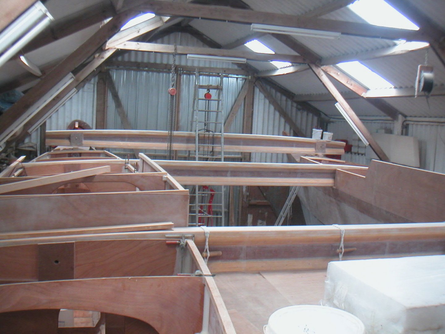

    I am Hanneke Boon, mentioned in the original post. I have been James Wharram's partner and co-designer for 50 years. I am appalled to read various people's speculations and prejudices in this thread and felt compelled to join the group in order to write my answer.
    I think we all know that what is written in newspapers often has to be taken with some skepticism. You are lucky if they spell your name correctly, but often the facts given in articles are far from the accurate truth. This was the case in the 1950s, just as it is to this day, when you read the sensationalist Red Top news papers, like the Daily Mail or the Sun. It was the Daily Express that reported the untrue story of the wrecking of Tangaroa on arrival in Trinidad and the sharks in the bay. It greatly worried James' parents as this is the first they heard of their arrival. An unscrupulous Trinidadian newspaper journalist, who met them on first arrival, had sold the story without permission and had not sent the promised telegram of their safe arrival to his parents (this is all written accurately in Two Girls Two Catamarans).
    Wharram's story as written in James' and my autobiography People of the Sea is the true story. James was greatly inspired by the voyage on double canoe Kaimiloa by Frenchman Eric de Bisschop. James studied Canoes of Oceania in depth to gain knowledge of Polynesian canoe types, but he ultimately based 23'6" Tangaroa on a model in the South Kensington Science Museum of a canoe from the Society islands. The model is still there, I photographed it some years ago. James had an original B&W photo in his archive, which he bought at the museum in the early 1950s. This photo is printed in Two Girls Two Catamarans. James could not build the curved hull shape out of the wood available to him, so simplified it into a flat bottom dory style shape. He would be the first to acknowledge that this first design was crude, but it served him to show a double canoe was seaworthy. He never planned to sail round the world on Tangaroa, that is a newspaper myth/exaggeration. He did later plan to sail round the world on his second catamaran the 40ft Rongo he built in Trinidad. I have every newspaper article from the 1950s in our archives and it is amazing how many facts they got wrong.
    All Wharram catamarans are connected flexibly in order for them to 'give' to large ocean waves without stressing the structure. On the early Classic Designs this was done with rubber mounts on metal brackets that acted as shock absorbers. The later designs from 1979 are fastened with rope lashings (metal fabricating has become very expensive). The flexing of these first prototype lashings was carefully calculated with the help of English Braids in 1975 for the first Pahi prototype, so they gave the same amount of flex as the rubber mounts. One must ignore the comments of people writing on this forum who have probably never sailed on a Wharram catamaran. The flexing of the structure is relatively small, but it focuses the stresses in the ropes and saves stress on the rigid wooden structure. Ropes can be replaced making for a very durable structure, avoiding the fatigue cracks that often appear in older rigid catamarans.
    Our small designs under 30ft like the Tiki 21 and the earlier Hinemoa can be bolted or fixed with short tight non-flexing lashings or webbing straps as the stresses are so much less in these boats.
    Read more about how we design here: Articles & Blogs | James Wharram Designs https://www.wharram.com/articles And anybody who believes that Wharram catamarans are slow should watch this video of a remarkable record Atlantic crossing on a Tiki 38, where they averaged 6.5 knots over the whole 4500Nm 31 day voyage from New York to Marseille (averaging 150Nm/day) and had a peak speed of 17.1 knots
