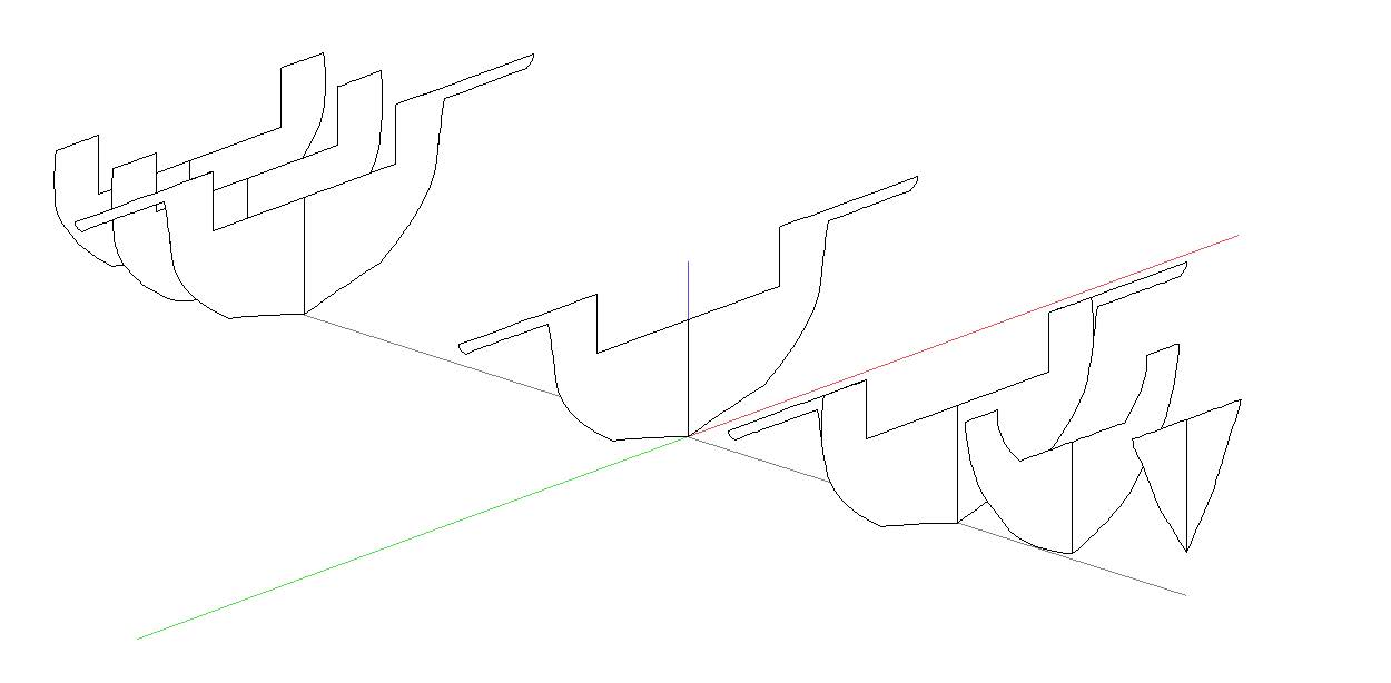

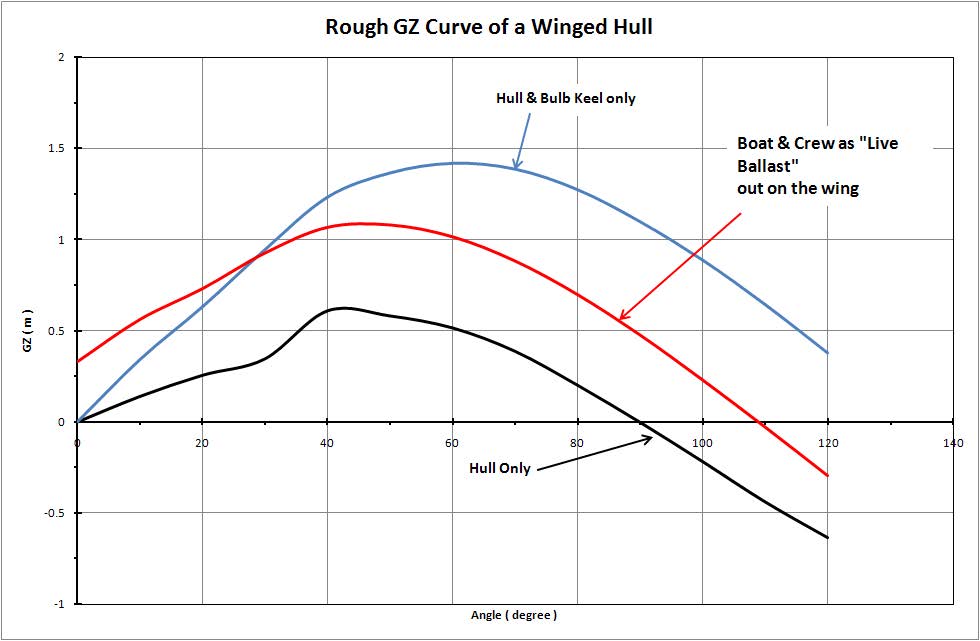

    Got bored of doing FEA all day yesterday, so i thought for amusement i would have a little "play" with my hydro porgram.
    The below images are very very rough, no claim to be exact nor accurate. But from the principal dim's given on several websites a few figures can be reversed engineered to get a "feel". The hull is shown, just so you can the crude model i did. I was very generous with everything being over pessimistic as such....so perhaps a "best" case.??

    Ad Hoc, I realize that you say your drawing is a rough indication of the K35 ... but you should look again at the rear view photograph of the boat posted on 224: the starboard wing, look closely, has considerably more buoyancy in the area where the flared hull and wings combine - they are not flat wings as you have indicated. I'm sure you will say that is irrelevant, a wing is a wing, but with that buoyancy, the boat at 100 degrees or so, is not going to lie as deep in the water as you have perhaps envisaged.

    How did you estimate the position of the center of gravity of the hull? Did you include mast, etc?

    Indeed...but the wings are also not part of the hull, so they are fixed onto the hull, which requires fastenings of some kind and takes up "space" and adds more weight than the wing in the location has buoyancy!. So..swings and round abouts. But if one wishes to be pedantic, all it shall do is increase the peak (GZ) post wing immersion..but wont alter the range...since the deck line remains as it is. You're only adding a small amount of buoyancy in the 40-80 degree range, that is all.
    Looking at this link:
    http://sailboatdata.com/viewrecord.asp?class_id=1014
    The displacment is 1293kg...so the hull only is 794kg. Thus without the 499kg bulb(keel) where would the VCG be?...so the hull has a VCG somehwre in the centre of the hull but a tad lower, owing to heavier skins on bottom and also the sole being low. So this would suggested around 1/3rd of hull depth. Then you have the rudder below...and then the mast and sails above..and sails on the deck bringing the VCG back up again...so very roughly..the VCG could be assumed to be around the deckline.
    From this, add the 499kg bulb, at some 2.0m below the hull. The hull bottom being 0.0m
    That is a pure guess based upon what limited data is shown, as I noted above. Feel free to provide a more "accurate" VCG ...

    No bulb hull+rig VCG around the deckline seems good enough to me, thanks.
    Now, taking into account your hull+bulb GZ curve, LPS (+/- 130 deg, in the line of Doug's rough estimative) is well over the +/- 95 deg roughly deduced from the ORR's 100 SI figure :confused:

    Exactly. A rough guesstimate is easy...not an absolute...but a rough idea. So either i have made a massive error and incorrect assumption..or, the data being thrown about (which is very hard to verify anywhere), is not what it claims to be.
    Since once the keel is added...the GZ is as you say...confusing!! :confused:
