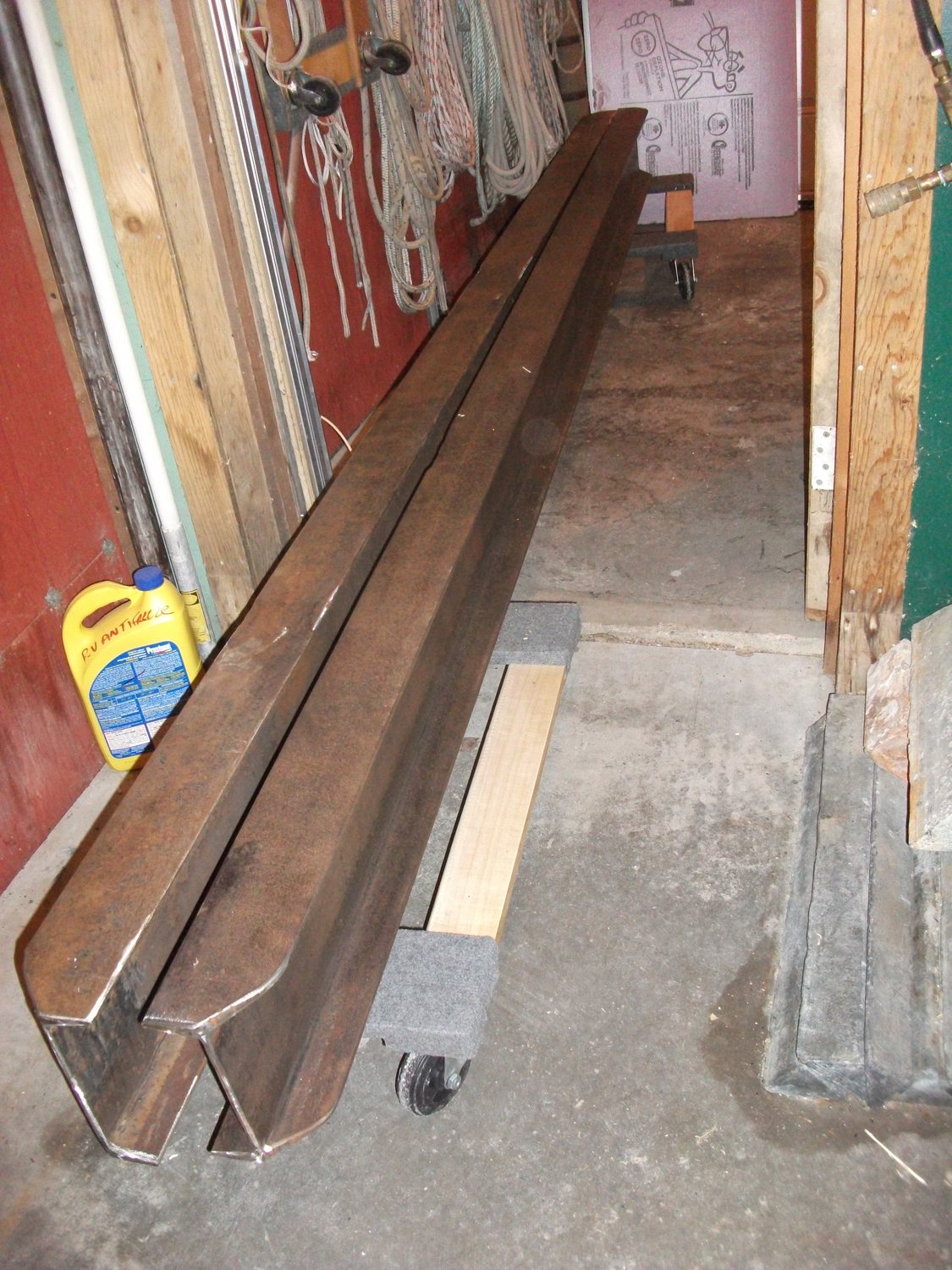

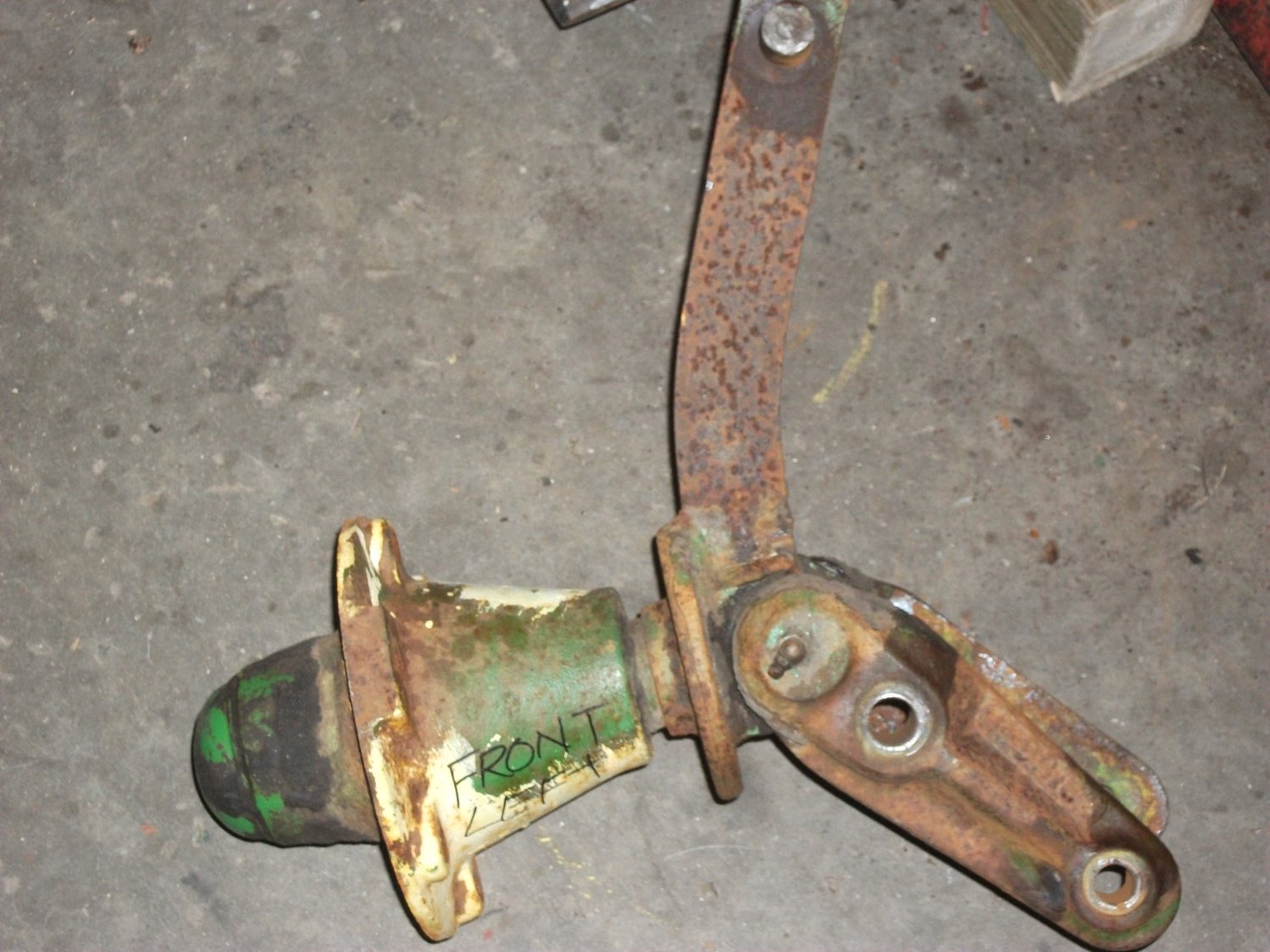

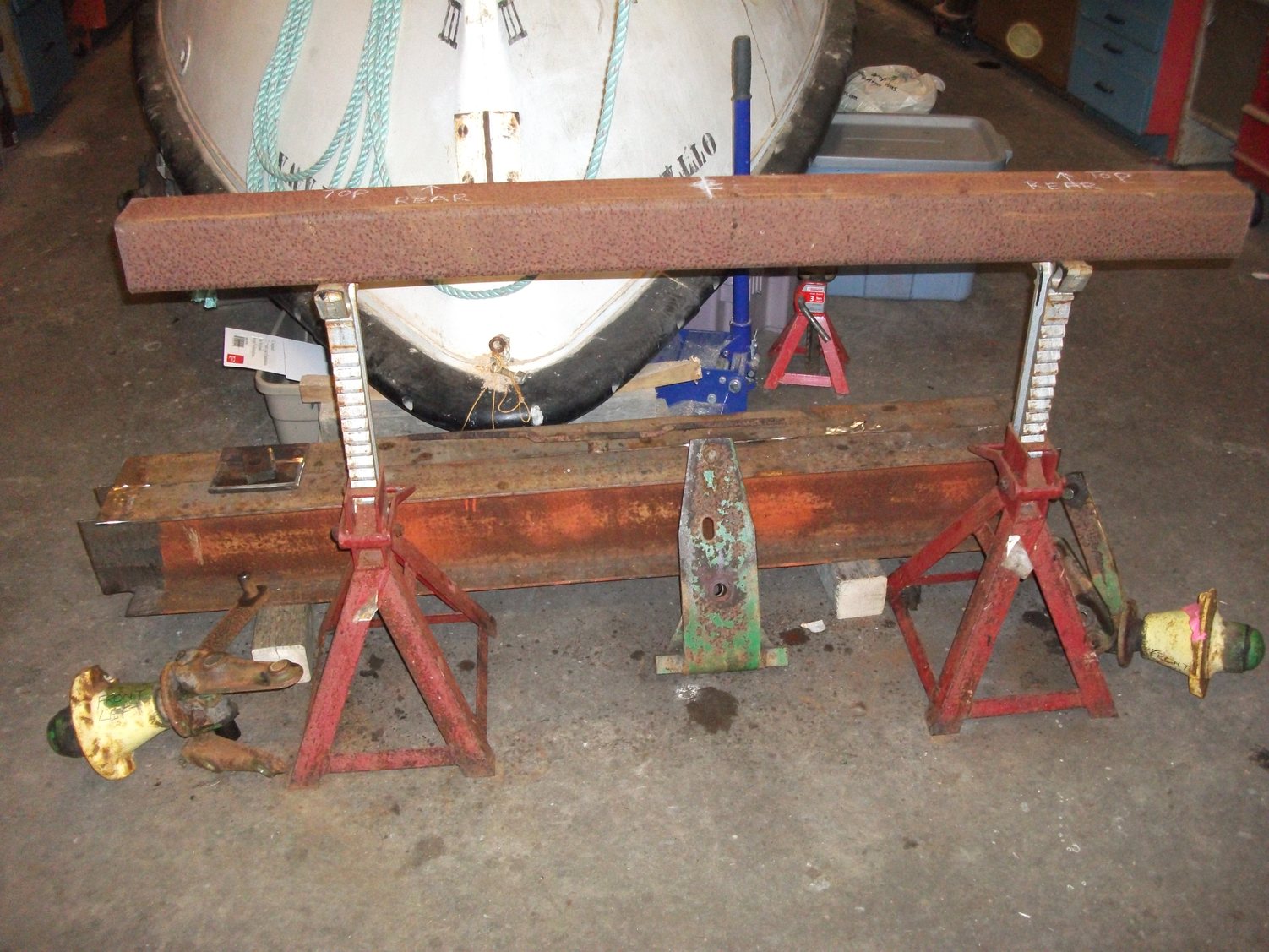

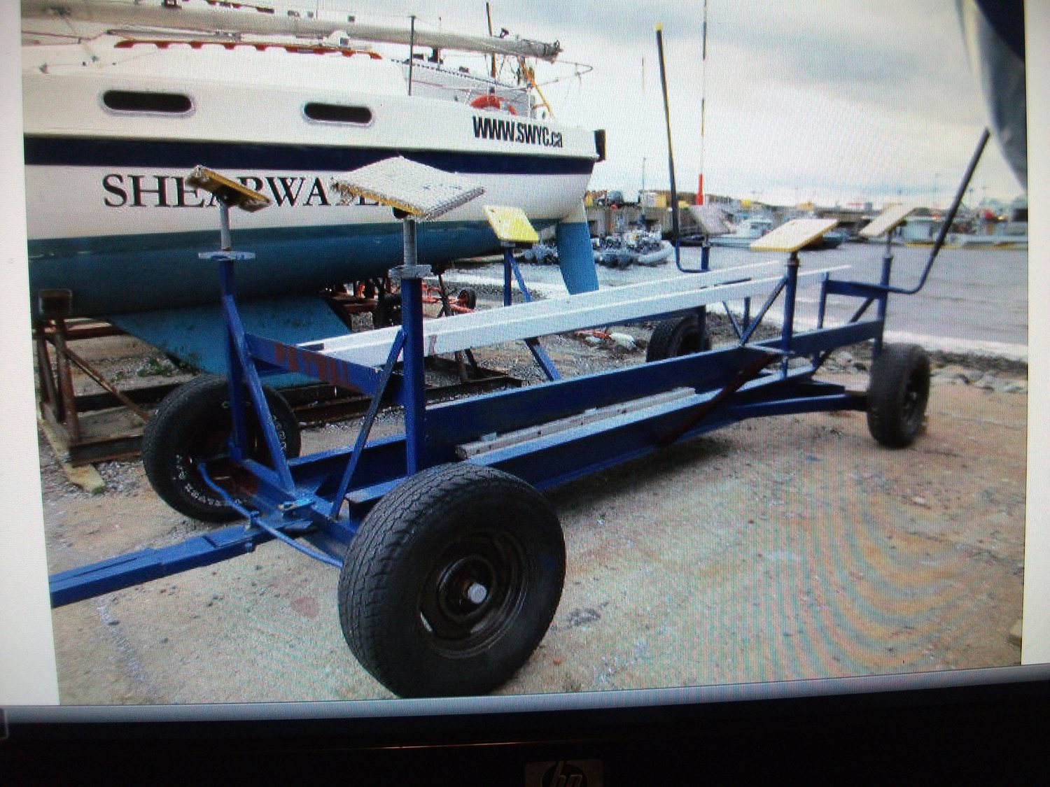

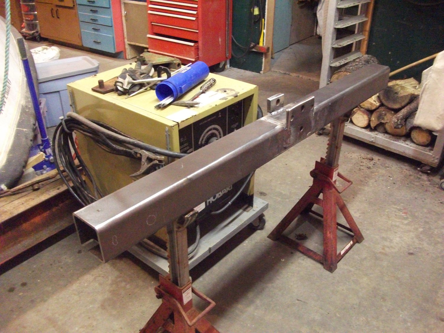

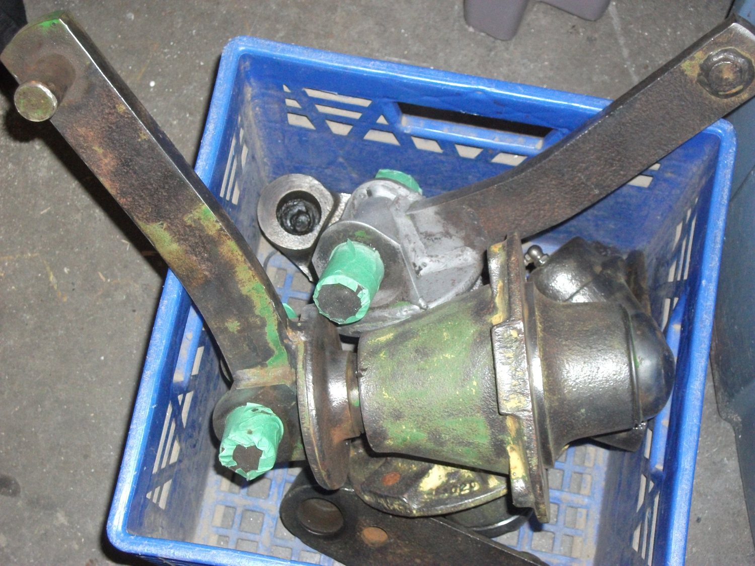

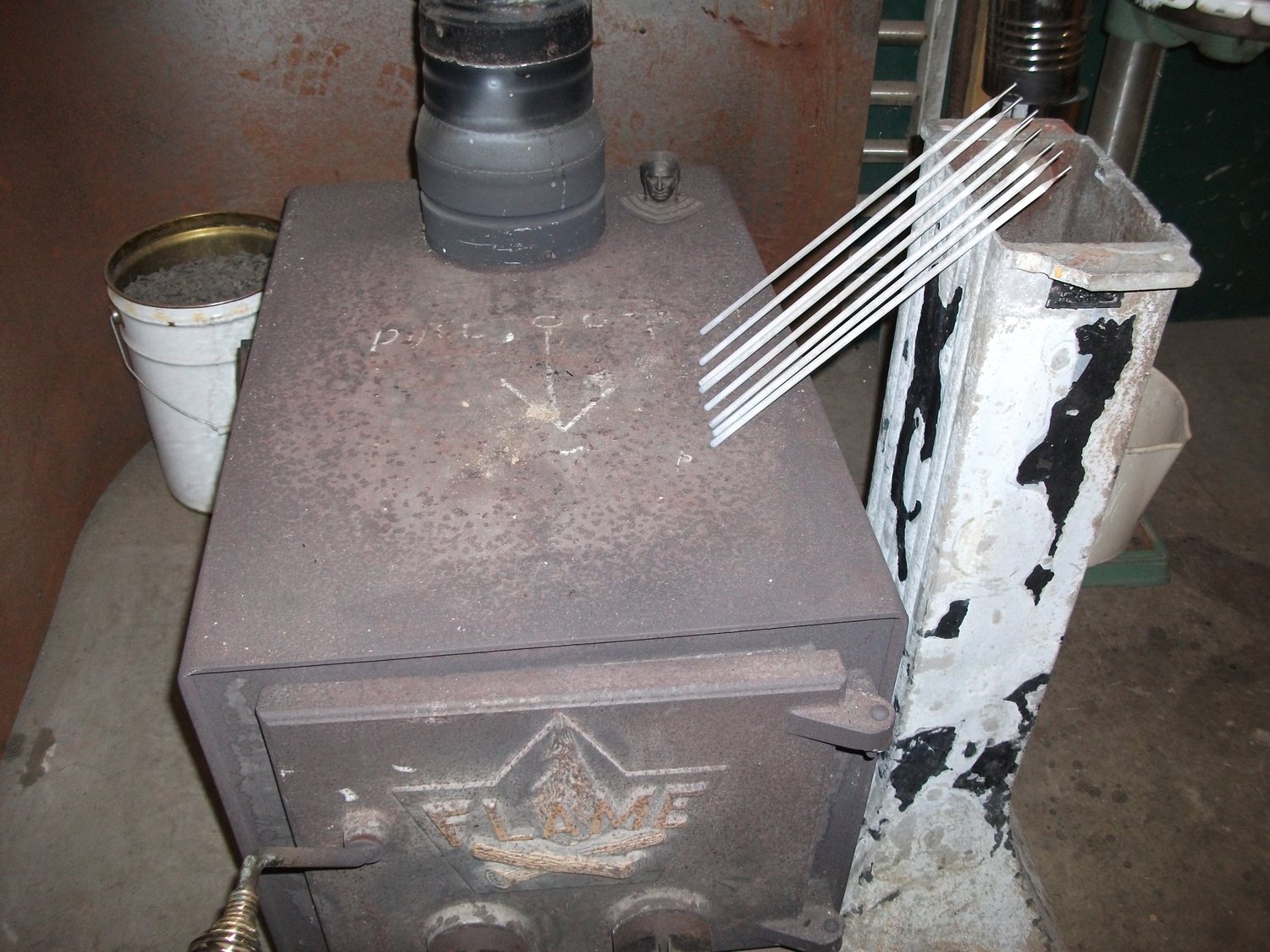

    Boat Cart
    Over this winter the weather has been very erratic from frost to rain and generally damp. Overall it felt too humid for glass work so i decided to take on another part of my boat build, the cradle. Modified farm carts make excellent boat launch and retrieval cart cradles. Basically the same set up as the early lifeboat stations used. If the water in the launch area happens to be too shallow simply attach a tow cable or rope and pull to deeper water. A kedge type anchor setup serves well for this. A cable or chain attached to the tow bar allows for retrieval. Compared to a typical boat trailer the 4 wheel cart setup is a more stable and maneuverable platform. It's one downfall is, it can be only towed short distances at slow speed. Certainly more in tune with back roads or secondary highways. I have included a photo of a typical steerable 4 wheel boat cradle of which mine will be of a slightly different construction. I have also included photos of the dismantled farm cart front end, a new longer front axle and the initial stages of the rebuild. Note,the 7018 rod oven. :) I will post as I progress for anyone interested in building a similar set up. Once the cradle cart is completed I will get back to work on the Nancy G.

    Nice cradle. Is their anything that should be done after launching or retrieving in salt water? Is it enough to wash it down? Is it better to use heavy axle grease or something that makes it easier to rinse?

    Jamie, I have made use of open not boxed steel where ever possible in the construction. I.E. I beam or channel. This allows for early detection and touch ups of corrosion. In addition i have cleaned the steel well, primed with heavy zinc industrial primer and will paint with top quality anti corrosion paint. The old school constructed 18ton John Deere farm cart is loaded with grease nipples of which I will add 4 more, one on each spindle bearing cap. I don't think it is necessary to wash it down after each salt water dip but if convenient why not do so. Based on other builds, I estimate that it should have a trouble free life of some 10 to15yrs. In other words my lifetime which is basically all that is required. :D

    Boat Cart
    Made good progress today, got the spindles cleaned and blasted, the main frame longitudinal and cross beams wire brush cleaned ready for zinc priming. I cut, wire brushed and zinc primed the intermediate cross framing last fall so other than the upright hull supports, once primed , the main frame is about ready to weld up. I am intentionally priming most of the steel area before welding because it will be welded outside the shop and i'm trying to control surface rust. Basically I have or will mark the steel where welding is to take place and these areas remain unprimed. After welding i will knock off the slag wire brush and prime. Once the cart is completed I will give it a couple of coats of high grade industrial anti rust paint.
