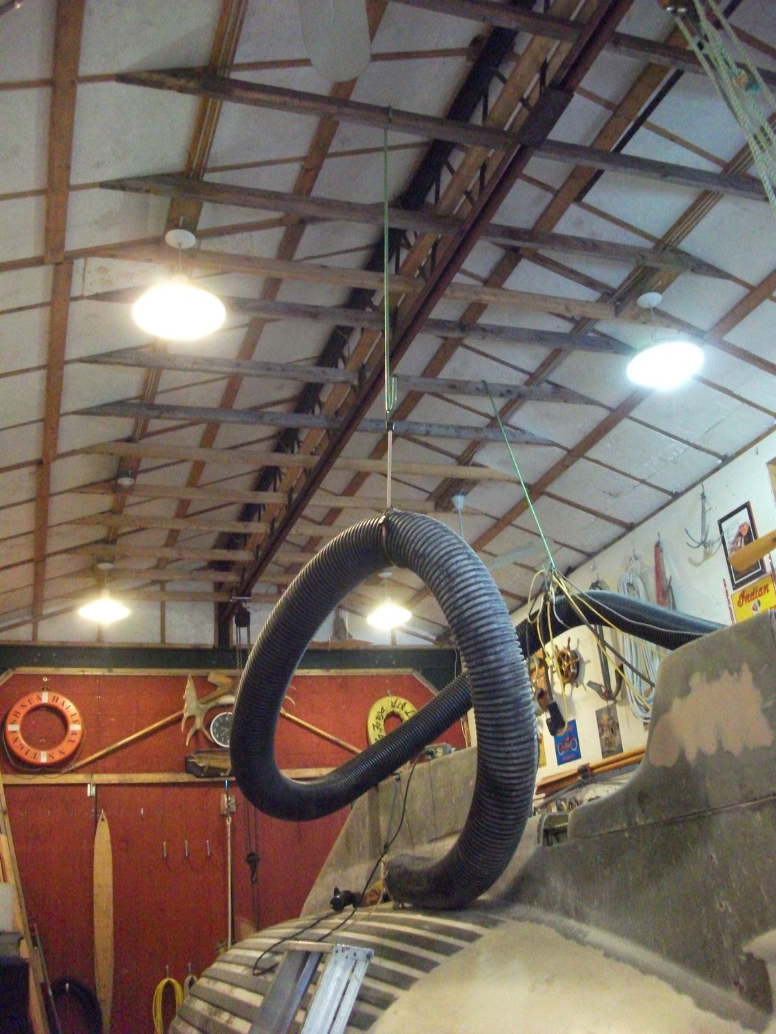

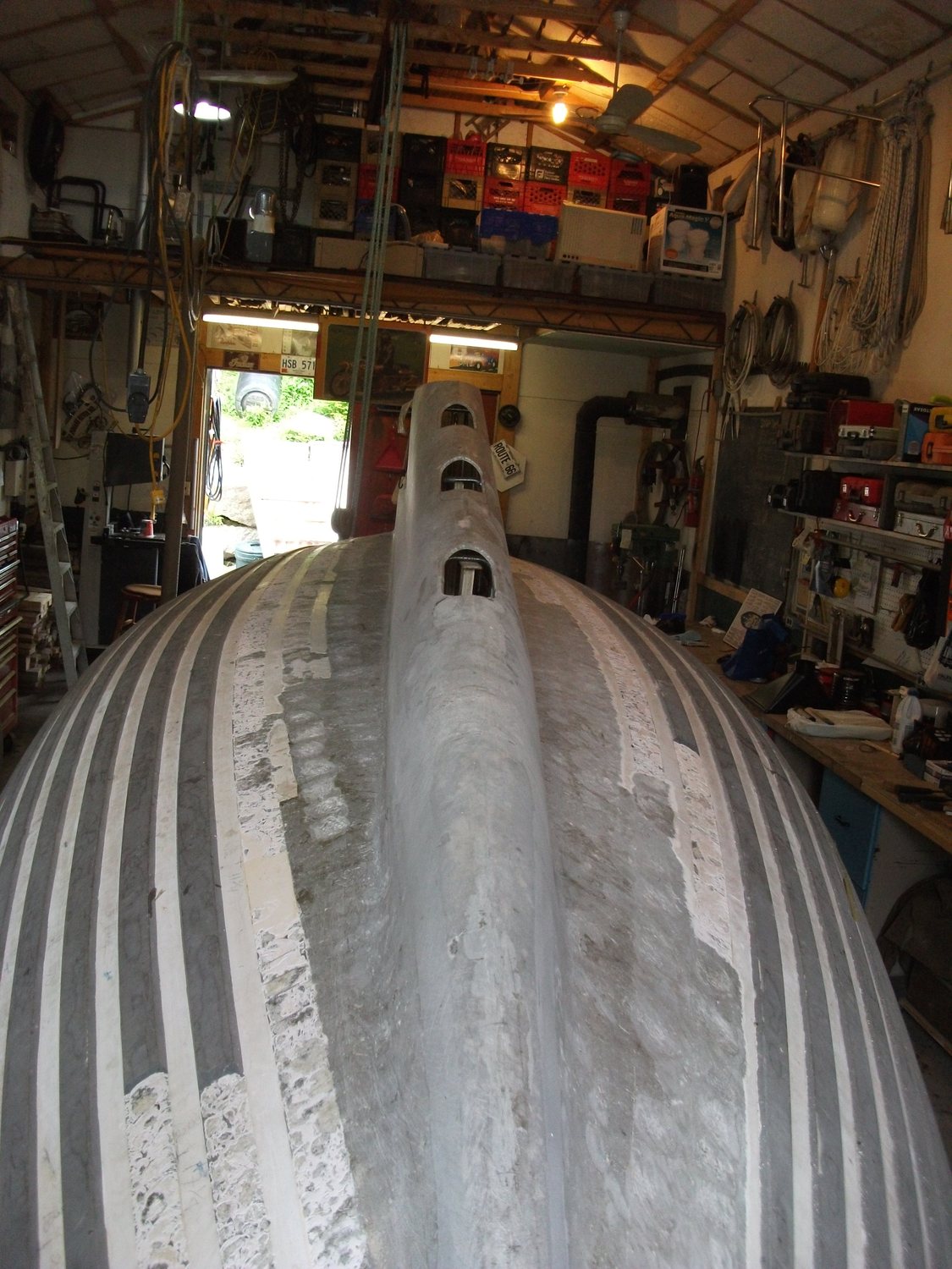

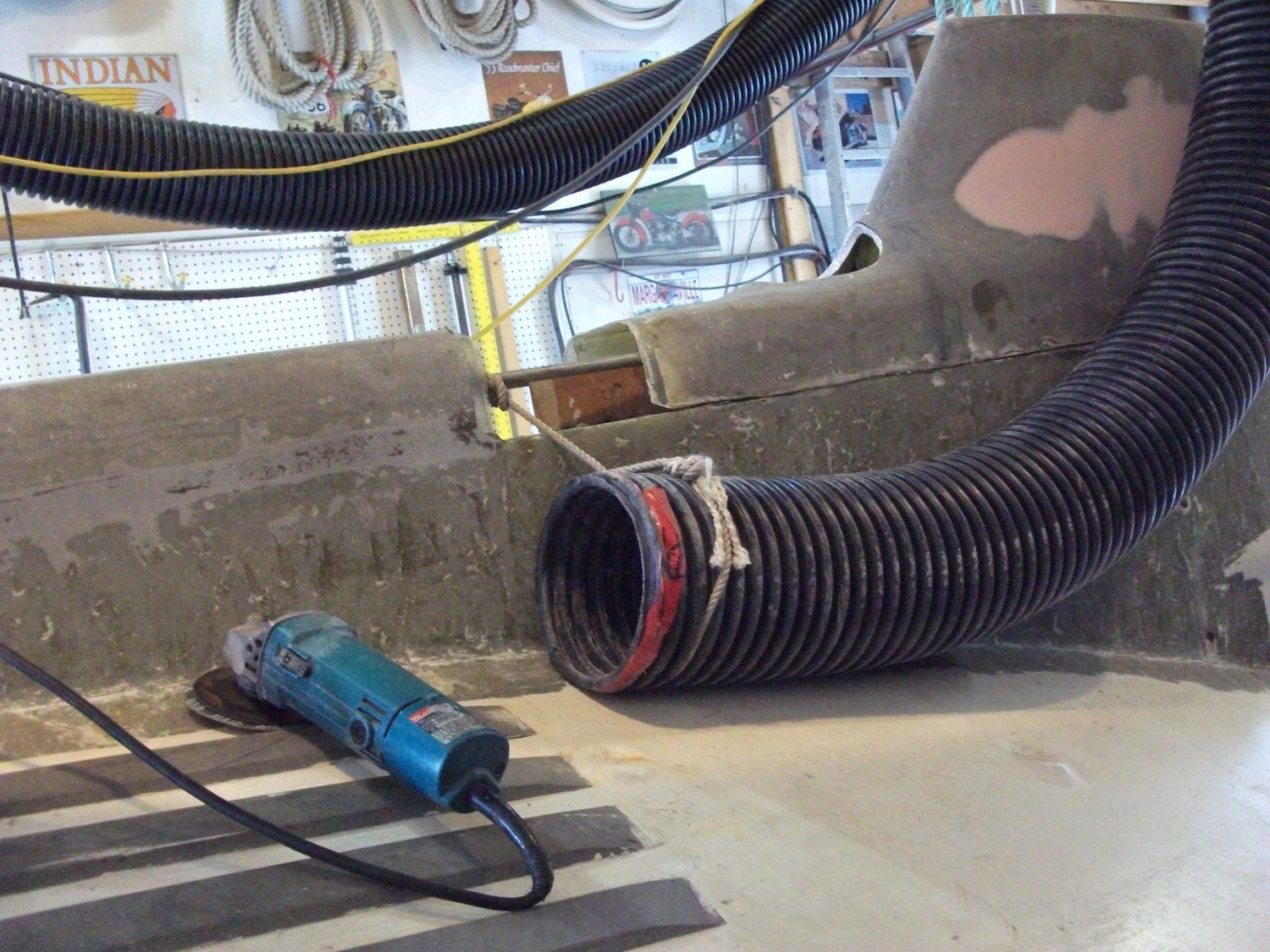

    Thank You Hoyt, the old guy is still kicking. :) Due to the crazy winter and really late spring I am about a month behind on just about everything not boat related. Work on the boat i'm about 2 yrs. behind. :D I've just about completed the prep. work to open the B&B for the season although the house repairs and upgrade after almost 30yrs. use will be ongoing. Boat work is continuing slowely but grinding and filling doesn't make for interesting photos or reading material. I,ve completed grinding out the damaged spots caused by the overly aggressive air chisel knocking off those rubbing strakes and will fill the small craters over the next week. Once these are filled and sanded level with the hull surface i'll finally be ready to glass the keel to the hull. I,ve decided to run the keel to hull glassing down and out onto the hull 6 in. or so allowing easier tapering and blending of the new GRP layers to the hulls surface. Another week or so the boat work should really start coming alive. It's a battle but as we all have experienced, Life's chores take priority. The photos show set up of the big 8 in. dust vacuum hose when grinding. --Photos Shortly

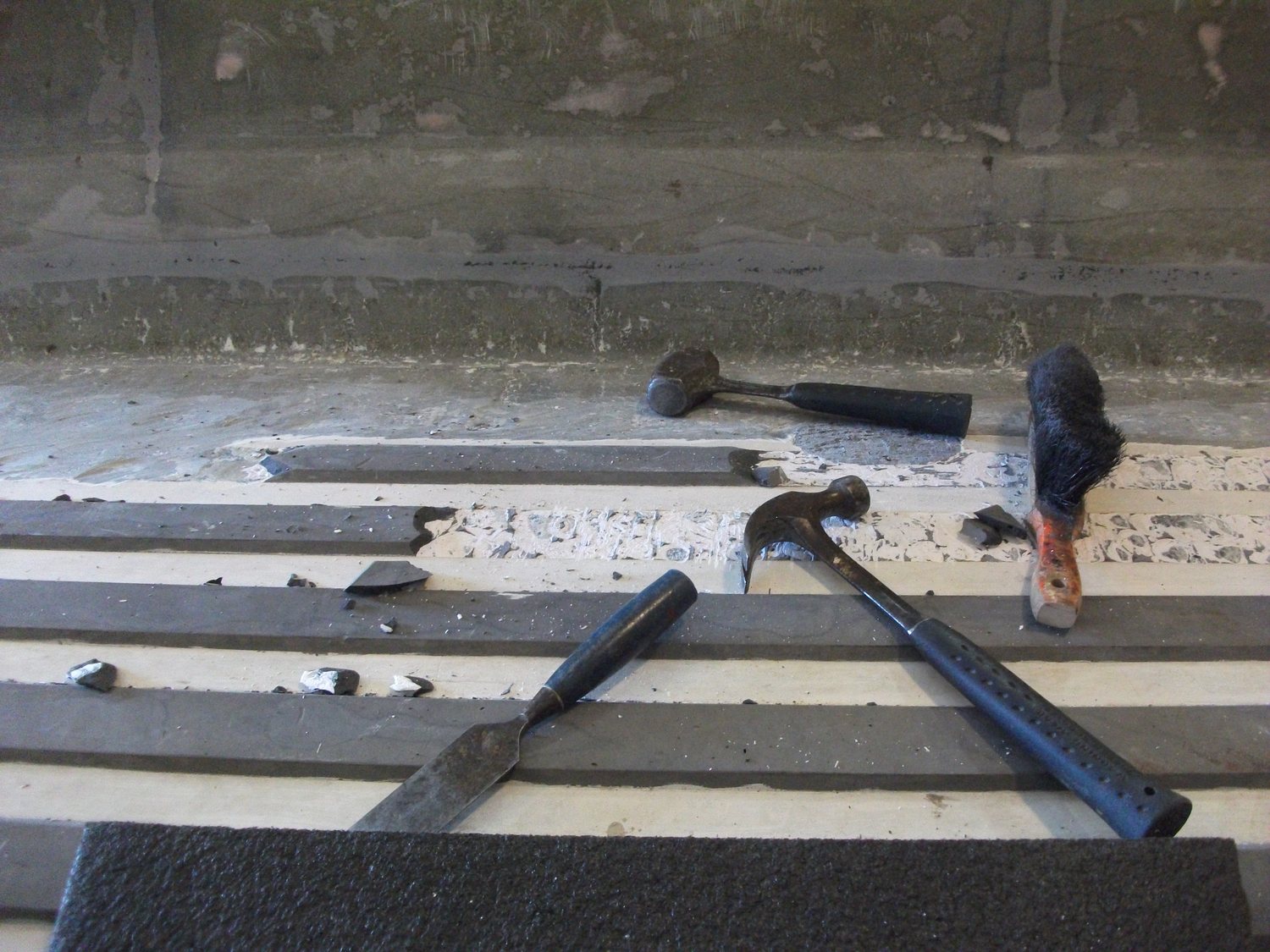

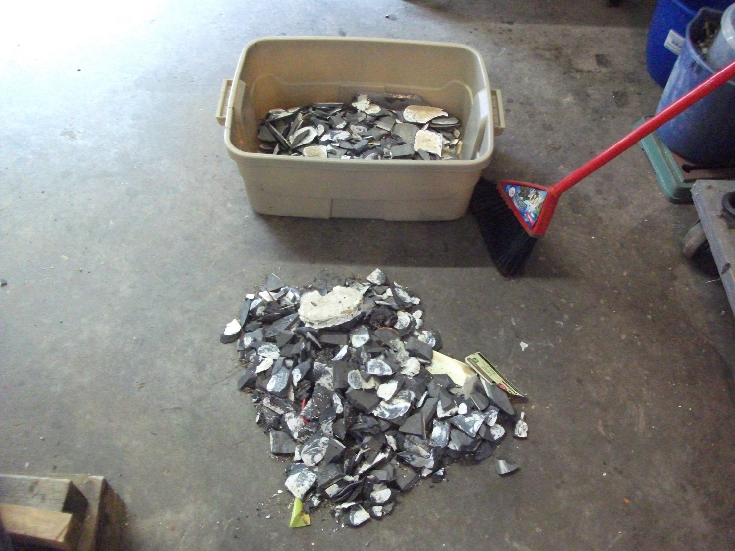

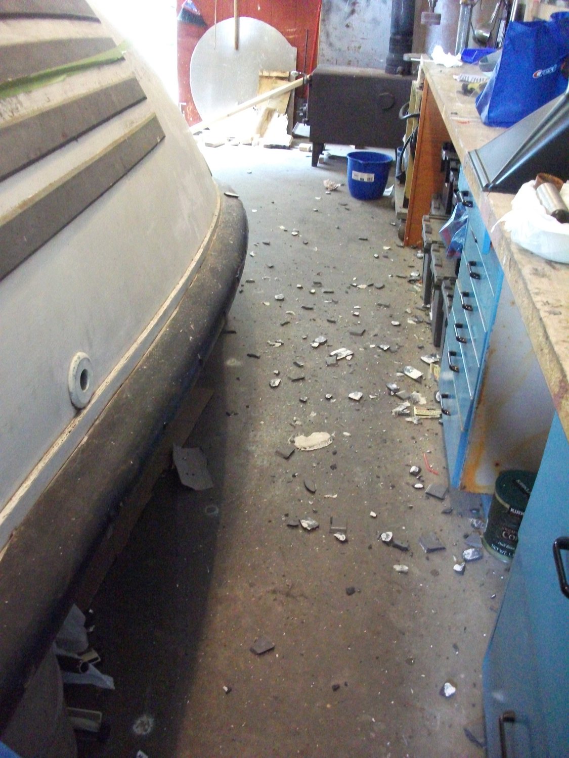

    Yesterday was a serious back to the boat build day. I decided to extend the keel to hull glassing bi axial cloth farther out onto the hull in order to cover 90% of the damaged areas caused by the overly aggressive air chisel attacking those hull rubbing strakes. This will allow me to simply use filler to level out the damaged cratered like areas and take advantage of the new layer of bi axial/matt to recapture the loss strength. Convenient since i have to use the bi axial on the keel to hull joint anyway. In preparation, I had to remove 4 more of those bonded rubbing strakes(2 runs each side of the keel.) It will also involve removing an additional 4 to 6 in. of gel coat back aft. on the turn of the hull to keel. The hammer wood chisel system while slower and more labour intensive at approx. 1 hr. per strake, does an excellent job with very little to no damage to the hulls FRP laminate. Overall it definitely will save work when time comes to remove all those strakes and attain a finish on the hull. This coming weeks work schedule is to peel off the mentioned gel coat, and do a rough power sanding in prep for filling and laying on the bi axial.
