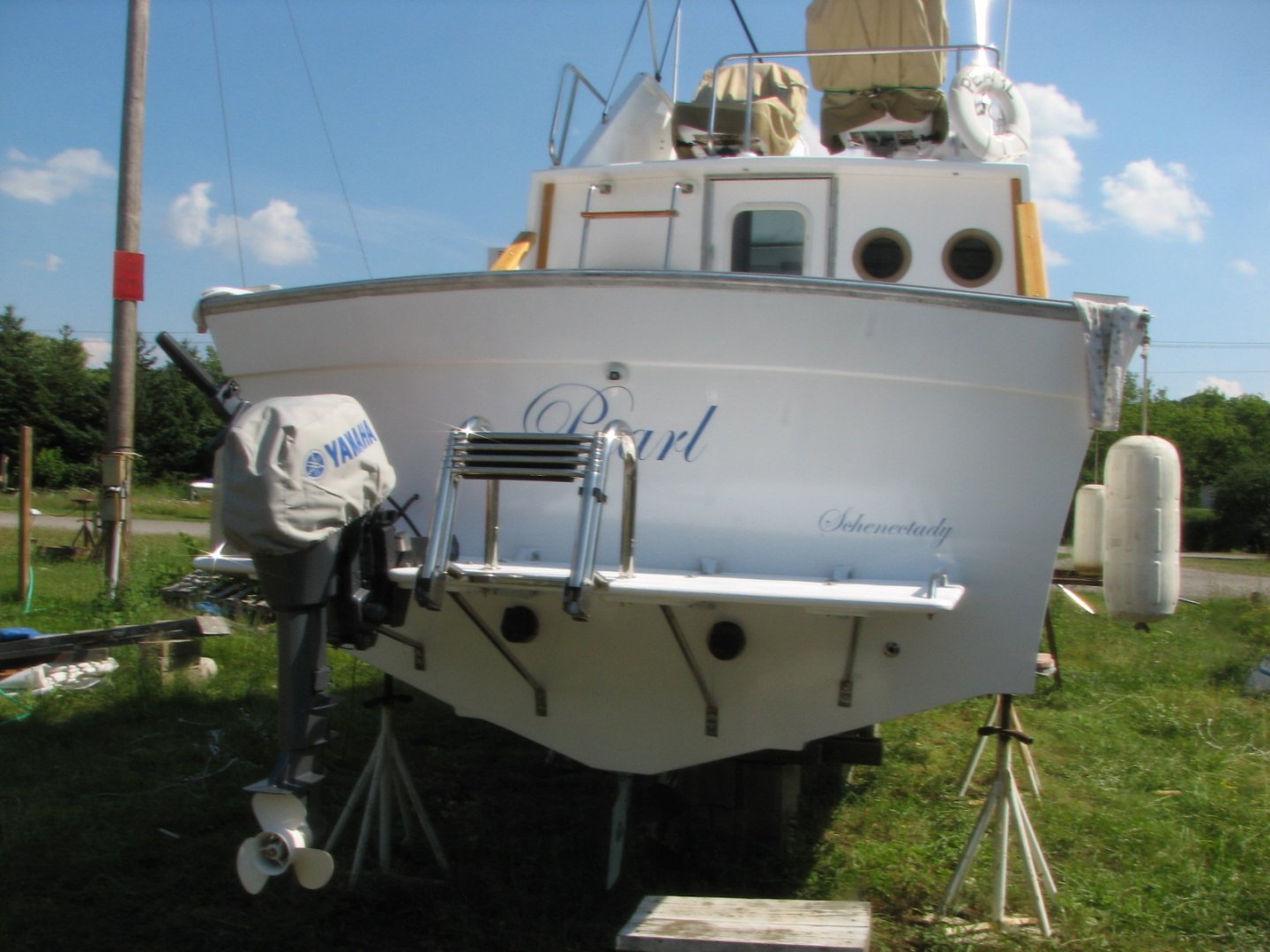

  5. missinginaction
    Joined: Aug 2007
    Posts: 1,007
    Likes: 201, Points: 63, Legacy Rep: 512
    Location: New York
    missinginaction Senior Member
    Thanks for the thought's, they're all good. As for the dead rise, I believe it's 20 degrees.
    A lot of comments are about her displacement and you're right to question that. I have her original builders certificate but that doesn't show displacement. I looked at the Bertram 25 and other mid 20's boats trying to get a handle on this. One of the reasons I restored her is that her hull is solid fiberglass and quite thick. 3/4 inch under the engine tapering to about 1/4" forward. I had her gutted as I started the rebuild and added additional batteries and water tankage. I knew enough to position the heavy items amidships so as not to make her bow or stern heavy. She sits right on her original lines. If I really load her up for a trip she settles an inch or two but that's expected.
    I love those Berties. But this old Silverton is a completely different boat. Where are you going to find a 25' dual station flybridge cruiser today?
    I don't need or want her to be a fast boat. I just want to get her propped right (or as close as I can). I'm planning on taking her to Florida in the fall of 2021. I'd like to be able to carry a little speed going into some inlets and maybe running from weather. Other than that I'm fine with an 8 knot yacht.
    I'll contact a prop shop (maybe that guy in Tom's River). The nice thing about having a small boat is that you can ship your prop UPS.
    Thanks again for all of the replies....when I get a new prop on her and can run some tests I'll post the results. That'll be awhile though. It's a little icy up here.

  8. missinginaction
    Joined: Aug 2007
    Posts: 1,007
    Location: New York
    Yellowjacket, all of my experience is on the Erie Canal and Lake Ontario. I've never had to deal with tidal flows so I'm a little wary of the sea states in some of those inlets. I agree with you based on what I've read.
    Thanks also to 7228sedan, I know how hard you worked on the Luhrs!
    Perhaps the best solution is trim tabs and a 4 bladed prop with the most E.A.R. that I can find. Hung Shen makes a 16" with 40% more developed blade area than I currently have and a 17" with 57% more. Even with the 17" my blade loading would be significantly above the allowable limit. But the allowable limit is calculated at full throttle.
    With a set of trim tabs perhaps I can get "over the hump" as you say with 80% power. Now I'm applying about 167 HP to the prop instead of 209 horse power. The developed area of the 4 bladed 17 inch diameter prop is 154 inches. Plugging these figures into the allowable blade loading formula, adjusting for the decreased efficiency due to 4 blades and the lower speed of water at the prop (wake factor) gets me to a prop loading of 9.6 PSI. At 80 % HP (167 SHP) allowable blade loading works out to 9.0 PSI. That would be about as close as I could get unless I can find a prop with a little more developed blade area.
    The 17" prop would only leave me with 2 inches of clearance between the prop tip and the bottom of the boat. But the 4 blades would tend to reduce any vibration. If the vibration turned out to be a real big issue, I've noticed that I could move the entire drive system aft a couple of inches. To get the geometry to work this would involve lowering the engine about 3/4" so that the shaft would line up with the coupling to the V-drive. A bit of work but doable. I installed and aligned the engine back in 2014 so I know how this works.
    Based on the math this may be the best I can do. Looks like it's time to break out another thousand or so.
    Thanks very much to everyone who's commented. I know I say this all the time but your comments get me thinking. That's what it's all about I guess.
    Cheers,
    MIA
