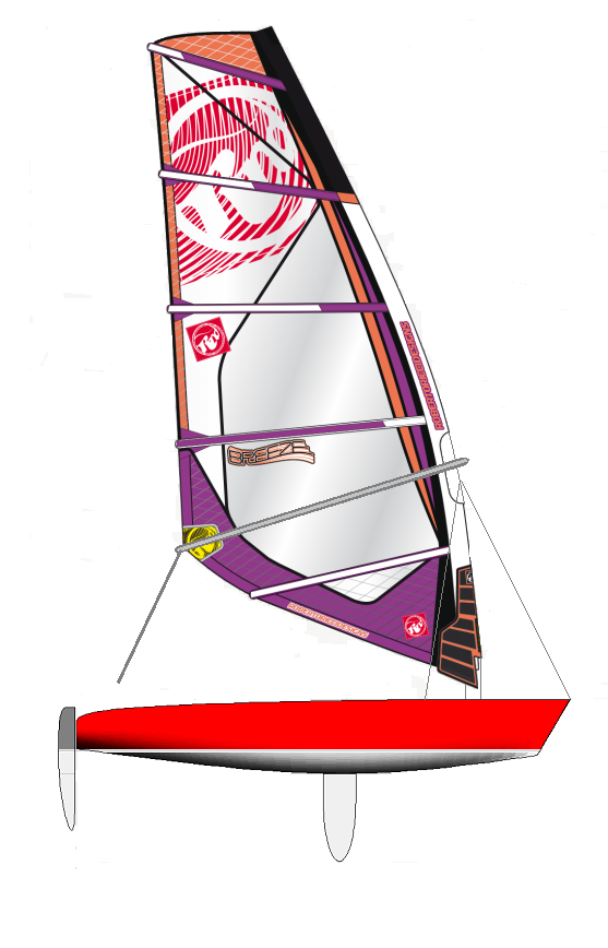

    ...sail

    Okay, maybe I'll go with 85cm or something. It seems that after these hull changes and boom height adjustments, my sail downgraded to 6m^2. Not much I can do about it.
    Thanks, but why are you even showing such a thing? This sail looks like that of a windsurfer. I bet it is laminate-made. With all the battens and shaped mast. Non reef-able, impossible to lower. My boat aims at the exact opposite.

    yes it is a windsurfer sail;
    are easy to find also used, of different sizes, and are very efficient

    Thank you, but it has nothing to do with my needs. Apart from what I told, it is expensive. I've seen them for sale (second-hand).
    I need a cheap, manageable and safe sail. With reefing, ease of taking up and down.
