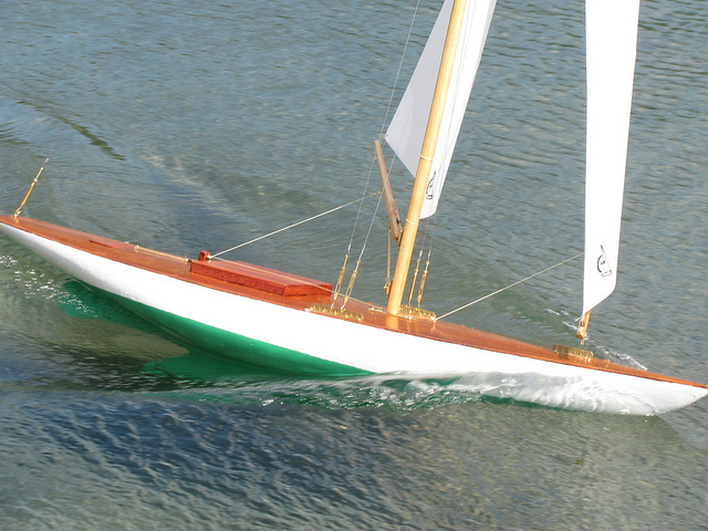

    Among radio yachts, the EC12 class (5 ft long, 6 ft mast, 24 lbs, full keel) is notorious for entering a "death roll" on the run, in which the boat starts oscillating with increasing period until it broaches. The EC12 hull is based on a tow tank model for a 12m.
    Here's a good picture of one right on the hairy edge. Note how the rudder is starting to ventilate.
    Cheers,
    Earl
