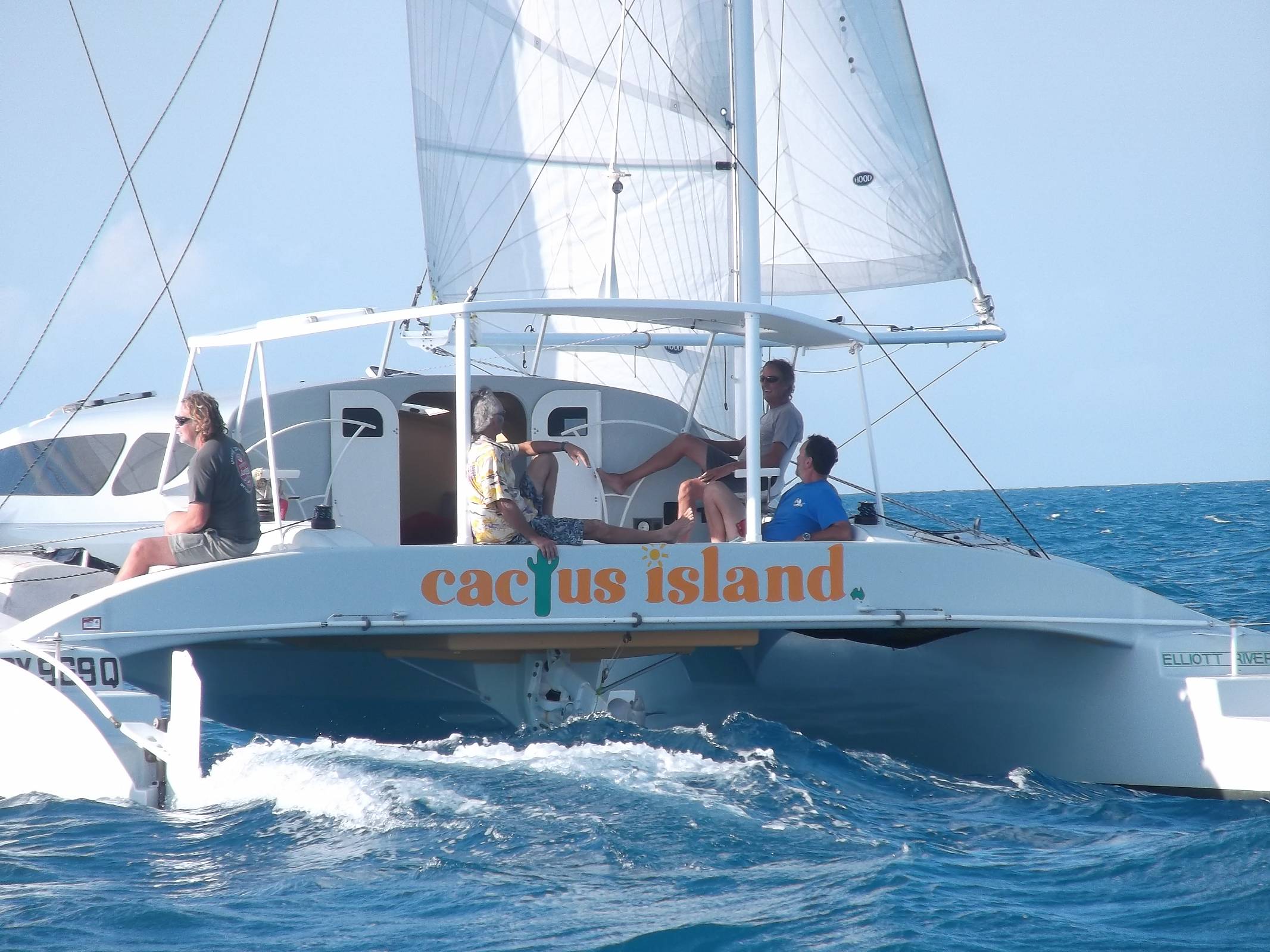

  9. he b gb
    Joined: Feb 2014
    Posts: 18
    Likes: 7, Points: 3, Legacy Rep: 10
    Location: ELLIOTT HEADS
    he b gb Junior Member
    Hi Wayne, I launched my twin balestron (aerorig) rigged cruising cat 4 years ago and couldn't be happier with my choice of rig. Rob is correct when he talks about the weather cocking ability of the rigs during squalls, a great attribute for any cruising cat (mainsails cannot be totally dumped on a normally rigged cat). Also Pogo is correct about the lower centre of effort. This is also a great feature of the biplane rig, no more of that "leeward bow down, windward rudder in the air attitude" that is common on most powered up cats. Cheers , Gerald.

    redreuben redreuben
    he b gb;
    So your Balestron booms are wishbones ?

  12. he b gb
    Joined: Feb 2014
    Posts: 18
    Yeah they're alloy tubes connected to the masts by spokes and then cold bent to make wishbones into fittings either end. They have guy wires from each end fitting down to the bottom of the masts to take the mainsail leech load and the jib luff loads.
