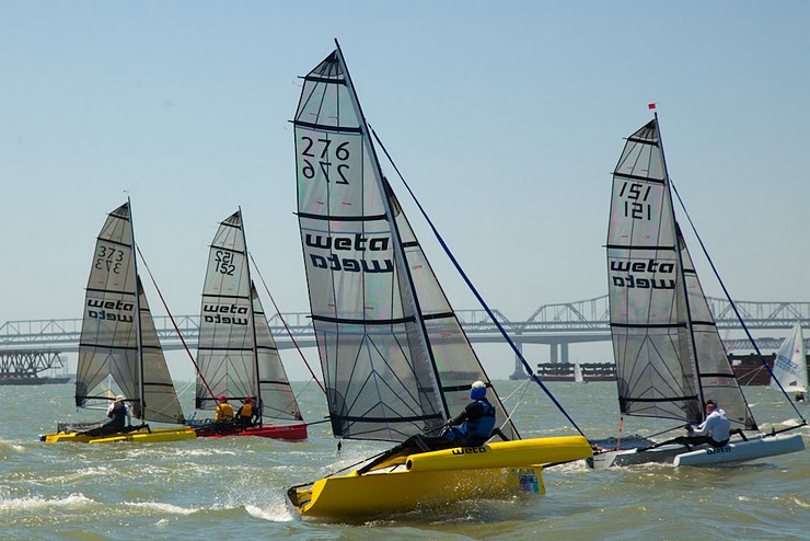

    Jay, Clissold also designed the Weta 14' trimaran:

    Ah.... :D . Okeys... yep. Of course I know Weta :) Great boat ! Not yet very present in Europe.

    Jay, Tim is a very approachable designer and is highly regarded in the NZ design circles with good access to computer modelling and where needed, knowledge of similar minded designers with specialist knowledge. Following on from design discussions between us, we had a crack at a 20ft Tri design.
    I had an idea that 20 ft Tris historically had been built with slender main hulls to conform to traditional multihull design and by consequence suffer badly when loaded with kit and passengers ( hull drag when the main hull submerges ), I also was aware that the 18ft Australian skiffs had got around this problem with fatter more rounded lower surfaces and that they sort of defy computer modelling. By simple trial and error with Berthwaite designs at the forefront, the skiffs have reached a point where weight of the crew is not so critical in light air racing confirmed by the way the 49ers I race against with my A Class and F16, seem to just sail off into the distance despite being about the same all up weight.
    Tim's Weta design went some way toward the direction I had sought, that of a Weta on steroids with a cabin and using computer modeling based around the underwater shapes of the 49ers and such like, we evolved the TC601 shape. It's certainly a fat bottomed skiff with a cabin and I have high hopes for it.
