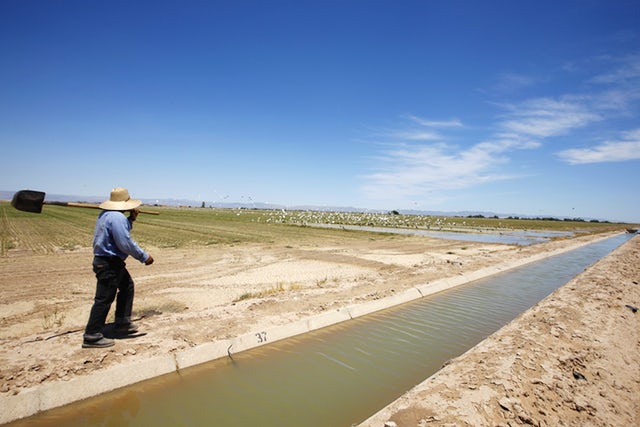

    I'd use an irrigation canal. We got them all over CA farm lands. Many are dead straight for a mile or more, and they come in all shapes and sizes from about 1 yard across to small river size.
    The water is quite calm when flowing, but often just sitting. The banks will be also nice and uniform. I've NEVER seen anyone playing in them even on the hottest days, so maybe its a big taboo but I've never heard about it. Maybe just lack of people and lack of interest. I've only noticed a few signs about "no swimming" but only at major road crossings with lots of foreign tourists on their way to Yosemite.

    Swimming in them is a major NO NO. Several drownings occur annually. The flow is far faster than it appears and the banks are very difficult to climb out. Check out Modesto Irrigation District's "Splasher the frog"

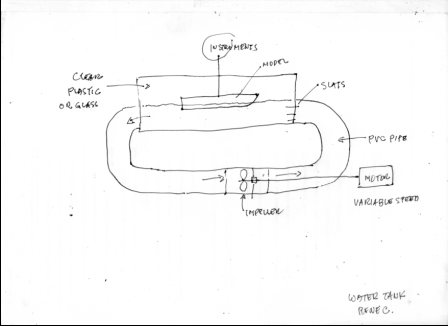

    The tank is diagrammed as attached. I suspect the impeller is a high volume/low velocity. It does not need a lot of speed. Speeding up the water would need a long neck to reduce eddies and turbulence.

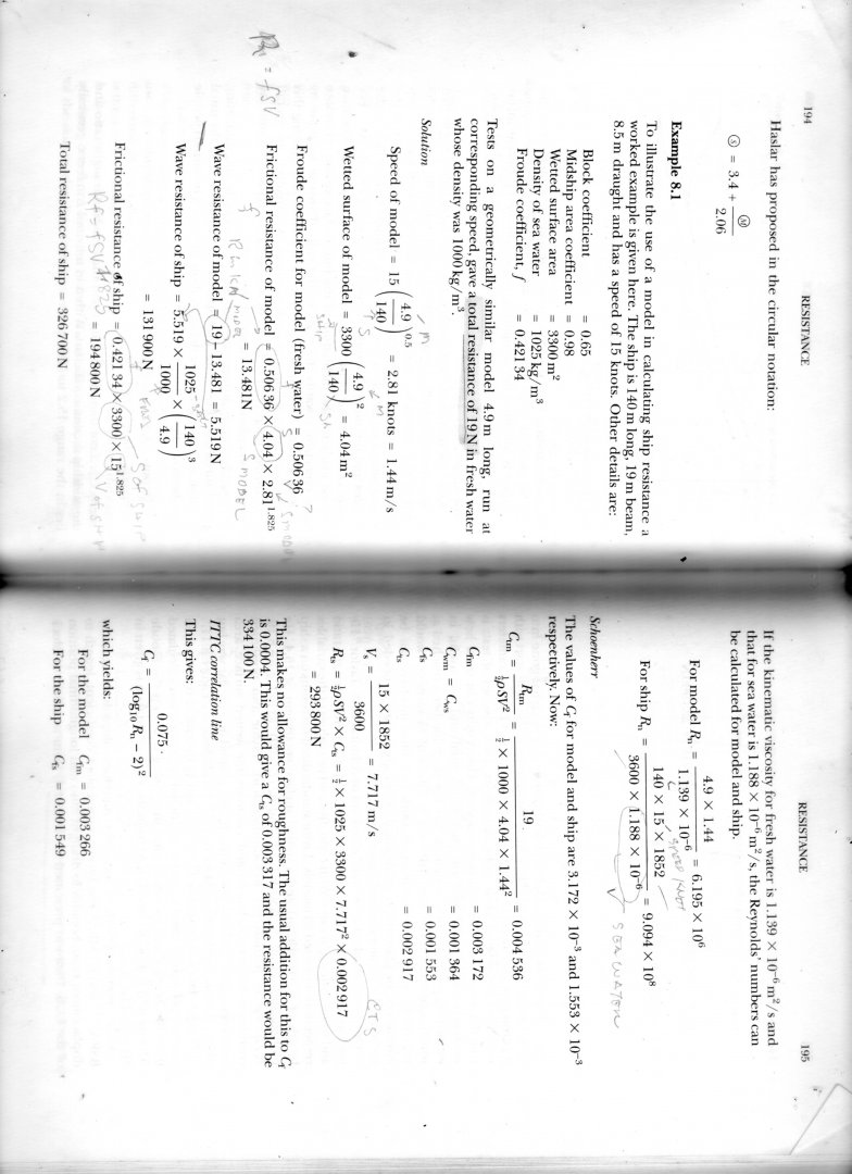

    Here is from my textbook. How to do the Test. From Eric Tupper Introduction to Naval Architecture. I believe Eric is from Westlawn.

    What Gonzo probably meant "Scaled Speed" meaning the model water speed is not the same as the full size version. You are correct in Froude number though as it is speed to length ratio. Another factor comes in. The Reynolds number when scaling up.

    The speed needs to be scaled by the square root of the model scale factor to keep the same Froude number.

    Froude Number Fn = U / Sqrt ( g * L)
    For same Froude number of two different size boats:
    U1 / Sqrt ( g * L1) = U2 / Sqrt ( g * L2)
    U1 / U2 = Sqrt (L1 / L2)
    U1 = U2 * Sqrt (L1 / L2)
    L1 / L2 is the scale factor.
    Reynolds number scale is different. For same Reynolds number speed needs to be inversely proportional to the scale factor.
