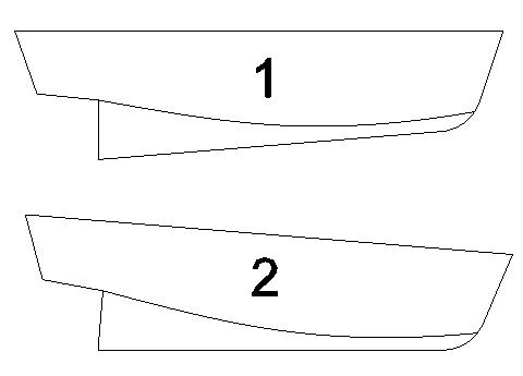

    How are you positioning the boat to measure, in the position 1 or 2?

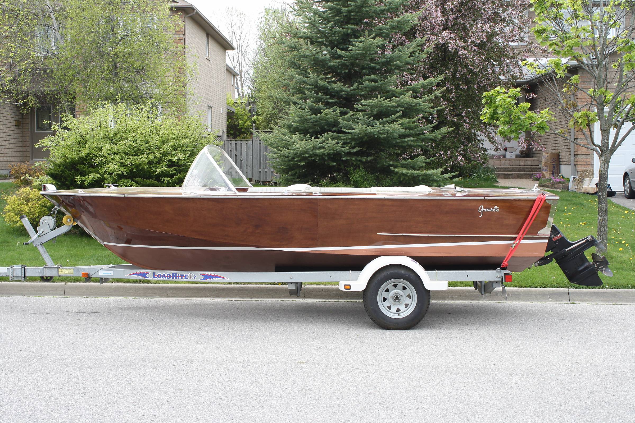

    This boat spent almost 5 years inverted while I restored her. She's all finished and I get her wet regularly. So, I can't see me pulling the engine/drive out and flipping her unless I absolutely have to.
    I'm not going to rush in here and will study this some more. I have a laser level so, it may be time to learn how to use it :)
    The issue now will be finding a suitable place to do this that I can have for at least a week. My garage is totally unsuitable.

    I think I'll take her off the trailer (use boat dollies) and level the keel with the floor. (So, #2, I suppose)
    However, it might be easier with position 1... Truly, I believe a good portion of the keel and deck are parallel... but, I suppose we'll find out if that is true :)

    #1 would be better than #2, but personally I would set the boat up with the floor level and let the other lines fall were they may.
    Disclaimer; I have not used my laser method to capture lines on a boat, I have however used a version of this method with great success to make a symmetrically opposite duplicate of the driver side of full size automotive clay model.

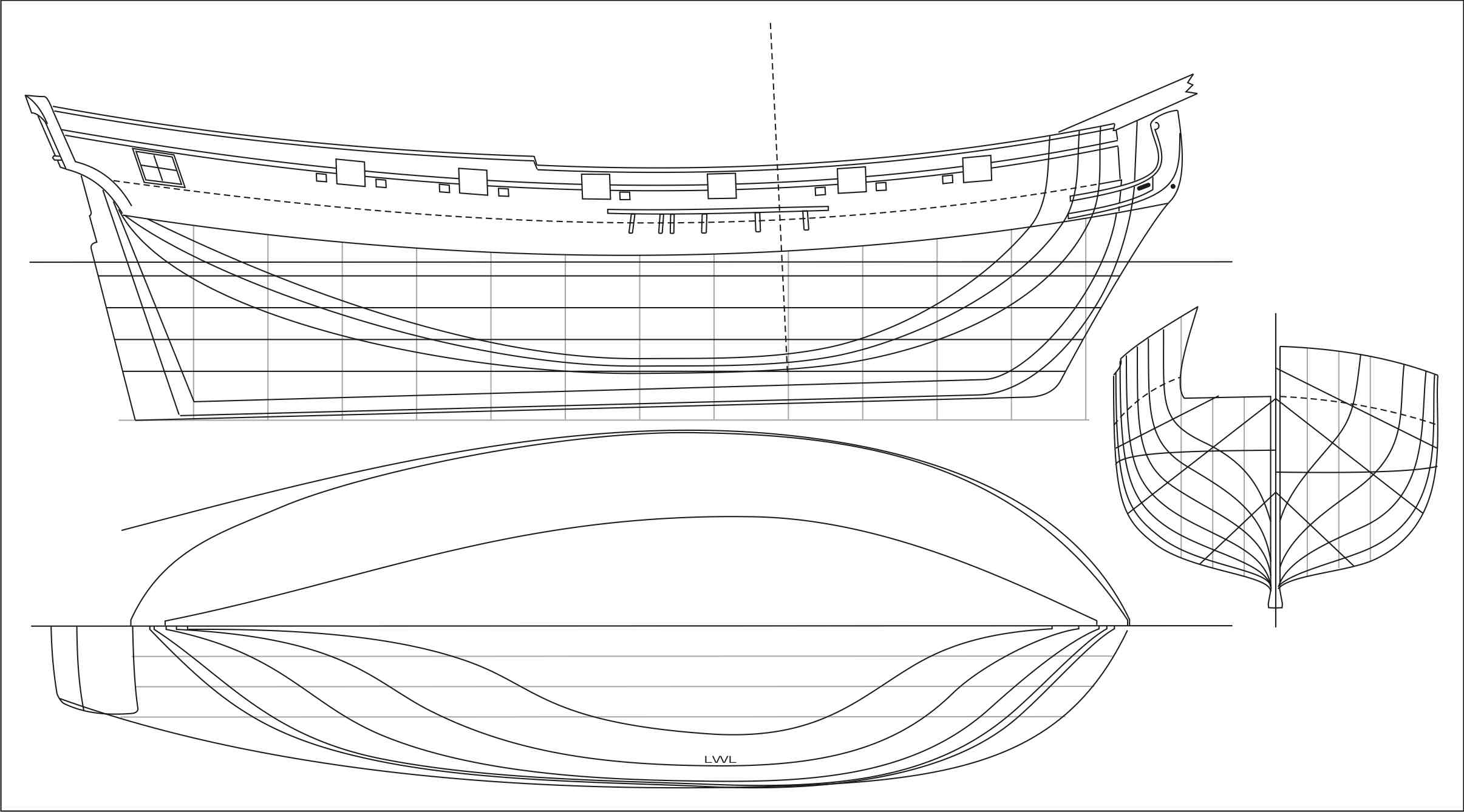

    Lines are setup for two basic purposes: the first to preserve the shapes so repairs or new builds can be accurately made and the second to have a representation of the hull shape. There may not seem a distinction, but there is.
    Simply put some lines are much less accommodating to a new builder and essentially is a pretty picture. While other approaches to lines drawings make understanding what's going on with volume distribution and hull shapes easy to comprehend.
    Typically the profile drawing shows a common base line, which is paralleling the LWL. This represents the actual shapes, as the boat appears on the water, but can be difficult to read in the sectional drawing, as some of the lines may merge so much as to become muddy. In days of old, the base line was often following the "drag" of the keel, which greatly helps show the shapes in the sectionals, making it easier to loft them up full size.
    The 18th century sloop clearly shows the base line paralleling the LWL approach and the easily seen sectional shapes. None of the lines are merging enough to muddy up where they're going, so it's easy to pull offsets and templates.
    The Sultana drawing by Chapelle shows the baseline paralleling the keel's drag. Some of the sectional shapes are hard to define with this approach and because the sections are canted to reality, in regard to how the boat actually floats, difficult to tell what's really going on with these shapes, in terms of volume distribution.
    In powerboats this muddiness can become a real problem with a lines drawing, where the aft sections become so convoluted, you can't see much, without busting out separate sectional offsets and drawing each one separately.
    So, it's like I mentioned and the drawing depends on what you want these lines to do. If you want them to use comparatively, with other hulls of similar shape, select a baseline that parallels the LWL. You might get some muddiness on some hull shapes, but the shapes depicted will be representative of the boat in the water. If on the other hand, you just want a picture, on this particular hull, you might want to cant the baseline a bit so the sectional shapes are more defined visually.

    Now, look at the shape of the boat... I think it will be easiest to level the keel. I can probably sit it on blocks and be very close. Also, it is closest to the floor and easiest to measure. If I try level at the sheer I have to check 2 sides every time I adjust.
    Once set, all measurements will be relative to this position. Right?

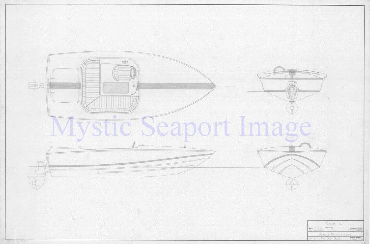

    Since I'm not actually building a copy of this boat, I don't really need to analyze volume distribution. I'm no Engineer, Designer or Naval Architect so, I wouldn't dare try to produce plans to build from. Given that, I'm looking for a representation of the hull shape. As no drawings of any type are known to exist for this boat; this drawing will serve to record for posterity. Not that I wouldn't want plans you could build from.... I just don't think they are attainable with my resources.
    In the end, I'd like to produce drawings similar to those of the Donzi 16 (by W. Walters) below.

    Now that we know what you want, you will allow me to make a recommendation: you observe the plane left of the two figures attached to your post. You can easily check for cross sections of the hull which, who knows why, are perpendicular to the waterline. As the water line use to be horizontal, you should put your boat so that its frames, or bulkheads, were perpendicular to a horizontal line which, as some have previously advised you, is the first thing you should materialize .
    Level the boat transversely as well and, to measure!
