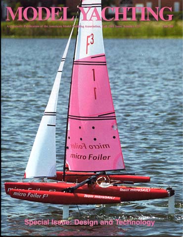

    Corley, when I designed and built the F3 below I used a 9% section on the daggerboards and a 9% section tapering to a 12% section on the lifting foils.
    The boat was 59" LOA by 72" wide and was very, very fast. By the way the F3 was just a two channel boat-foils 100% automatic.
    Check out this RC multihulls thread on SA: http://forums.sailinganarchy.com/index.php?showtopic=82807

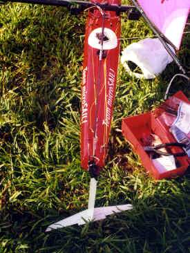

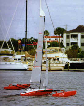

    Flyer 3-2m tri
    Here is a 2M RC tri I designed and built:
    Pictures: L to R - 1) Sailing in Melbourne,FL., 2) On the dock at FIT in Melbourne, boats 1 & 2. If you click on the photo and look in the upper left hand corner you'll see Dr. Bradfield standing there wearing a white hat. It will give you an idea of how really big these boats were., 3) Bradfield bought #2(white on the dock) and added hydrofoils to it as a test for his 40' SKAT design--
    PS- these boats were designed with a working screecher that set doused and gybed under radio control. Had lots of trouble with the system at this photo shoot and Bradfield didn't want it because he said he could go a lot faster putting the weight into much simpler hydrofoils!
