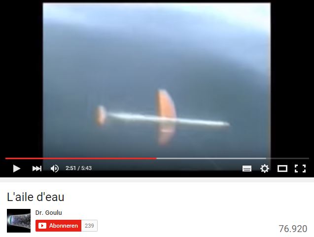

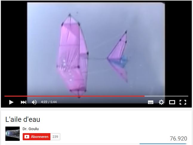

  10. schakel
    Joined: Jul 2008
    Posts: 366
    Likes: 12, Points: 18, Legacy Rep: 48
    Location: the netherlands
    schakel environmental project Msc
    That's it. It proves the idea works!
    Thanks a lot!
    https://www.youtube.com/watch?v=1tEw_mlUh7g&feature=related
    40 KGforce on the kite line.
    This is the kite they used.
    Nothing is said about the velocity but you can hear the high pitch of the outboard motor of the RIB trying to catch up with the sub.
