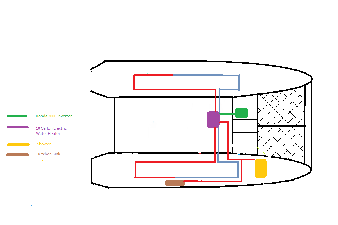

  7. saltifinch
    Joined: Mar 2016
    Posts: 45
    Location: British Columbia
    saltifinch Junior Member
    Thought I might make a small drawing of how I could see this heating system work with a generator. Hopefully its self-explanatory.
    Honda Inverter ( 2000 watts max ) ( Runs 3.5 hours on 1 gallon at 1600 watts, 59dba)
    10 gallon electric water tank, 1500 watt power supply.
    Manifold produces separate water supply for sub-floor heating, and shower/sink.
    Generator runs outside, provides direct power to water heater, which is located in salon.
    The idea behind this system being that you can anchor for the evening, run the generator, heat the boat, have showers and cooking as needed. Generator can also have a separate link to power grid to charge batteries as necessary.
    Any problems/suggestions?

  9. Richard Woods
    Joined: Jun 2006
    Posts: 2,208
    Richard Woods Woods Designs
    The simplest hot water system would be something like this
    http://www.amazon.com/Coleman-Portable-Water-Heater/dp/B00EHKPJMI
    Major manufacturers like Rinnai do not give a warranty for their propane units if used on boats. another major reason boatbuilders don't fit them. Of course you buy a portable one on ebay from China.
    Plumbing/heating and services take up a lot of space and you have to hide it all. So you need to think about it in advance, but I think you are still a long way from those details?

  10. Spiv
    Joined: Jun 2007
    Posts: 221
    Likes: 16, Points: 28, Legacy Rep: 207
    Location: The Big Wide Blue Brother
    Spiv Ancient Mariner
    In my mind, floor heating is the most beautiful, cosy way to heat living areas. :cool::cool:
    I would live with the additional cost/weight/complexity in order to enjoy warm floors.
    Yes, it would take longer to heat, but it'd stays warm longer as well.
    I do not see the gen-set that has to be on for hours, as an option for the noise (both on your boat and the other cruisers at anchor).
    Small diesel heaters are used extensively on trucks, RV and boats in N.EU and N.America and are extremely efficient.
    The hydronic (water) option is normally used to feed radiators, but I often wandered how a small underfloor piping system could be made to work properly.
    I wandered about the possibility to, also, collect heat from all on board combustion engines, exhausts etc. so as not to waste any heat to the outside.
    A larger than normal hot water tank, even the use of a heating fluid heat-exchanger ( :confused::confused: ), could be used.
    I thought these floor heaters could be constructed sawing small plastic tubes under carpets, emptied, rolled and stored away in the summer.
    Any ideas on how to build this and if it would work?
  11. saltifinch
    Joined: Mar 2016
    Posts: 45
    Perhaps a diesel heater may be more efficient. The trucks I work with use them to heat water, and they are extremely fast. And perhaps they're quieter as well.
    But as I mentioned, the Honda is only 59dba at 1600 rpm, about as loud as a dishwasher. And I intend to keep it inside a compartment, further reducing the noise.
    One way or another, fuel is going to get burned. The objective is not to be as cost effective as possible. Rather, I'm looking at creating an effective, safe, professional heating system. This heating system will be run 90% of the time on shore power, since it's an electric heater. The generator is simply to give it limited portable use while I'm not at a mooring slip.
    If I use a diesel heater, than all it can ever do is produce heat. But if I use a generator and electric water heater, than I can produce heat and electricity in every possible scenario.
    The other nice thing about this setup is that its completely out of sight. No wall heaters, no fans. Just turn on the switch, and feel the heat. In 30 minutes haha. These systems are designed to actually be left on all the time, otherwise they are inefficient and use much more power.
    The hoses through which the hot water runs is made of polyethylene, designed to last for decades. Considering you have hot water running through your boat, its not really a system you want to be rolling up every season, potentially degrading or damaging the hoses. These hoses are low pressure low heat and should never leaked. I've worked with high pressure hoses using boiling water, and if you bend them enough, or let pressure build up, that's when damage happens.
    The point is, they stay there all their life. You inlay them into a structure of either foam or plastic over top of a solid floor that won't flex, then over top of the hose/foam structure, you lay another floor. In houses this is often concrete. That should tell you how long the hoses will last. I would personally use some sort of vinyl interlocking flooring system. They're strong, easy to install, and easy to take apart.
    As Richard mentioned, any heating system takes up space and can become complicated. That's why as I was drawing this up, I was trying to envision where all this piping/wiring would go. A drawing is just a drawing, not a design.
