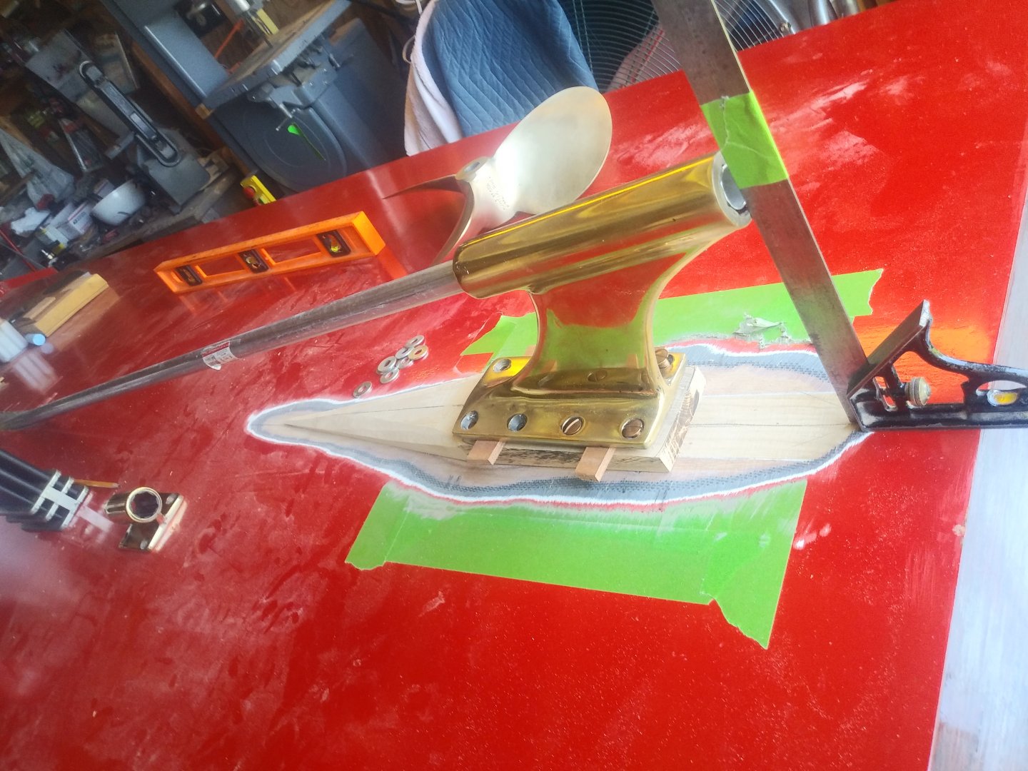

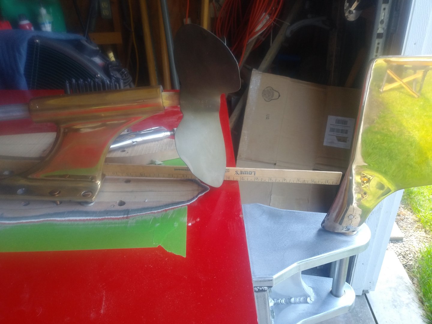

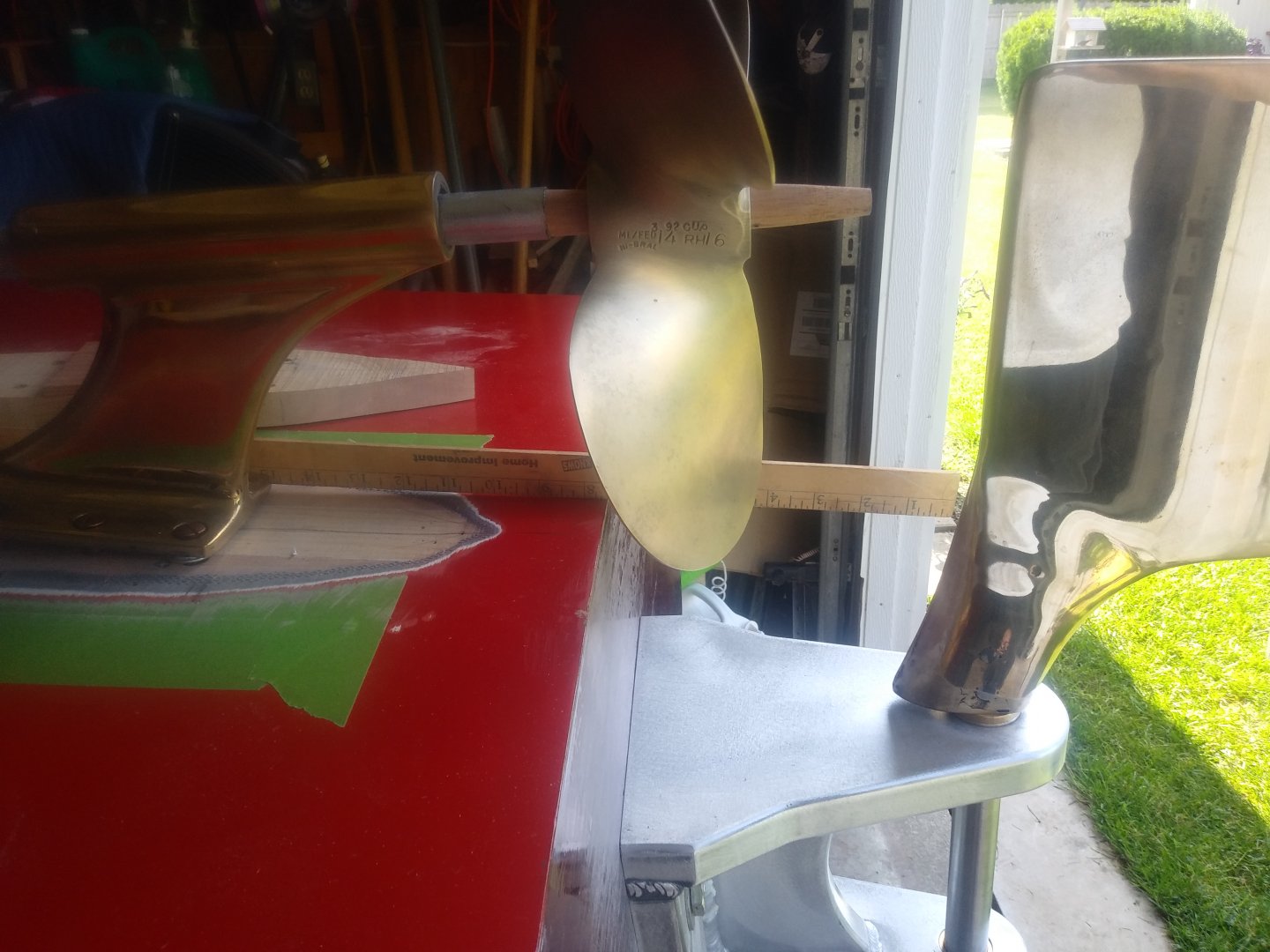

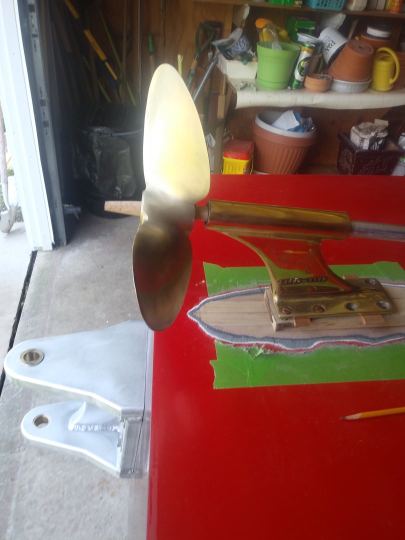

    I'm going to try to post two photos. Second photo is what I had originally planed using a 14 inch prop. The first photo is showing the changes I'm in the middle of making to use the 12 inch prop. Note things are just cobbled together to get an approximate idea of what they would look like. I just used a dowel to support the props in these photos.
    Spent some time today looking at this mess I'm in and found myself unable to even remember how to do basic Trig. The mind just goes blank. If I use the 12 inch prop, I'll need to have 7.2 inches of height on the strut or if I use the 14 inch prop I'll need 8.4 inches. Where I'm running into a problem is with the 9 degree angle of the strut. With the 10 foot long shaft and a need to have an equal height dimension off the internal keel for the transmission flange of close to 7.5 inches or more is OK. I am looking at making a white Oak spacer to be placed under the strut. With the spacer I can correct the strut angle to the lesser angle needed at the same time get the correct heights needed. Does any of this make sense? Another part of the consideration is the hole thru the hull is placed approximately 60 inches from the strut. I just cut a slot hole in the bottom and plan to epoxy in a 1.25" carbon fiber tube spaced around the 1" shaft. Any thoughts or positive critiques are welcome. I just got to get it done and work right of course.
    Sunday 7-9-23 Made the white Oak shim for under the strut and found I still needed to add 1/4 " wood spacers to get to 7.2 " height off bottom. Started thinking of using this setup and then adding a Cavitation plate onto the back of the transom. Already have the rudder support bracket sticking out so a SS cavitation plate might look good and provide a more durable surface above the prop.

    Tuesday 7-11-23 After a couple more days of looking and thinking about how to correctly place the strut, I've concluded that I am either going to have to cut and braze a piece into my current Hall-Craft 9 degree strut. With the shaft angle I need and the height off the bottom of the boat, I don't see any other way to build this correctly. Using a 12 inch prop requires 7.2 inches of height or using the 14 inch prop requires 8.4 inches of height. Right now the strut is 6.5. Putting the shaft and strut in place on the hull and then measuring the angles plus calculating them, look like I need an 8 degree strut. I checked out what was for sale and found only one possible strut. It was on eBay and they did not give the critical info I needed. Requested it. Would sure like to hear from someone out there what they have done to solve this issue. Thanks.

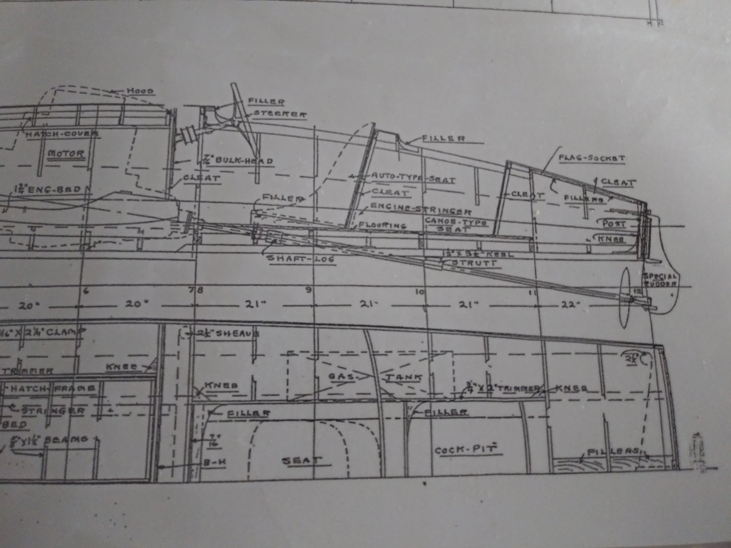

    From your pictures this seems to be a boat with a wooden keel and plywood bottom rebated into it and glass covered. What's the internal structure like? Is everything glued on with epoxy? Wood type? Pictures please.
    If you use a flangeless strut you need to make a hole in the boat, in the middle of the keel. This hole needs to not weaken the keel, and it needs sealing. The normal way is to double up the keel around the hole using the same wood, plus some structure to bolt the strut onto. There are many options and it depends how the boat is built. You tell us that and we will see from there.
    The alternative option is to rebate the flange into the keel on the outside, and use a big wooden doubler on the inside.
