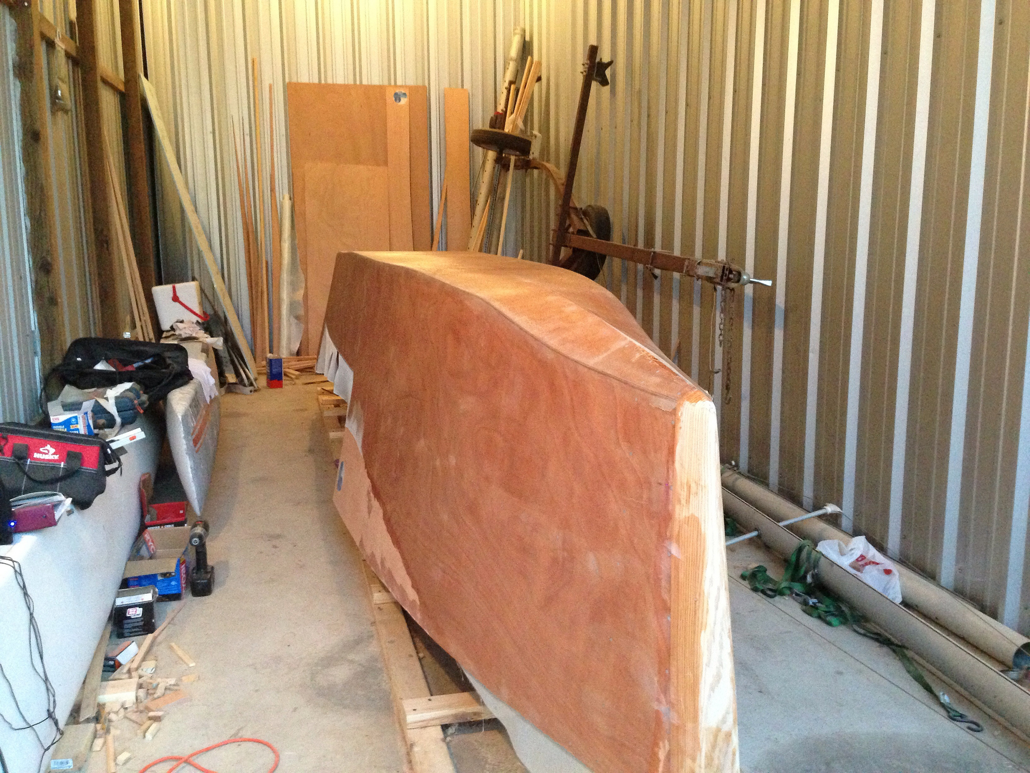

    An example of this issue is the chine joint - among the build blogs you'll see chines that look more like a slalom course than the chine of a boat hull which is (usually a very smooth, continuous curve.
    How does this happen? Well before you put the ply on the frames it's near impossible to visually "see" the "chine to be" -- so errors in your frames are near impossible to find. But using battens to check is not always as sure fire as it seems. Wide spacing of the frames and a limp/bendy batten may leave up the creek so to speak.

    Below, there's 4 major whoops in this example of an improperly built Strike 18 chine... look carefully, all the way to the transom. Don't repeat this building error.

    Im the builder of the strike 18 shown as "what not to do". I personally found the spacing between the frames and the 1/4" ply to be just a tad worrisome, hence the natural sag you see in the picture. I ended up gluing in a small 3/4 x 3/4 stringer to try and remove some of the sag.
    I DID however mess the bow up just slightly. The had to do an emergency frame adjustment and I still didnt get the height quit right on BHD#1, but its ok. Being as I have let the boat sit totally unused and never even sailed for almost 2 years now, I couldnt tell you how it sails. I honestly lost all interest in sailing and trimarans until recently Ive felt the urge again to get it in the water. My obsessions run so deep sometimes that I eventually burn out.
