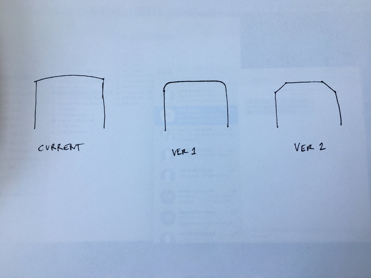

    About the transom.
    The current design is as shown in the picture and the way I see it there are two possible design choices – one with round "corners" and one with 45 /45 degrees (also I'd like to keep the new transom "flat"). And just to be clear the pics are not to scale, only to show what I mean. I'm not sure how much corner cutting I need but approximately a 150 mm radius seems reasonable.
    I've seen both design on planing hulls so I guess they both work. But which one is preferable as far as performance goes?

    Magnus
    Since the chine is probably not dry, I would choose version 2. In this way, the water flow will release better at the sharper corner than the rounded.
    JS

    The idea with most "faceted" chines is to help prevent "tripping, in high speed turns. These can be done a number of ways from fully rounded over with a generous radius to a simple bisected angle across the chine. If the boat can do more than say about 35 MPH, consider the bisected chine, which will cut a cleaner path at speed. If on the other hand your boat isn't a speed demon, consider rounding the chine, which will also soften the ride a touch.

    My guess is you have a misinterpretation of the post #35 sketch Paul, I'll think it shows a top view of the old and new transom before and after the stretch, and not an aft view or cross section of an upside down hull eg during construction. The in top view 90° corner angles of the current transom are bad for going backwards in a field of ice floes, so that needs to be improved on the new transom of the stretched hull, hence the suggested rounded or 45°/45° bisected transom corners.

    I'll guess this means that the corners of the V-bottom to the transom underside also need to be rounded or 45°/45° bisected in the new situation, for enhancement of the reverse possibilities in ice floes, since it looks like it's mostly the V-bottom that sticks into the ice floes . . ?
    If so, then I'm afraid that at the V-bottom to the transom underside transition you'll sure lose some water flow release efficacy vs the old 90° angled transom corners there in the current situation.

    The chines are dry at speed (I think). While I don't have a photo of it I would very much suspect so since, as Angélique pointed out, the boat "sits quite high in the water" (for lack of the correct term).
    Does the term chine also apply to the transition between bottom and transom?
    My sketch does refer to the transition from topside to transom. Is there a term for this part too?
    If I decide to go for the bisected design – while not as good looking it would surely be easier and on par with the rest of the design (or lack thereof) – I have a few questions. I know I can only get a vague and general reply but it's something to begin with.
    1. Is 45/45 degrees reasonable? As far as ice goes it would be best.
    2. How big can this section be? From an ice point of view "the bigger the better" but ice is only a fraction of what needs to be taken into account. As it is today the boat needs constant trimming (on the plane) as it's prone to leaning to one side (it doesn't favour one side, which one depends on wind and payload distribution). It's not a problem but at the same time I don't want to make it substantially more sensitive, something I would suspect can be an issue if I remove too much of the "corners" so to speak.
