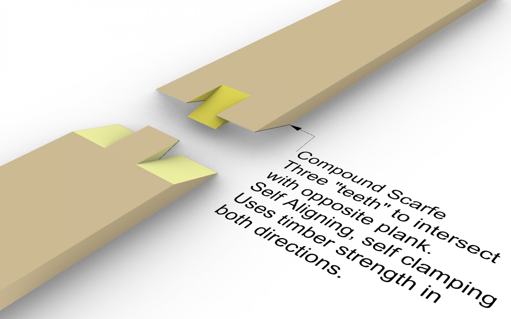

    I am planning to replace my rub rail on my Menger 17 catboat. I need about 18 feet of rail, so I will have to scarf together 3 pieces. My question is: Should I scarf and screw/glue before steaming or steam the 3 pieces and and connect the scarfs as I steam and bend the rub rail to the boat?

    Bend first. Scarf later.
    Doing it the other way is begging for trouble.

    I should have said that it's fine to cut and fit the actual scarf joints on the bench first. That makes a lot of sense. Just don't try to steam any scarf joint that is epoxied, because the heat of the steaming will break down the epoxy.
    So I'd a/ cut the scarfs and make sure they fit, then b/ steam bend the bits that need steam bending, then c/ leave them to dry out for a day or two, then d/ glue them up.
    ETA: Come to think of it, it will depend on where you place the scarf joint. If the boat is only 18 feet long you shouldn't need more than one scarf. That can be placed in the aft sections of the boat, in which case it probably would not need to be steamed.
    It's not necessary to steam an entire length if most of it will bend dry. You just stick the relevant part into the steambox and leave the rest hanging out. So, if you can get away with doing it like that, then you could glue the whole thing up in advance if you wanted to. It's arguably not worth it though, as joining it on the boat is probably easier if the scarf is in an area of gentle curvature.
    tl:dr; version is don't steam the actual scarf after it's glued, but otherwise just use whatever is easiest and makes the most sense.

    ... or you could use a "scissor joint"to overcome the separation pressures, and "standard"Glue that won't come apart under heat.
    It's not like rub-rails have to keep out water.
