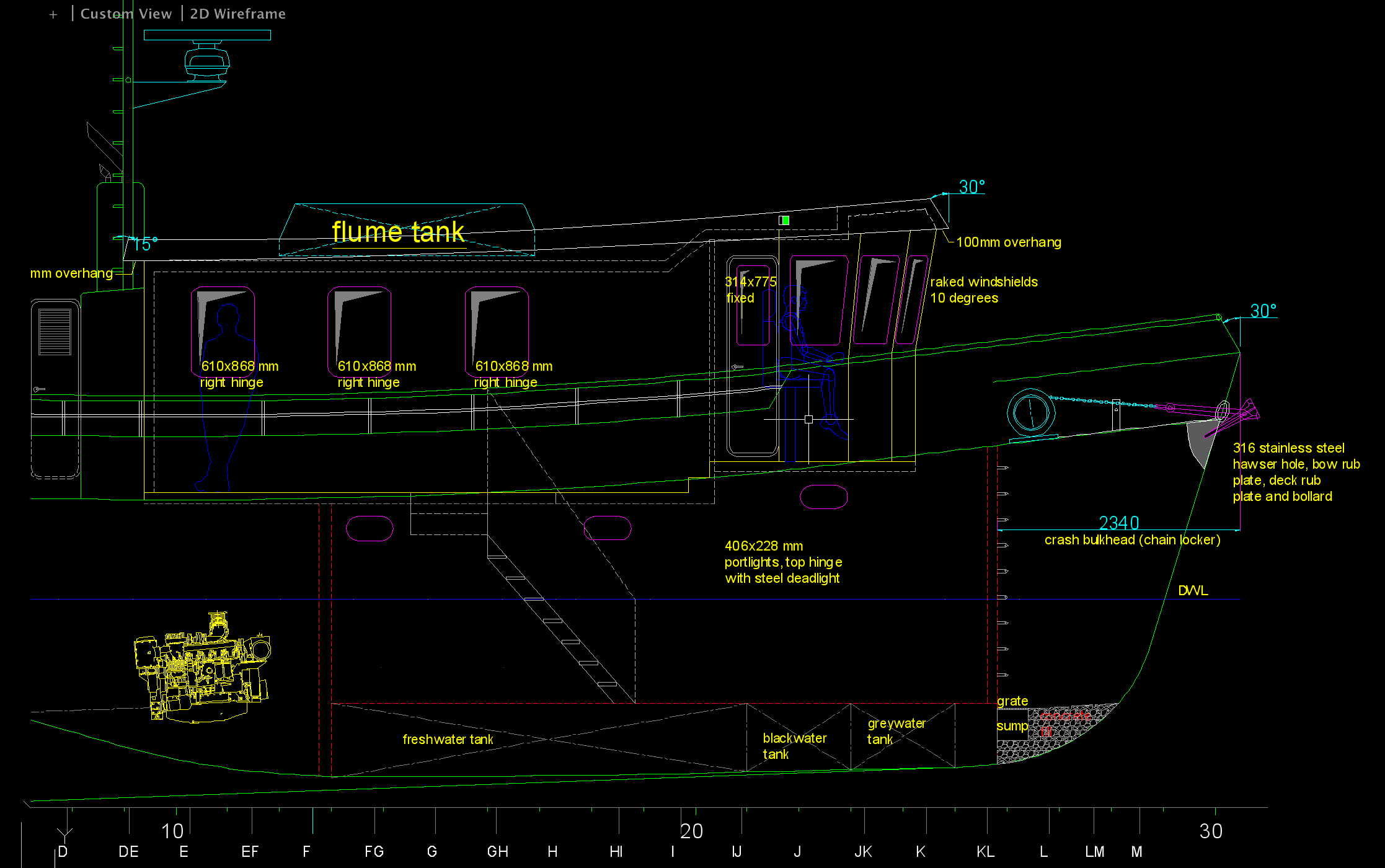

    I am in design stage for my trawler which has relatively low freeboard. The forward cabins are designed with oval portholes 16"x9" are are about 22 inches above DWL. Specs call for aluminum frame with 10mm toughened (tempered) glass glazing.
    I'm concerned about low portholes this far forward in an ocean-going boat. One of my previous boats had portholes like this amidships in the engine room and they took on plenty of water (horrible plastic frames never sealed tight) during rough weather.
    I'm thinking that the best way to make these work would be if outswing with internal metal gasketed deadlights. Basically a double seal in rough conditions.
    Should I be considering double laminated glass, reducing the size of the port lights, etc.?
    Feedback is appreciated.

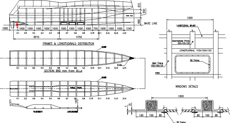

    Here you have a solution adopted by me in several boats, for underwater windows.
    In addition I calculate the thickness of the glass so that the deflection does not exceed thickness. Polycarbonate, in several layers, is what I usually use.
    This solution has been approved by the Administration of my country.
    I hope that works for you guidance.

  8. makobuilders
    Joined: Feb 2009
    Posts: 131
    Likes: 4, Points: 18, Legacy Rep: 10
    Location: Atlanta, USA
    makobuilders Member
    I appreciate the feedback.
    One of my minor concerns is material. My past experience with plastic frames was bad but it was an existing boat and I didn't have the money to change them out.
    This vessel is a new construction, steel hull, so I'll speak to the shipyard to see if they can affordably provide stainless frames, otherwise we'll have to stick with aluminum and then hassle with the galvanic isolation issues. I don't doubt that there exists some space-age composites that work well in normal conditions, but high latitudes extreme cold generally challenges plastic/frp/composites. I don't want to experiment.
    My biggest concern is how low they are to the water. The two that are amidships are about 2ft off DWL. Perhaps can raise them 2 inches more. But I've gone and redrawn the foremost port lights to be about 3ft off the water. They're not exactly in the forepeak but still a concern.
    Will stick with outswing design (so they seal tight against outside pressure) like all the windows (I don't have any sliders). And then will look into gasketed deadlights that bolt on from the interior. Glazing is spec'd at 10mm tempered.
    Of course the obvious comment would be to make them smaller. Tiny little circles, but that would compromise the enjoyability of the boat during the 99.99% of the cruising days, when the skies are blue, the air warm and the breeze a perfect summer day :p
