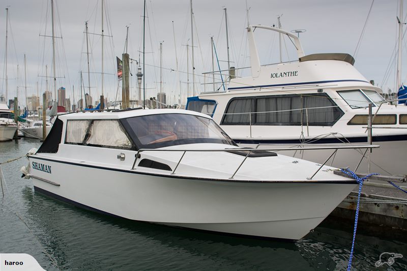

    A Few More Worthy Boats
    Frank Pelin was a noted blue water designer in NZ he passed away a year or so ago There are literally hundreds of his boats on the water here .You often see youtube videos of pilot interceptor boats in storms .These are all deep vee planning hulls .Although quite a few are listed as displacement they still have this deep vee design
    The red steel one is my favourite 40 ft steel 6lxb gardner diesel for 80k US
    The ideal commuter

    The red one is a displacement hull, surely ?

    Regarding the Pelins some like the pelin topaz and Apollo are usually powered with 100-150hp and achieve 18-23 knots .We had a 29ft Pelin empress which was a deeper vee (gullwing ) with a 135hp which achieved 18 knots but it was built like a tank with 25mm ply double diagonal . The red Pelin I posted was a displacement type. But there is a certain comfort in a steel boat when it comes to impact resistance
