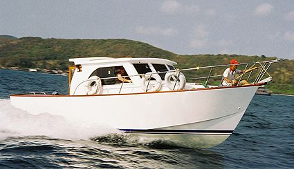

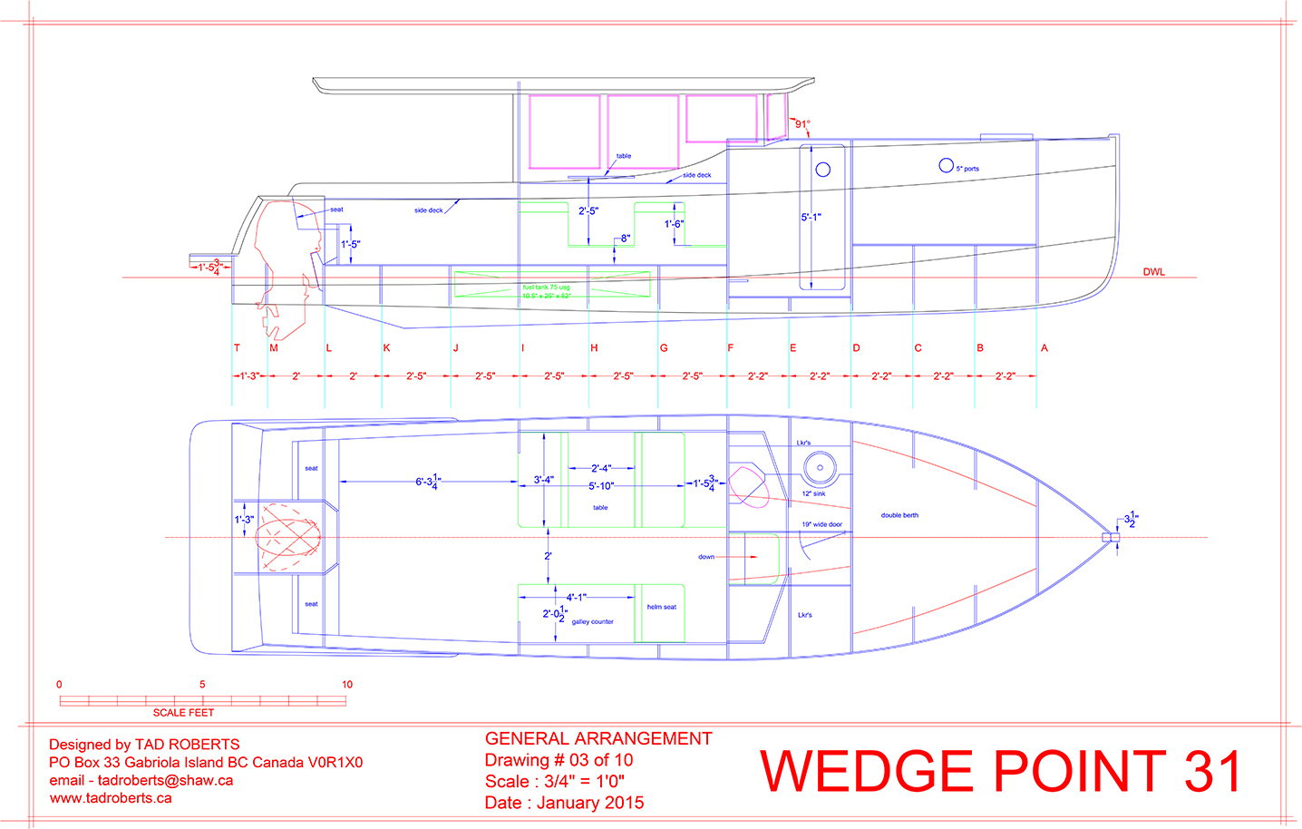

    Having speed potential is the moot point .Sure a Stabicraft will get you there in 45 minutes but you have burned 100 litres of fuel in a craft that is the average price of a house .The alternative is a 30 ft launch which is about the right size for 4-5 people plus provisions .Something with a beam of 8ft might be rule beater concerning displacement speed .If you can cruise at 13-15knots that is probably the best compromise .To be able to plane at 20knots with 5 people and their gear with only a 100hp motor is a bit of an ask .Tads boat wedge point 31 is similar to a number of boats launched in nz in the past few years that you don't need a fuel tanker dockside

    I don't think 30ft hull is long enough , I envisaged something around 40ft length, and quite narrow for this length. It would be an essentially empty boat, having nothing more than lots of empty space/ voids, a long rear deck and a center cabin for the passengers to keep the building costs under control as I don't think this type of thing could be bought off the second hand market. I would power it by a marinizsd car engine of an aluminium block type common rail turbo diesel of less than 2L displacement. These can be had for under $2500nzd from auto wreckers for a very late model unit with only a handful of kms on it - already checked into this myself...

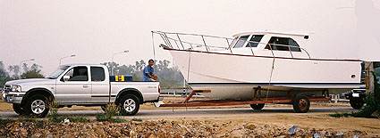

    nzboy Senior Member
    Some of Bruce Roberts designs fit like a 28-32 coastworker with an 8ft beam planing and trailerable .Once you have a boat thats to big to get out of the water and take home the costs of ownership start heading upwards. These boats are no nonsense and very similar concept to the newer cray boats being built in the south eg. deep vee and planing
