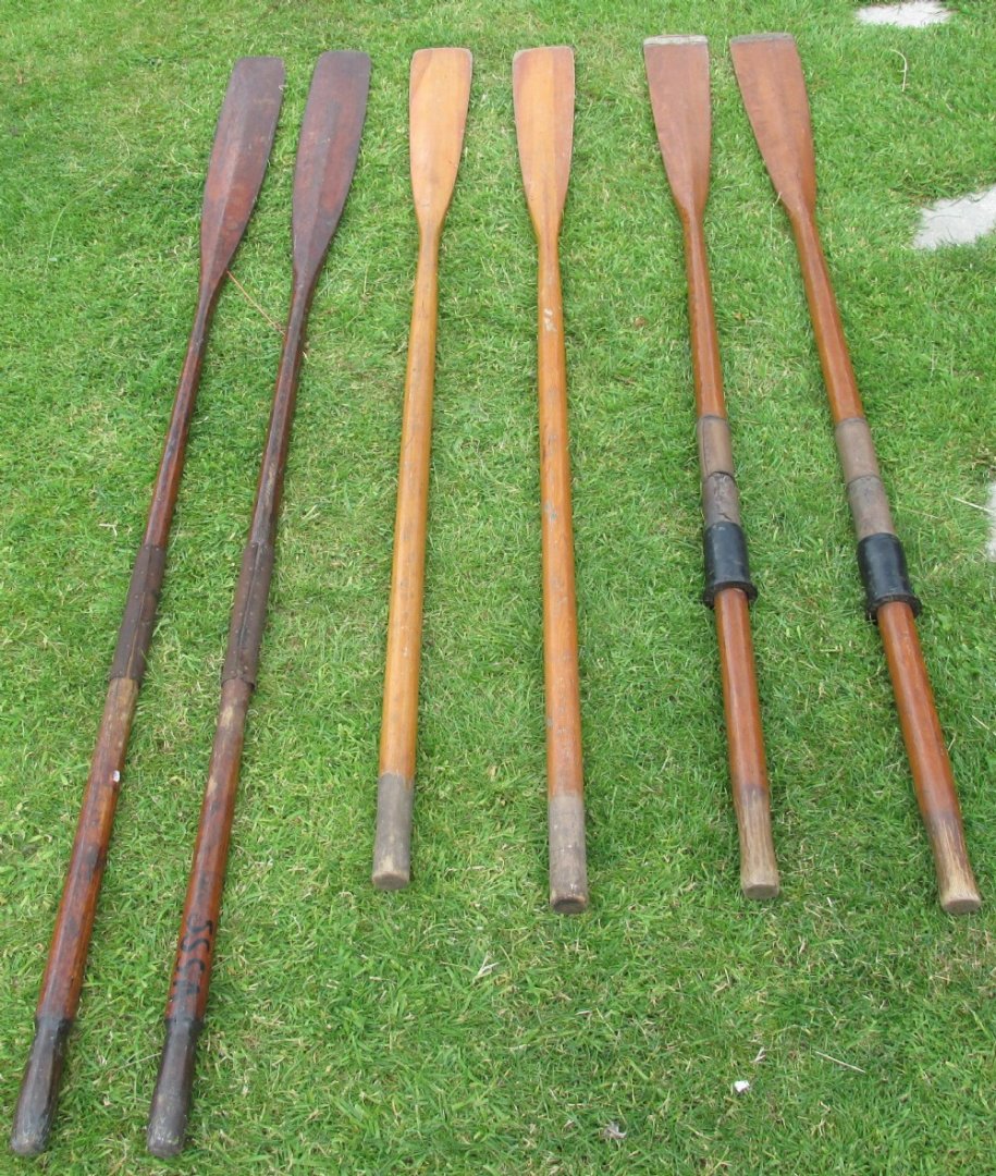

    I want a Stand Up Rower (SUR) but with oars that Stay In Water (SIW) sorta like rear sculling single or used on transome, but off to the sides, and the oar blades would function more like Hobie flippers. The Body Motion would be down near ankles to full overhead reach (or anything in between). In theory, this would, like Hobie or aft sculling oar, not waste energy with any recovery stroke. I guess it would need an way to keep the oar's pivot on the transom during the (rower's) Lifting stroke. I'm thinking the oars would be manually canted 15-25deg (total 30-50deg), and the oars would be similar to the long oars on the left, except maybe longer, and would have their tailing edge sharpened and blade given an "aerobatic" airfoil. Strokes up and down wouldn't be of equal speed and I'm guessing the rower's down stroke would be more POWERFUL but not necessarily the FASTEST, thus the oar's foil not likely to be exactly symmetrical. Oars cold be used more conventionally, with diff oarlocks or rower position.
