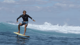

    He's surfing waves. Not sure if you can ride a wave 10 miles - maybe in Hawaii... The leg pumping appears to be happening when he approaches chop, to skip over it without bottoming out on it (and quickly slowing down and taking a header).
    Or it could all be a fake, a mighty impressive one.

    It's hard to see how or why the videos of Kai foiling would be faked. In a decent breeze it's not hard at all to get a SUP surfing on chop at a few knots; even without foils you can easily paddle a longboard windsurfer downwind so fast that the centreboard starts developing significant lift and tries to roll the board over. Given the light weight of SUPs it's easy to see how you could achieve take-off speed.
    But Kai has won the world SUP racing championship, so the fact that he can do it doesn't mean that normal people can do it routinely or practically (as distinct from downwind in breeze in chop). Pro cyclists develop over twice the power of leisure cyclists and untrained people. The pros also develop about 30% more power than a Cat 3 racing cyclist; that's the sort of keen local racer who tears the legs off the cafe heroes. Using cyclists as a guide, at a wild guess even the SUP racers I know could be developing only half the power of Kai and leisure SUPpers will be developing even less - so how will that affect their ability to get up on the foils unless they have a big wave and a howling tailwind?
    It's cool to see this, though, particularly since if there's interest it could lead to some foils being available for longboard windsurfing and that would suit me. But the fact that a world champ can do something doesn't mean that a normal person can do it. From some angles, a vid like this can be the equivalent of putting up a video of Chris Froome and Alberto Contador riding up Alpe d' Huez at 21 kmh - sure it's possible, but not necessarily for mere mortals. And of course given the terrible upwind performance of SUPs in a breeze, you could only really do downwinders once the breeze is as strong as it is in these vids. The logistics involved in foiling a SUP seem to be dramatically lower than foiling on a boat, though, so it could be a good way to get a foiling fix for those who want it.

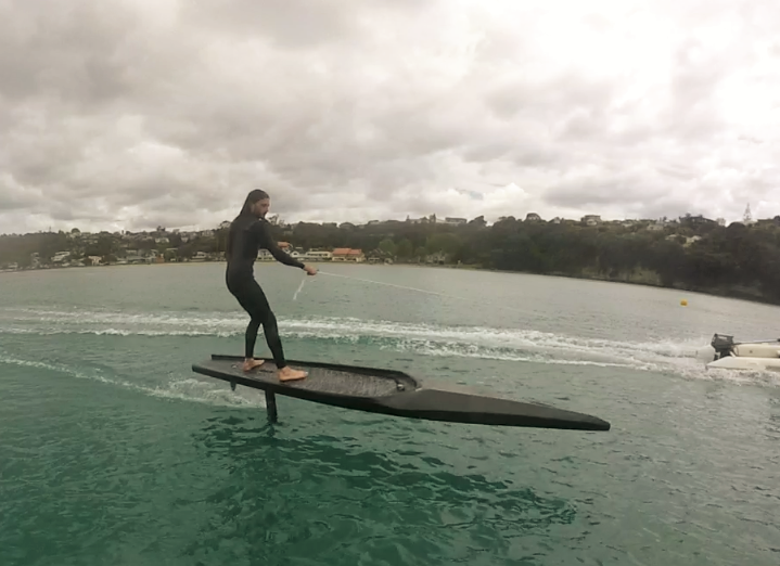

    I will say it is ALOT harder than it looks! after a couple of minutes of paddling your ring out, trying to steer the board in the chop and leg pumping like crazy you can see why you need to be mr. intergalactic sup champion to do it
    We are almost achieving man powered flight, a lower aspect main foil and we will be there i think

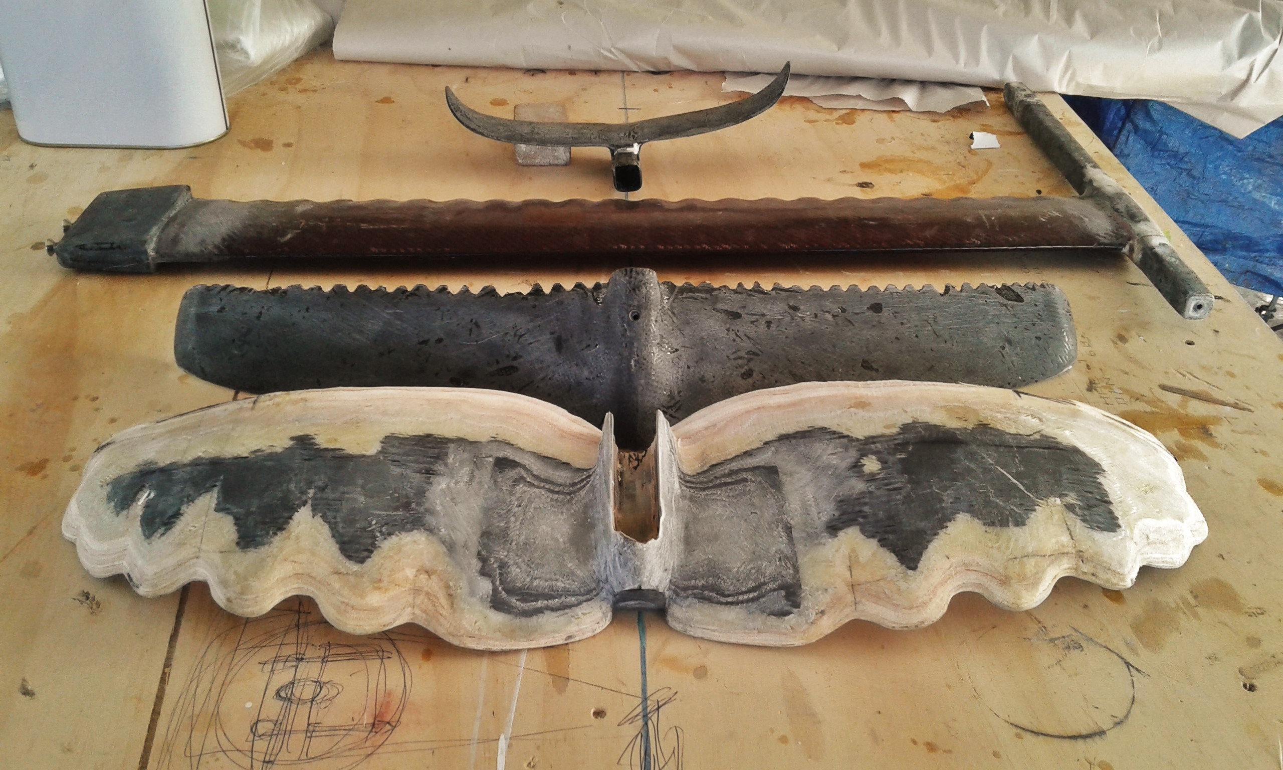

    Very interesting foils. Can you say a little about the theory? The tubercles I've seen looked to me like they were on the leading edge but these look like they're on the trailing edge?

    The unfinished foil in the front is based on the humpback whale fluke with the leading edge tubercles.
    The black foil I tried a flexible trailing edge but that didnt seem to work (we were still learning to fly a 13' sup so of course it was all the foils fault) thus i took to it with a file and thats how it ended up, it gets a slight flutter on before stalling but that is a good stall alarm in my opinion.
    The fin/mast/whatever has a serrated trailing edge, the light makes it look a bit funny. this and a few bumps from sanding into the kevlar mean the smooth flow is often tripped making the board uncontrollable until the flow reattaches.
    I didnt know how any of this was going to turn out I just figured I've never seen a straight trailing edge in nature so theres gotta be something to it

    Just for clarity, it is humpback whale fins which have the leading edge tubercles. The flukes have trailing edge serrations. My understanding is that the tubercles on the leading edge channel the fluid into faster moving jets, and this gives greater lift. The trailing edge serrations (which are much more common in nature than the leading edge tubercles) I believe control/reduce/stabilise noisy/turbulent flow off the trailing edge.
