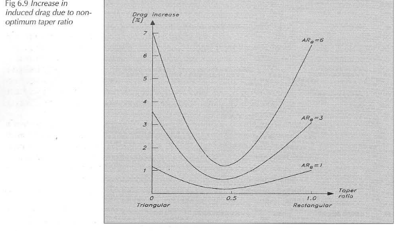

    dustman Senior Member
    It seems like I may take ~4% hit as far as drag for the rectangular planform on the sails for a 4:1 AR, ~3% for 3:1 AR of keels and rudders. Screen Shot 2023-01-14 at 3.24.39 AM.png
    Also of interest in that book is that a smaller aspect ratio foil can maintain lift to twice AoA of a very high aspect foil approaching infinite. In terms of lift to drag ratio, it seems going much beyond 4:1 sees diminishing returns, especially when taking into consideration stability and structure.
    Given the much easier application of junk sheeting and not having to design and create every batten differently for a trapezoidal planform, the rectangular planform seems well worth the sacrifice. I can't point to a specific piece of literature, but I have gotten the inkling that the rectangular planform is more docile in some ways.

    Please read this entire post before responding.
    Induced drag (drag due to trailing vorticity including tip vortices) depends on span only, not on chord, for a given planform shape. Induced drag for a given lift is reduced if span is increased. That means for the same amount of lift and a fixed span the induced drag will not change if the area and chord is increased and the aspect ratio decreases. The induced drag is only affected by aspect ratio if the area is fixed and the span is changed to vary aspect ratio. (Confusion arises when looking at induced drag coefficient vs lift coefficient with the coefficients based on planform area.)
    The drag also depends on viscous/skin friction drag, which is a function of area and angle of attack. For the same angle of attack lift and viscous drag increases with increasing area. For the same area viscous drag increases with increasing angle of attack. For the same lift there is a tradeoff between angle of attack and area. Short version: the area for minimum drag is almost always less than the area needed for other reasons.
    Bottom line: Maximize the span of the centerboard and rudder based on draft constraints, structural considerations, etc. Select the area based on resistance to stalling, ventilation, structural, etc considerations. Make the area as big as it needs to be. If performance is a concern don't make the area bigger than it needs to be.
  10. DCockey
    Joined: Oct 2009
    Posts: 5,229
    Likes: 634, Points: 113, Legacy Rep: 1485
    Location: Midcoast Maine
    DCockey Senior Member
    Induced drag dependence on planform shape graphs usually do not include free surface effects, Wave making resistance of a keel or rudder is decreased if the area is decreased at the root/ top and increased at the tip/bottom. But too much of a shift of area to the tip can increase induced drag. Bottom line - the drag increase with a square tip compared to an elliptical tip may be less than shown on a graph, depending on whether the graph includes free surface effects, the shape of the hull, etc.
