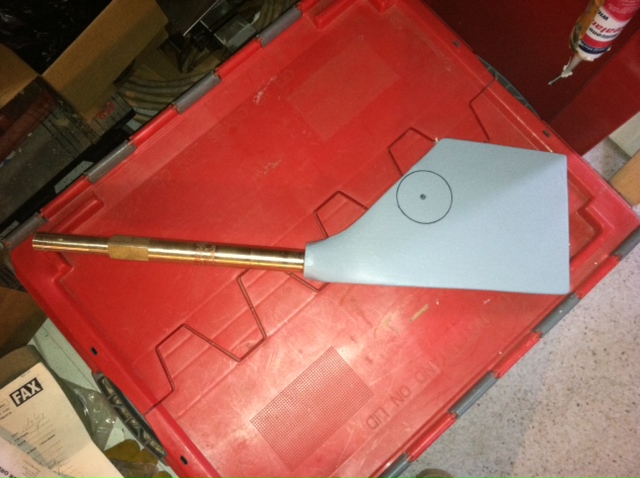

    Thanks guys. These are the kinds of replies that I was expecting. I've owned the boat for 11 years already. Normally we use it as a pocket cruiser. Point A to point B is great, and in the anchorage it's rarely a problem. Aftermarket rudders are sold to replace the tiny stock high speed rudders. I just opted to modify mine instead. I'm sure they will be a big improvement over the stock design, and don't think torsional fatigue failure of the shafts will become a problem. Relatively speaking she is no speed demon at 21 knots, but she gets through the slop just fine at that speed. I was hoping to come up with a solution to help reduce or at least dampen the snap roll on the drift. Adding the somewhat smallish keel will shave some speed, but if that is the only ill side effect it would be fine by me. Sometimes I tend to think too much, but as an engineer it's what I tend to do. Generally speaking we tend to believe that "if it would work that way to begin with, don't you think they would have built them all that way?" However, the view point of "the consumer" and the view point of the designer come from completely different angles and it's not always that simple to answer. Cost cutting has ruined many a good product over the years and the aftermarket is alive and well with viable improvements for just about anything.

    the rudders
    make sure they are not foil cross section - not good on fast(er) boats. A couple of boats we put a 'fishtail' at the trailing edge. A big help in low speed steering.

    The cross section of the stock rudder is actually wedge shaped with a thin leading edge and a thick trailing edge. The modified version is not a true foil, but it does flatten out aft of the weld joint. I'm not sure if you can make it out in the photo or not. If anything, it's a reverse foil. We'll see how it handles before making any changes. Epoxy fairing compound can work wonders if need be.
