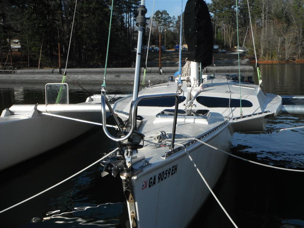

    I have a 33'tri that I was rebuilding and I have converted to mostly synthetic rigging, recently launched. First, I own a roll swedge machine and I have wire on hand so cost was not part of my decision process.
    From bare mast, near as I can determine, a "Colligo" system would be about 1/3 more than wire if you had to buy all the components the first time and replacing just the wire or line somewhat less for the synthetic, assuming reusable wire ends. I don't think you can justify synthetic on just cost.
    However, I am really happy with my choice of a synthetic system as it seems to do everything else better. As measured on my rig, I saved 60 Lbs aloft between replacing wire stays and using dyneema halyards, and they are all stronger than what they replaced. That is a LOT of weight on a 40' mast.

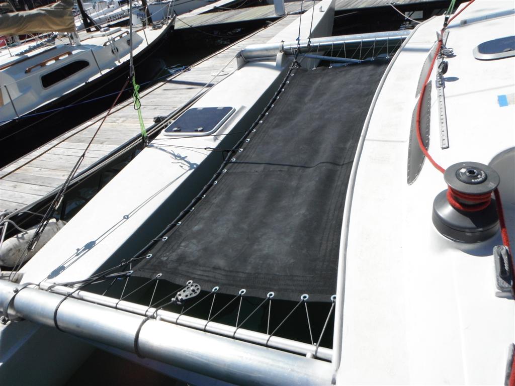

    I have re-tightened the rig several times in the first month, now it seems very stable with no more noticeable set/creep. Mine was all pro spliced and pre stretched by a Colligo certified rigger. I do most of my own halyards and smaller splices. I think the Colligo rigging parts give me peace of mind but they are pricey, on a smaller boat other solutions would probably work quite well. I have "X" stays under my tramps I made with 1/2" amsteel and big stainless eyes and they seem to be working well also.
    If you trailer, synthetic is so much easier to deal with I can't imagine using anything else.
    B
