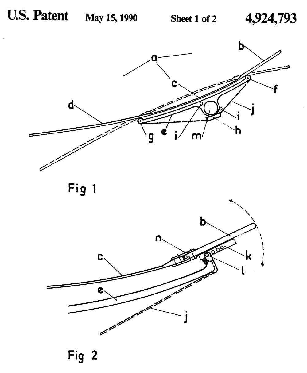

OK, I found a box with some old material that I had laid aside to submit to this discussion, and never did.
So the first such item is a US patent I ran across a number of years ago that looked quite interesting.
"Standoff Batten Rig for Flexible Airfoil, Conformation on Both Tacks."
Patent #4,924,793
https://www.google.com/patents/US4924793
A rig battened with standoff battens presents a concave camber towards the wind on both tacks while remaining on one side of the mast ...
The rig can tack without the difficulties encountered by a traditional square rig. Similar camber is presented to the wind on each tack.
The overall camber can be varied, as well as the leading and trailing foils. It might be said that it creates a new rig which imitates a fixed solid surfaced wing with leading edge flaps.

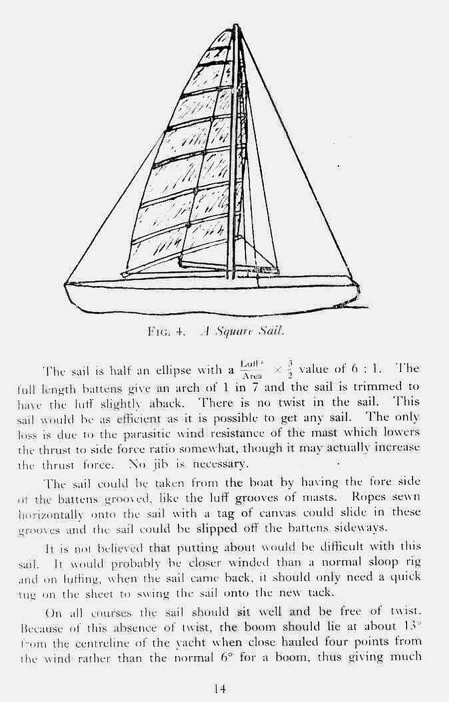

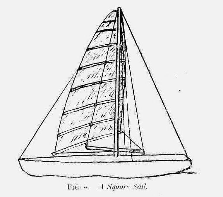

old AYRS idea
I was just looking today for some original photos and text pertaining to some inspiration I originally had for my mast-aft rig design. It had appeared in a 1956 issue of AYRS (Amateur Yacht Research Society).
In that same issue I ran across this square rig idea. As I look at it from a number of different aspects, I think I see some original thinking,....some alternative possibilities :?:
Hopefully you will be able to read it as I tried excerpting a single page from a PDF document.

This rig, IMHO, is too complicated and too stressed to work well.
Apparently, the battens, or boomlets, if you will, are intended to ride up and down a wire, which itself attaches to another boom like structure, which crosses the mast, then has another wire running up from its aft end to the top of the mast, to counter act the one in front.
Presumably, the boom-like structure attaches to the mas, with a high load bearing pivot point.
What is likely to happen here is, when the sail fills, the boomlets will all pull on the luff wire, putting great tension on it. This load will be transferred to the pivot point of the boom-like structure, then to its aft wire. This will cause considerable bending moments on the boom-like structure, as well as considerable extra compression loads on the mast.
I see great difficulty in holding a reasonable shape to this sail in any kind of wind.
Add to that that it swaps luffs at every tack, means that it must have a shallow (in section) leading edge, which further reduces its likely efficiency.
Phil Bolger once proposed a rig quite similar to this, for a proa design of his. The sail was only held up by its halyard and the Boom wasn't intended to even touch the mast. It had a bunch of battens which gave it the half ellipse plan form. The interesting part was the boom was connected to the deck with two adjustable tethers, spaced maybe 15% of the Boom length from the sail's plan center line, on the Boom. Together they formed a "V" with the apex near the mast partners.
When the proa shunted, the forward tether was tightened and the aft one loosened, so the new front end of the boom tilted down toward the deck and the aft one tilted upward. This brought the Center of Area aft each time, while putting more tension on the new luff than on the new leach, presumably making the sail perform more like a fore and aft one.
I don't know if this rig was ever tried, but, in my mind's eye, I can see how it might work. It has far fewer parts and far fewer likely loads than the IYRS rig shown here.
Except on a proa, I just don't see how an athwart rig can be an improvement on a fore and aft one, though it certainly may have its place as a specialized down wind sail.

Traditionally, the great advantage of the athwart rig is that one side of the sail surface was always upwind. This is probably the reason it was used on huge sailing vessels well into the 20th century.
Because of this property, it was possible to divide the rig into to separate sails, one on top of the other, on the same mast. This way crews could go aloft and safely (relatively speaking) furl these individual sails.
This could not be done on a fore-and-aft rig, as in the event of a jibe, the furling crew could end up on the down wind side of the sail, a very dangerous place to be.
For this reason, large fore-and-aft rigged ships had a single sail on each mast, as well as maybe a relatively small top sail. Most of the sail had to come down as a single unit, so it was enormously heavy.
To compensate for this, these fore-and-aft rigged vessels usually had more masts and were comparatively under rigged. One had as many as seven masts, but most had four or five, for the larger vessels.
I think it is important to remember these historic facts when considering this rig type for a general purpose sail. The Maltese Falcon is but a modern version of this rig, used much for the same reason it was used on larger ships in the past: to break up the sail area on each mast into smaller furl-able sails, on fixed spars. Except, this time these sails are furled by machines, rather than human crews.
Though it is true that the athwart (square) rig is best for dead down wind sailing, the fore-and-aft rig does fine with down wind tacks.

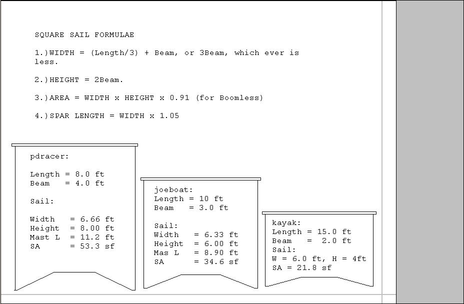

Single Square sail proportions
Way back in the ‘00’s, when the pdracer fleet was getting started, someone suggested a square rig version. I guess it kind of makes sense, a square sail for a square boat.
I thought about it, then drew one rigged as a 15th century carrack. I drew it up with my CAD program. It wasn’t quite a carrack because it didn’t have a fore mast, and it did have a boom under the main sail. Other than that, it looked the part. It had a lateen sail on a short mizzen, which also had a boom, and a sprit sail, hanging from a bowsprit. The total SA was in the mid 60’s in sf. I called it ‘Nine Sheets’, as that was how many lines one was going to have to use to control its three sails. I can imagine someone trying to sail it alone, trying to make windward progress. It would be a real handful. And a real achievement if he/she pulled it off.
But I lost that file.
Now I’ve been thinking of the square sail again, particularly the single sail version, which ruled the seas for at least three millennium.

So, to satisfy my own curiosity, I came up with a few formulae to proportion a square sail. I used them on three very differently proportioned boat designs of mine. One is very wide, another is considerably narrower, and the third is very narrow.
The formulae are below. Drawings of the three sails are in the attachment.
SQUARE SAIL FORMULAE (for a single sail)
Sail Width =
Beam* + (Length/3) or 3 Beams, which ever is less.
Sail Height =
2Beam
Nominal Sail Area =
Sail Width x Sail Height.
Actual Sail Area will be up to 9% less, depending on design factors such as whether or not it has a Boom. These formulas do not take Displacement into account, but produce the largest single Square Sail that is likely to be safely managed. Sail can be scaled down if need be.
Yard Length =
Sail Width x 1.05
Mast Length =
Sail Height + 0.15 Sail Width + Burry to highest Gunwale, or House Height.
‘Beam*’ is to be taken as no greater than Length/2, if it is wider.
‘Length’ is to be taken at its greatest point, usually at the deck level or at the top of the Gunwales.

6.33 ft x 6.00 ft = 38 sf
Actual Sail Area closer to 34 sf
Yard Length =
6.33 ft x 1.05 = 6.65 ft
Mast Length =
6.00 ft + (6.33 ft x 0.15) + 1.25 ft = 8.2 ft
EXAMPLE 3: (a 2ft x 15 ft kayak)
Sail Width =
2 ft + (15 ft/3 = 7 ft no
or
3 x 2 ft = 6 ft yes
Sail Height =
2 x 2 ft = 4 ft
Sail Area (Boom less)
6 ft x 4 ft x 0.91 = 21.8 sf
Yard Length =
1.05 x 6 = 6.33 ft
Mast Length =
1.5 ft + (6.33 x 0.15) + 4 ft = 6.5 ft
The single square sails, indicated by these formulae, produced S/D’s ranging from the high single digits to the mid teens, with the pdracer getting the highest (at 14.9) and the kayak getting the lowest (at 8.0).
