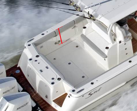

    To make easier to understand it is better to show some pictures about what I mean by my question, not free board of course but internally from deck level to top Sheerline, topplank...
    Actually mainly matter to ease the anglers It would be matter of a rather modern sport fishing boat design of approx 12 m length similar to this:
    Appreciate your kind comments again.

    If you have outboard engines in a well (I presume as per your first attachment in your last post above), rather than a bracket on the swim platform (as shown in the aerial screenshot photo), then in addition to sufficient freeboard you will need to ensure that the depth of the well is sufficient for containing water (and draining it overboard quickly) if (for example) a wave comes over the transom (this can easily happen if you are backing down on a fish, as per the video I posted above).

    More important to consider broaching wave or backing hard into the sea to chase a big marlin. Both require massive scuppers and oriented to flow when backing means out the sides.
    For passenger safety not related to ingress, you can also use railings.
    The height of one meter is a bit much for either while 70cm might be a bit short and still want a railing. The railing offers more than the bulwark. It is a handhold.
