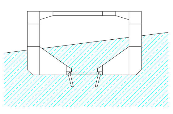

  11. TANSL
    Joined: Sep 2011
    Posts: 6,565
    Location: Spain
    TANSL Senior Member
    When a bottom door is open, partial flooding of the pitcher occurs, as seen in the picture, the hull loses buoyancy; stability in that condition must be studied.
    For this, it is best to make a 3D model of the hull and, if the model is a solid model, better.
