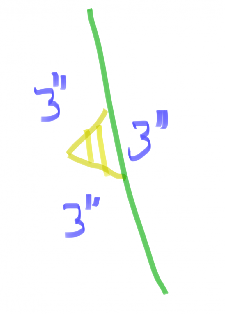

I quote Ondarvr : "For a quick test, buy some PVC trim about the correct dimensions at the hardware store, you can easily shape it with wood working tools, and it bends to a custom fit with a little heat. Use two sided tape to attach it temporarily to the hull, don't use the really good 3m tape for a temporary test, it may work for a more permanent test though.
This will be cheap and quick to see what works and where it needs to be located. You can use it like that until you make something more permanent."
I read it today. Very good idea. You have different sea states and speeds.
