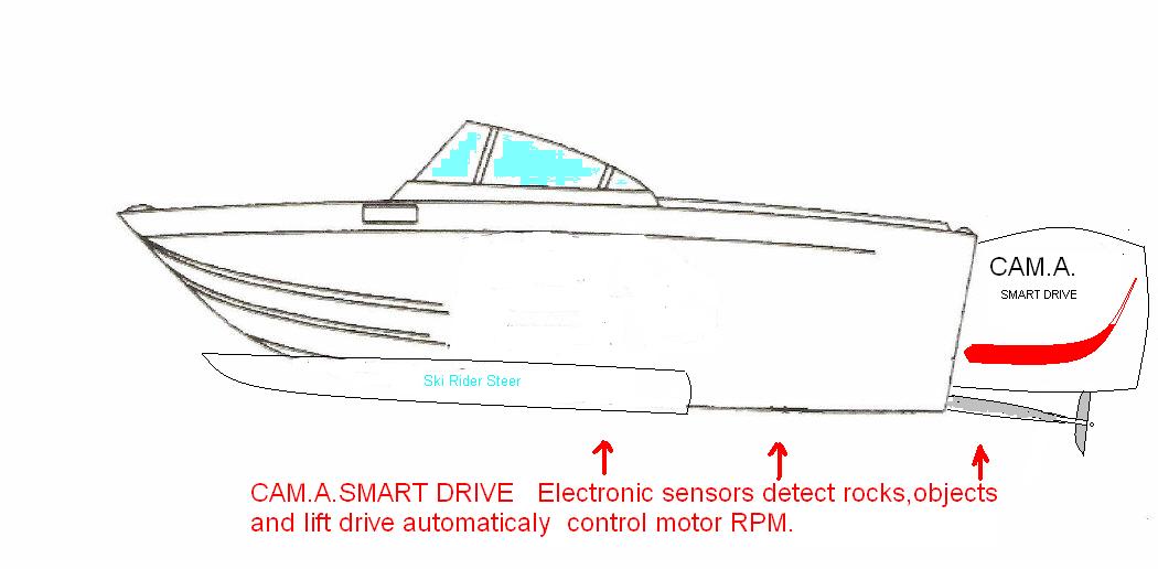

    I always remember seeing at a cinema in the 1940`s a boat with skis fixed and flexible along the sides of the boat built by a New Zealand boat builder and never forgot that display because it run so well.
    I have experimented with the idea for a long time similar to the image shown
    using a retractable shaft drive which can be run in Surface Piercing mode or Subsurface mode. My interest is in the smaller craft about 18 20 feet long.
