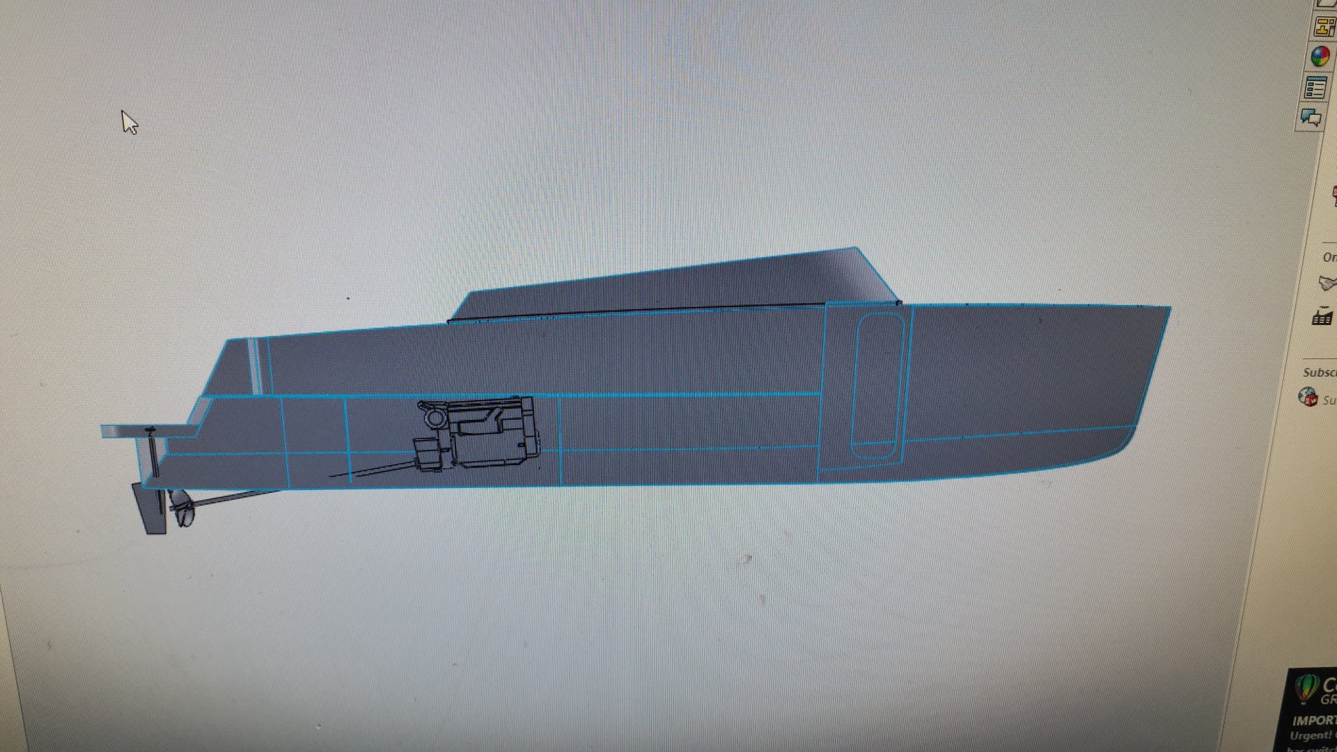

    I have 15 deadrise at the transom, but i keep it till the past midle of the boat

  9. TANSL
    Joined: Sep 2011
    Posts: 7,765
    Likes: 855, Points: 123, Legacy Rep: 300
    Location: Spain
    TANSL Senior Member
    Are you sure that there is enough space between the two engines. Why not separate the propeller shafts a bit more?
  10. tonipu
    Joined: Dec 2014
    Posts: 176
    Likes: 11, Points: 18, Legacy Rep: 10
    Location: croatia
    tonipu Senior Member
    now is 1100mm center engine to center, it is only way it can fit, without adding a prop pocket
  11. tonipu
    Joined: Dec 2014
    Posts: 176
    Location: croatia
    I can lay between two engines for service, and engine cover will be in one peace 2000mm wide by 2000mm long, so I can do the maintenance
