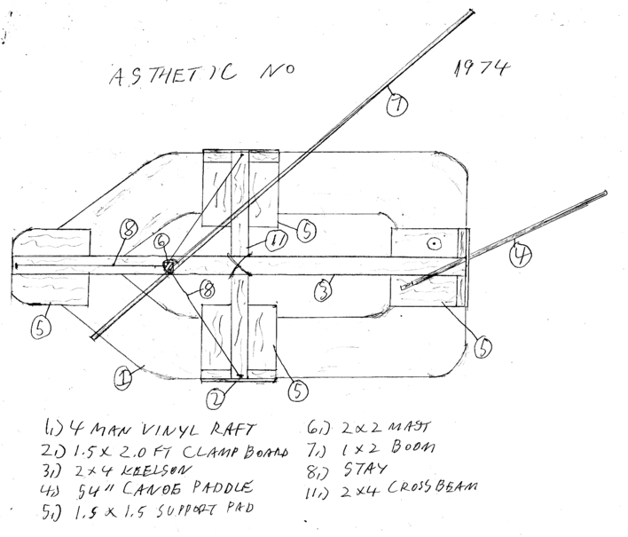

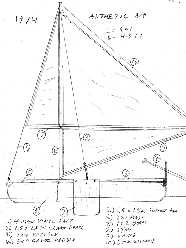

  14. sharpii2
    Joined: May 2004
    Posts: 2,046
    Likes: 206, Points: 63, Legacy Rep: 611
    Location: Michigan, USA
    sharpii2 Senior Member
    I suppose a skin-on-frame boat, such as a kayak or canoe can be considered a space frame boat of the most extreme sort. The skin has no bending or compression strength of its own. That is provided by the frame. It does tension have strength, and of course, it keeps the water out.
    A more personal example is a frame I made to turn a vinyl four man raft into a sailboat.
    (See attachments)
    The frame took all the rigging and most of the other sailing loads, leaving the raft with just compression loads.
    It did actually sail and was able to sail upwind surprisingly well.
    Other than a skin-on-frame boat, the space frame concept tends to add extra weight, over a more conventional design.
    This is because the space frame itself tends to impose point loads on the rest of the structure, which have to buffered and/or distributed some how.
    The large plywood pads on my raft design are an example of this.
