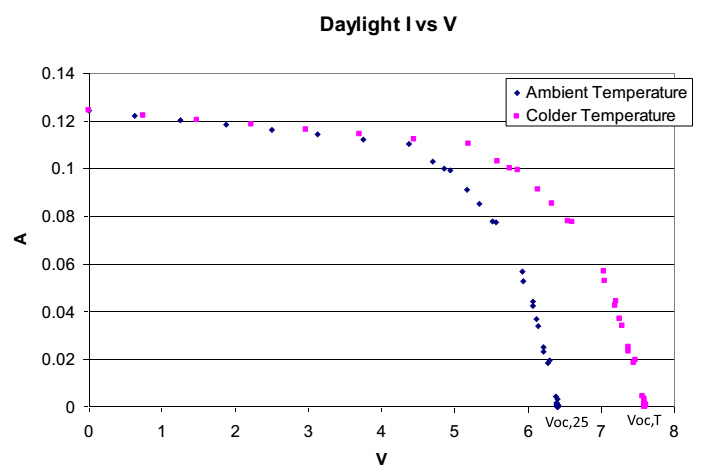

    The published efficiency figures come from tests done at standard 25°C air temperature and wind speed of 1 m/s.
    Everything else being equal, at other temperatures the efficiency will vary according to the formula:
    Eff(T) = Eff(25°)*[1-0.004*(T-25°)]
    The V-I curve will also accordingly undergo a shift:
    Hence, at air temperatures higher than 25°C the voltage drops (for the same current) and so does the efficiency. For air temperatures lower than 25°C the opposite happens.
    For example, if a nominally 22% efficient solar panel (Eff(25°)=0.22) is placed at 35°C air temperature at 1 m/s the efficiency will drop to Eff(T)=0.22(1-0.045)=0.21 or 21%.
    However, when the panel is exposed to a direct sunlight or is placed in an area of stagnant air, cells will be washed by a film of hot air (like 40-50°, and up to 65°C). In that case the efficiency will have a further drop, down to approx. 19%.
    That's an important thing to bear in mind when calculating the actual peak power output of a PV module.
