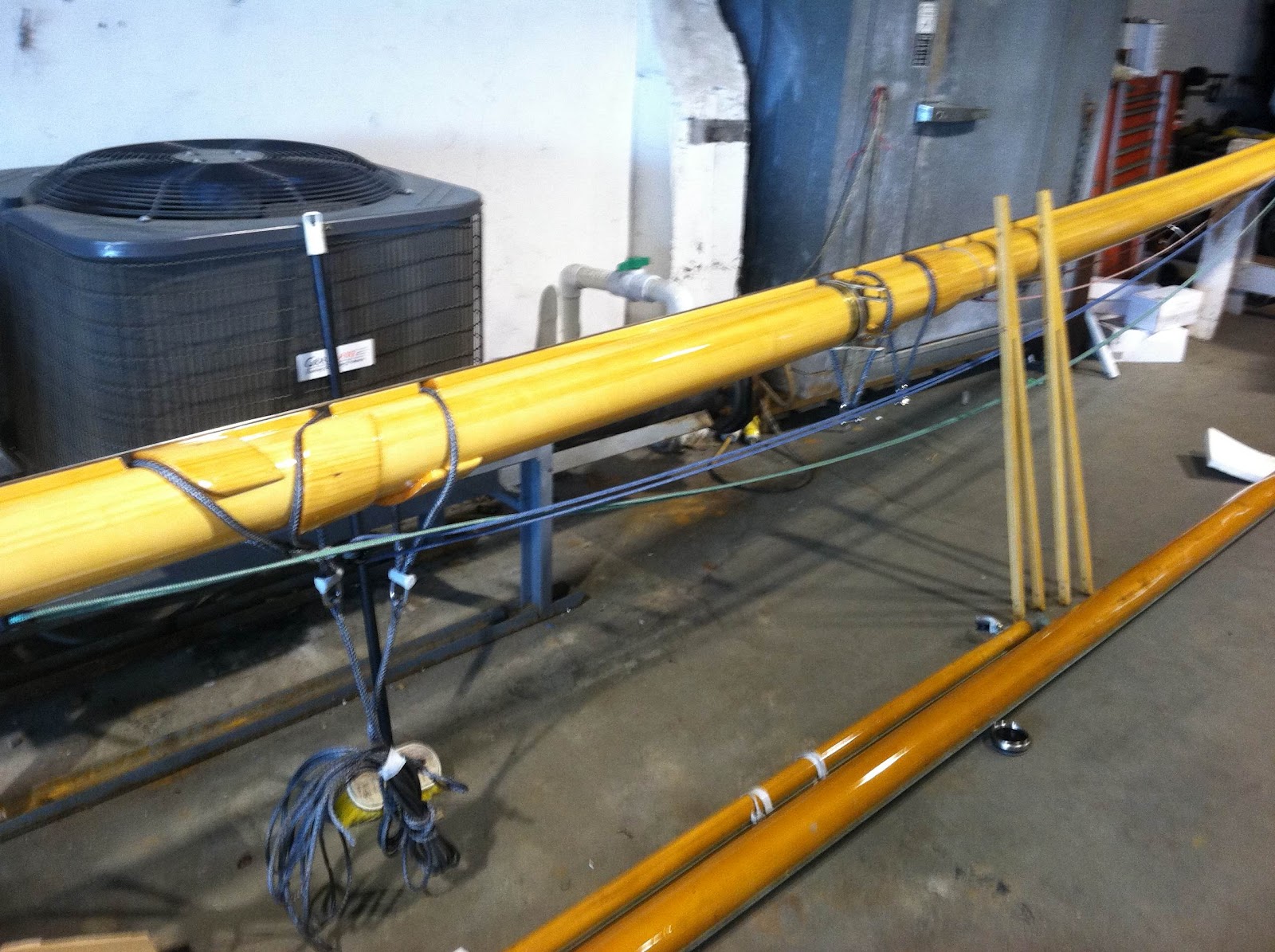

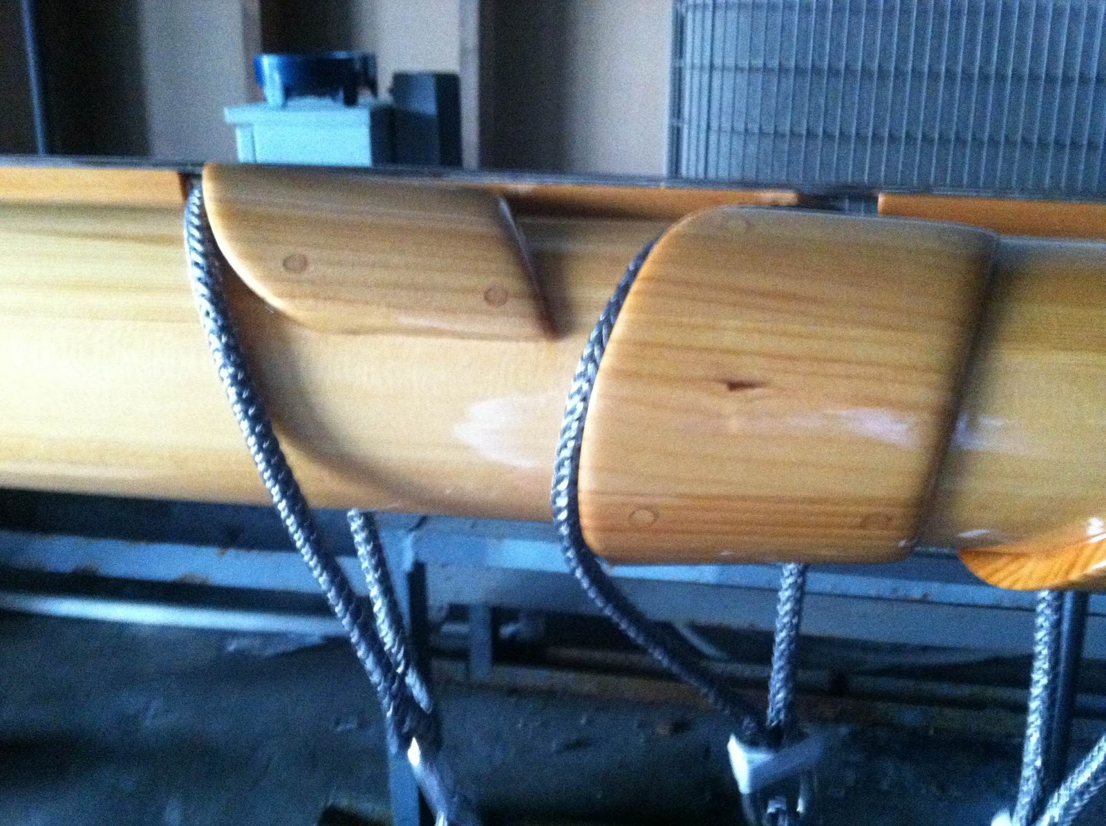

These are a few photos I had stored on my computer

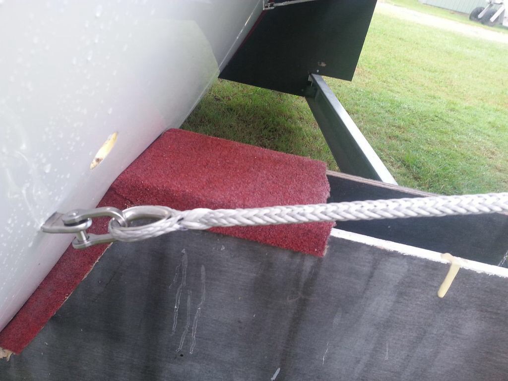

I just did a heap of splicing with Dynex dux . 7mm side stays and forstay and water stays , 6 mm prodder stays .
Very easy to work with , once you get the hang of it a splice will take about 5 mins . The saving on swaging and adjusters alone nearly paid for the rope and thimbles , used ronstan solid sailmakers thimbles.
