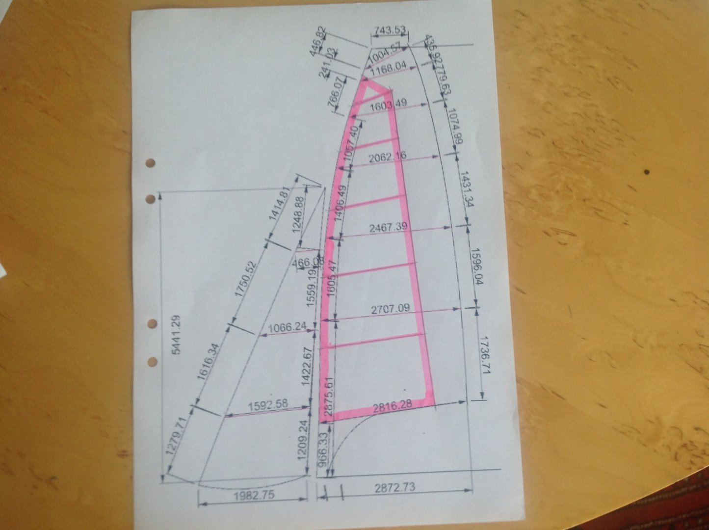

    Hi Lurch723,
    Admit, interesting subject, some kind of balancing act to get it all together without adding to much wet surface, the tri will anyway have much less than any skiff. I am going for planing amas and later on V foils.
    Noted you used a 49er rig on your tri. I also have two 49er rigs, old style, one with a 1m cut down main and the other original. Thought of using the original but with with the foot cout down to 2,2m on the tri. But will use the already cut down when testing the tri build. Note the old style is much smaller than the present. A little worried though, as the rig needs so high tension to work properly.
    Do you have more images and data of your boat and how you modified the rig? At the moment I am using the cut down on an old dinghy.

    Yes they need a lot of tension, I made a boat breaker like I had on my B14 and you just pile on the pounds! What I would say is the standard rig really powers up and you need a lot of righting moment to handle the power. My design was specifically penned around a 49er rig as standard, it made life easier sourcing and maintaining the design. I also learnt that you simply don’t need enormous rigs for offwind speed as a tri generates so much apparent wind
    Looking at your proposed options I would probably go for the second idea where you are losing a panel from the bottom, if you choose the first idea you will need to bring the rig further aft to compensate for the Center of effort moving forward. The one rule you must be aware of is it’s a dynamic rig, the mast and leech work together. As an example sailing upwind while twin wiring I can add and remove power simply by pulling literally 6 inches of main and that tightens the leech and literally switches on the power.
    I have drawings but they are on good old fashioned drafting film, concentrate on focusing the rigs centre of effort over the boats centre of lateral resistance and so long as you are within a couple of percent I doubt you will feel any imbalance.
    Planing AMA’s sound interesting, I guess you are after their righting moment?
    I decided to sail the boat flat and ignore the AMA contribution. Foils are what these things are all about so get creative and don’t be afraid to try stuff.

    Hi Lurch723, think you misunderstood it all, or is my English so bad :) ? My center hull is a 30cm wide and from an A-cat. You might be interested to rephrase, as I get the impression you are refering everything to the fat and heavy dinghy?
    The old dinghy is what I am using the rig on at the moment! It was to show the existing cut down main with 1 meter removed at the bottom panel.
    The problem might be CoE gets to far back, but that can be compensated with a jib.
    I am not worried about the tension on that old one, it is tensioned up like it should. I use a 10:1 boat breaker on the dinghy. I know the rig quite well, as I also having a complete 49er.
    I was worried about how to make the new design with tubing and center hull cope. But 100kg isn´t that much ;-) .

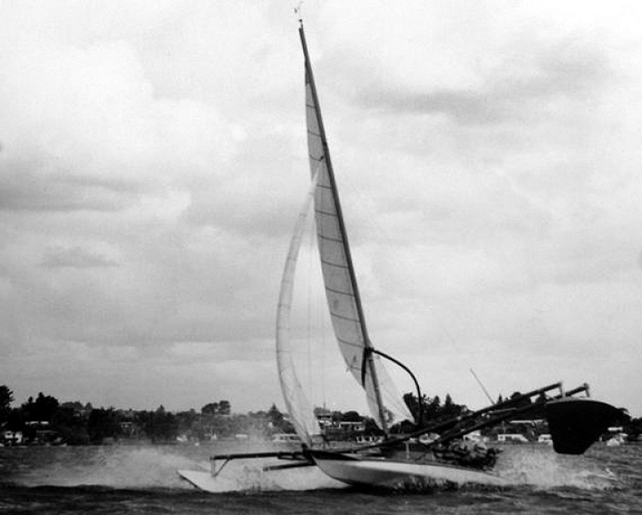

    As usual, Douglas, you see what your mind wants to envisage ... and not reality (like your fantasies of your momentarily hopping toy of years ago) - this regarding your posted image of Hydroptere where the planing float sections are not working because the float is airborne from foil lift.
    Actually, and forgetting the usual LoRd nonsense, it appears that Hydroptere in that image is skidding savagely sideways, hence the huge area of spray and turbulence being thrown to windward. Here is an old 1970s photograph of a real foiling pioneer, Noel Fuller's Sabrina with also 45 degree foils somewhat similar to the much later Hydroptere - check the different foil spray thrown to leeward.
