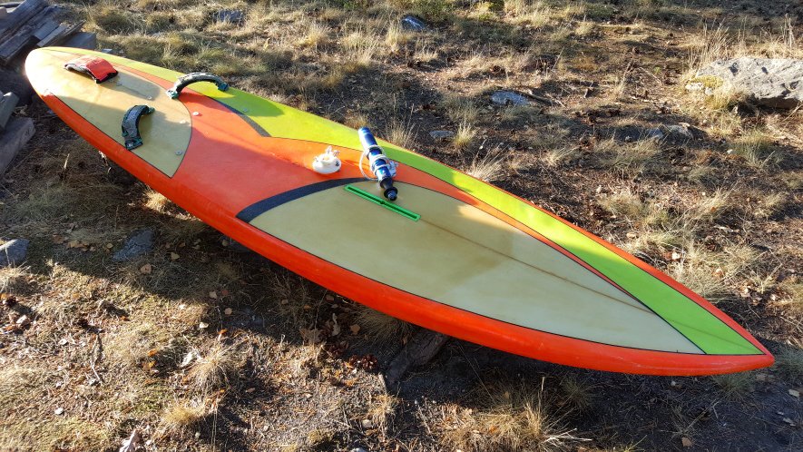

    Manfred, the split surfboard must be the way to go. Actually got inspired by the split surfboard from Waynefarlows F16 tri on page 63. Found a dirt cheap short surfboard and have just started collecting the other stuff for this Frankentri project. No carbon needed ;-) .
    Used aluminium tubing when building new beams and wings for our two Nacras, so those parts will be easy to build and the workshop capacity is good. I also have a Tornado and a Nacra mast to cut down, even if they probably are to stiff and heavy for this. Was also thinking of cutting down a Tornado main I have.
    My main concern at the moment is what foils to use. Will either use Hydrotroptere style or V-foils like Doug Halsey, the latter type seems to be easier to build.

    Yes, that is the other way - to take two smaller boards as Waynemarlows did - and Randy Smythe in Everglades Challenge 2018 with a special bottom profile. The tri
    SYNERGY was very fast but seemed to have not enough buoyancy for sufficient static lift (besides hydrodynamic lift) with the surfboards. He capsized.

    I think that we can develop the necessary volume on the upper side of the surfboard to provide the needed lift by buoyancy when the speed is too low for some reason, here attached 2 examples.

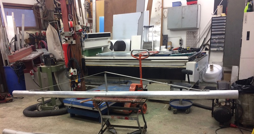

    Haha, I´m 67 and quit Tornadoracing 1985. At that time it wasn´t even allowed for me as skipper to use trapeze, so I am still at that stage ;-) . Anyway rebuilt a Nacra 5.5 this winter with wider beams and provision form singlehanding, third picture from top. So I might try soon.
