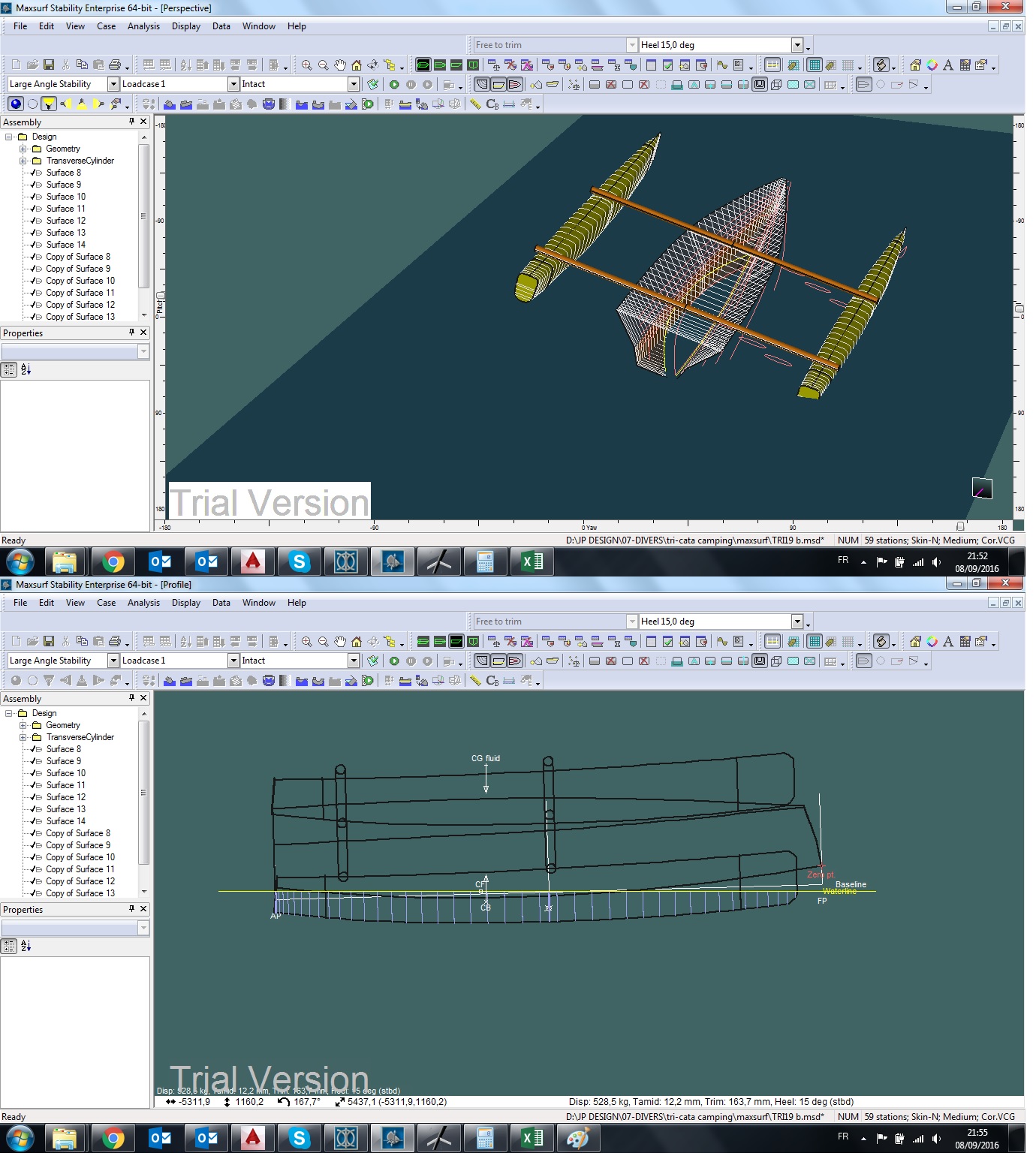

    hi there
    I am going through the design phase of the often done before "trimaran using F18 hulls" combo, and I have a couple of questions:
    my first question is regarding the height of the amas relative to the central hull:
    option 1: I design the central hull to be at DWL in lightship condition with the amas just kissing the water
    option 2: I design the central hull to be at DWL in fully loaded condition with the amas just kissing the water
    I have made quick models in maxsurf using both configs and as expected option 1 offers more righting moment, clears the central hull with a smaller heel angle, but has the windward ama closer to the surface for a given heel.
    any advice ?
    my second question is regarding the shift in LCB when heel increases and the buoyancy shifts from the central hull to the ama. I can design the central hull with the LCB positioned according to my weight estimate, but I have to make do with my F18 hulls which have the LCB further forward, so as the boat heels, the boat pitches bow up by about 3°. Of course this is not taking into account the bow down pitching moment due to the sails but I don't know how to account for this in maxsurf.
    I have tried angling the amas bow down by 1° which helps a little but very quickly starts looking odd.
    again, any advice ?
    some numbers:
    central hull length 5800mm
    amas 5500mm, volume 780 liters
    estimated lightship 260kg
    estimated fully loaded (3x80kg crew + tents + beer etc.) 535kg
    attached perspective and side view for option 2 fully loaded at 15° heel
    thanks in advance for your help !
    Jeremy
