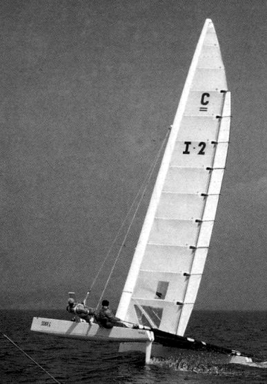

    I'm mentally dicking around with a deck sweeping main on Frog. Which is a double sided main only, poor mans' solid wing rig, no jib (just an offwind reacher/whatever).... so, instead of you ducking under main boom, or diagonally battened deck sweeping lower sail, why not move across, when tacking/gybing, in front of the mast?
    You'll need some more trampoline forward to achieve this.
    And you will have to wait to leeward until the boat gets moving on new tack before crossing to windward.
    Your long floats will be able to easily carry your temporary-to-leeward weight.
    And everyone knows a deck sweeper main is way more efficient than the conventional and aerodynamically silly setup.
    photo: deck sweeping soft/hard sail C Class main; Signor G.

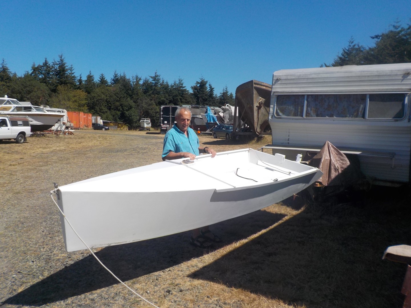

    For the last few years I have been working on a variety of small trimarans, all under 20ft, all simple to build in plywood. Strike 15, 16, 18, 20 plus the 10ft Tryst
    adding to that list now is the 14ft Zeta. We launched it yesterday, in very little wind
    Fortunately there was a bit more wind today so I could test it properly. But before going out I wanted to show how light the boat is. So here are two photos, one of me holding up the main hull, the other holding both outriggers.
    And then here is a video of the first few minutes sailing. Yes I know, it will get a screecher soon, and the mainsail is horrible (but then it is 20 years old and has been on several boats in its lifetime)
    https://www.youtube.com/watch?v=AS7rgAbw9OU
    More on the Zeta trimaran here.
    http://sailingcatamarans.com/index....-under-25/458-zeta-14ft-singlehanded-trimaran
    It will be on display - hopefully finished! - at this years Port Townsend WBF
    www.sailingcatamarans.com
