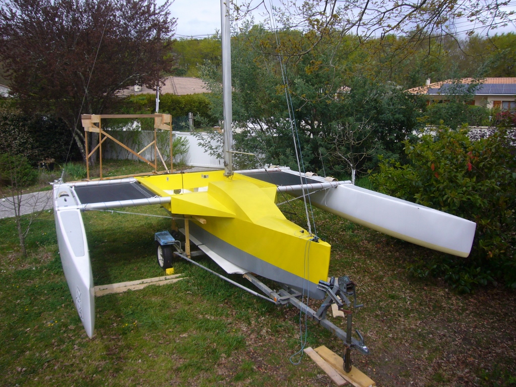

    Nice building but it looks very small beam, comparable to my Strike 15. Not very powerful in comparison with my Strike 20 !

    Patzfran reported today that he sailed his Strike 20 for the first time yesterday. Very sensibly he was overloaded with lots of tools and spares never mind a dinghy plus outboard "just in case"
    Even so in light winds and three crew he recorded speeds over 12knots and said it was a powerful stiff boat
    He is an Acat sailor and has had many trimarans in the past (Twiggy, Tremelino etc so has a good knowledge base)
