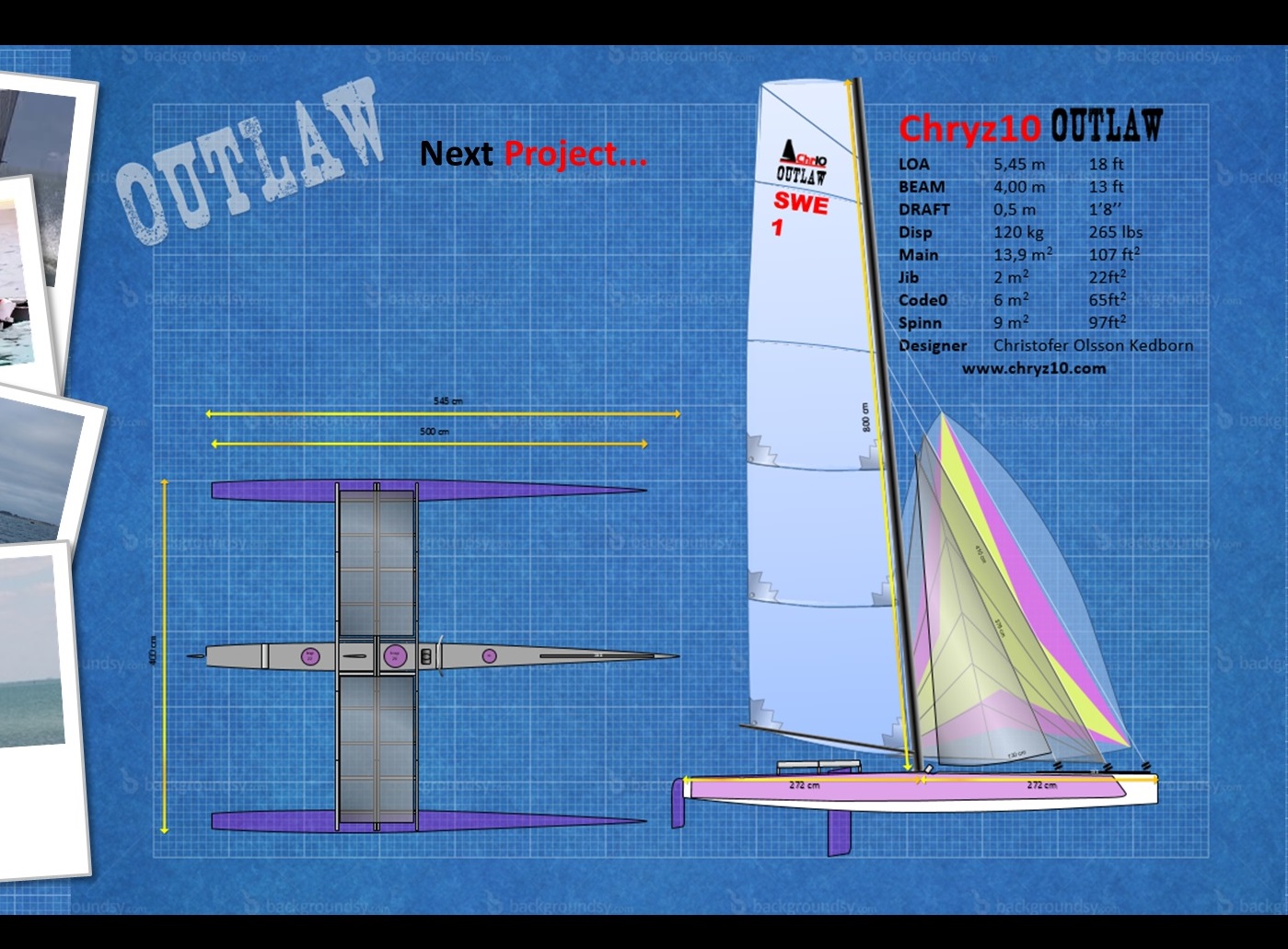

    Chryz10, build and design updated
    Hi, Just want to share some photos of this years project, Chryz Outlaw.
    Chryz10, is soo last year. The new boat will be bigger faster... and faster :)
    Please share your thoughts. During winter I also got exam at International School of Yacht design,which where we learned all the basics about designing floating stuff :)
    More updates at my blog, www.chryz10.com
    br

    Cool! Four things to consider:
    1-seems like the daggerboard may be too far aft,
    2-seems like the boat could use platform dihedral so the amas don't both touch the water at the same time,
    3-unless the cross arms "scissor" like Randy Smyth's SewSew(EC Challenge tri) the tramp may not be "long" enough in the fore and aft direction for moving weight aft?
    4-well designed ama foils(and/or planing amas) could allow you to cut the ama weight and length in half. Either/or provide dynamic lift reducing the need for buoyancy.
    Best of luck!

    Thanks for the concerns Doug
    1. Hopefully not. It is where it is.
    2. This I really need to avoid! I have a plan for this
    3. The Sizzor has very short tramp as well.Shorter. This will be very exciting for the first test-sailing. Maybe it will dive, maybe it will wheel over. I have bought a new action-cam for the test-sailing anyway :)
    4. Probably some C-foils could help or others, but thats a too big step for me to be ready in the summer.
    br, Chris

    The SewSew has a small tramp alright, but the thing pivots so that the lee ama can be moved forward and the weight aft:

    Thats a great photo of Randys wreck ;) My amas will be close to same length as main hull. That could help some I hope. If it turns out to be a true submarine, then I have to move someting aft. The mast is placed exactly in the middle of the main hull

    The Smyth boat could have a bigger tramp, pivoting same as it is and it would give you the option of sailor weight 2-3' farther aft in heavy weather.
    Especially since the bow is very narrow with little inherent bouyancy to prevent a pitch pole.
    As it is I'm assuming he has to relieve pressure with the mainsheet, in really heavy weather on a reach.
    It would be better to hear it from his mouth, of course, not an armchair critic.
