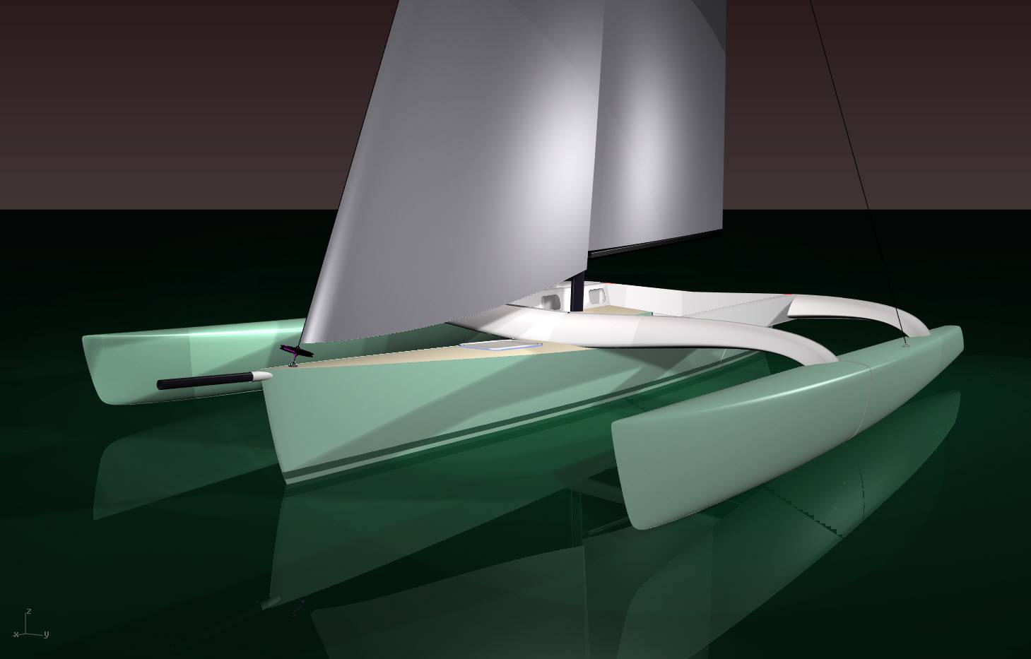

    Extrem 16
    Looks like Perspective Design will introduce a 16 footer very similar to their 19' foiler tri which still hasn't been introduced. Something to look forward to. Don't know any details yet......
