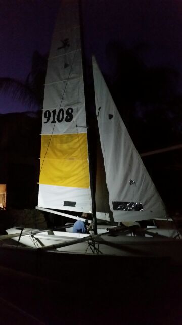

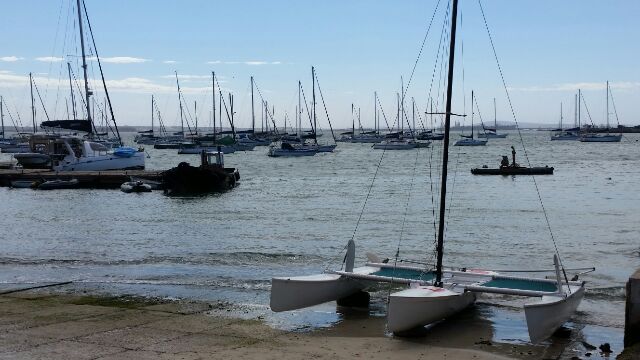

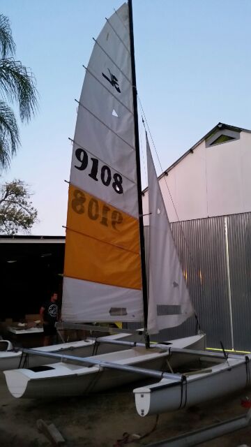

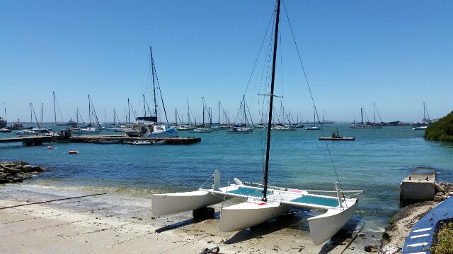

    Long story short.
    Got a vaka from an boatbuilder/engineer for free, he had designed the hull to match Hobie 18 for rig and amas 12 years ago. So i bought the hobie and we built the tri. So this summer holiday we used it and fine tuned this prototype. Obviously a prototype and not a production ready boat. Our conditions where we use her is 10 - 35 knots of wind. Did a downwind solo blast in 45 knots of wind. Short chop up to 1 meter +. Area is Langebaan lagoon on the West coast of SA.
    Length 5,8 meters
    Width 4,4 m
    weight 320 kg
    Glassfibre with aliminium tube akas and spectra water stays.
    Boatspeed 15 - 22 knots.
    Issues - she is very wet. We will fix this in the next one.
    whats right - super stable, very forgiving, very quick, easy to sail, points very well,
    moves very well in very light winds.
    a few points.
    A lot of info says that the amas must just touch or almost seesaw from side to side when unlayden. On the prototype the amas are in the water. This makes her very stable when camping and also when the wind picks up. And in light wind she still moves well. More wetted area but more stable in a blow.
    Unfortunately we have no other boats to test her against but what a joy to sail. Trimarans are not big here so all info is via this and 3 other sites. So as soon as i get pics loaded i ll appreciate all feedback given.
    thanks

    Here some pics. Fire away
