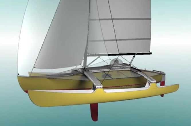

    Just like to post a new 20 ft Tri project I fell over in Wooden Boat Magazine. The concept of the EUREKA is interesting as this tiny boat is combined with an "eco friendly" propulsion: a Sea Bike.
    EUREKA is a 20′ (6.1m) demountable (“take-apartable”) trimaran suitable for long-distance coastal cruising and adventure racing for one or two. Empty weight is approximately 500 lbs (230 kg), with a payload of up to 600 lbs (270 kg).
    The boat is drawn with an aft “pedaling” cockpit, and a small cabin centered between the akas (crossbeams). Both have steering stations: the first with joggle sticks (or vertical tillers connected to tiller lines or rods) and the latter with foot pedals—kayak style, with one pedal on each side of the centerboard trunk.
    The single berth flat sits directly above the trunk and runs forward, under the foredeck. The boat is completed with a kick-up centerboard and rudder to reduce the chance of damage in the event of grounding or hitting a submerged object, especially at speed.
    The EUREKA parameters...
    LOA 20′ (6.1m)
    BOA 13′4″ (4.06m)
    Draft 9′ to 4′10″ (0.2–1.49 m)
    Weight 500 lbs (230 kg)
    Sailing displacement (half load) 800 lbs (363 kg)
    Working sail area 220 sq ft (21 m2)
    Reaching spinnaker 180 sq ft (16.72 m2)
    Bruce Number* 1.64
    *The Bruce number is the square root of sail area (in square feet) divided by the cube root of displacement (in pounds). It relates power to weight, so is a predictor of potential speed.
    Source: http://www.woodenboat.com/eureka-2

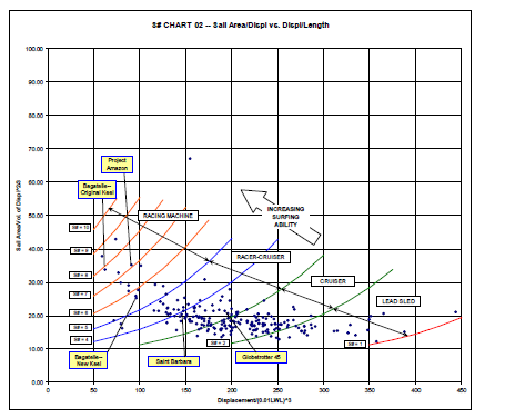

    I think Eric Sponberg has some comparative data here: page 37
  8. Skip JayR
    Joined: Sep 2015
    Posts: 367
    Skip JayR Tri Enthusiast
    Thats pritty interesting stuff... many tks, DoughL. Why is life so short ??? If I'd have another 50 years I'd study naval architecture design. I love that... :)
    Scrolling through I found on page 25 an interesting chart which indirectly addresses my question, too. The Sails area / displacement ratio vs. displacement/length ratio. So many tks.
