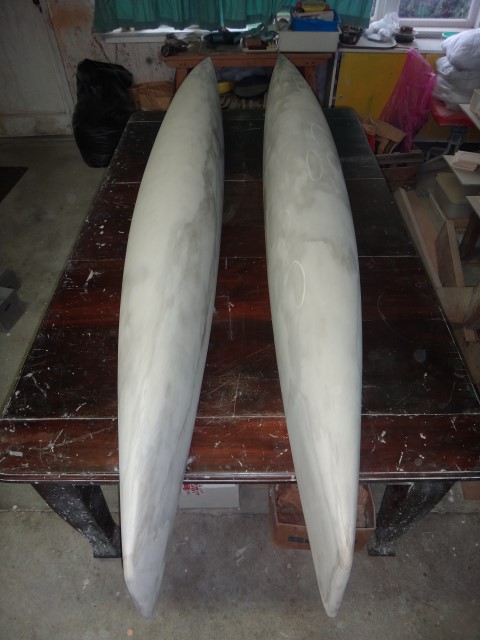

    Kayak tri project
    A kite surfing rocket sport yet to take off?
    I'm building a sailing Tri-kayak with 2.3 m asymmetric hulls. I thought maybe these hulls would assist to windward and tacking. I have a clever system for one handed spinnaker gibing and hope to use a main something similar in size to a windsurfer. And the outrigger wing design will enable paddle and sail. Might have to paddle through the tack. But will asymmetric hulls assist?

    The question is: will asymmetry reduce leeway? When Hobie Alter copied the hulls of Woody Browns catamarans and developed H14 and H16 with great economic success he was convinced that asymmetry would do exactly this. Later he said that it is the horizontal board of the flat outside which provides some leeway resistance.[​IMG]
    If you want help from asymmetry you have to develop the special profile and test how it works under certain angles of attack. I think it is the flat outside of the hull which gives you the possibility to go to windward. If you use a simple keel you might be better to windward.
    The may be best solution I saw from one of the famous Gougeons (Meade ?) with a deep long centerboard outside of the hull.

    Sure a centerboard or daggers under pontoons is great for leeway but also I feel that when heeling over even a small degree, the more rounded (longitudinaly) outside pontoon may assist turning through the tack and any depth of hull below water line including skeg or dagger/centerboard also provides a turning fulcrum or pivot point which as you say is preventing leeway. If the water has further to travel along the outer side of hull then there should be more pressure I think much like a wing sail. Just my feeling as I have no academic learning, though I used to sail a 14' Windrush cat that had deepish asymmetric hulls but know fins. I did however make very deep dagger rudders which may have helped.

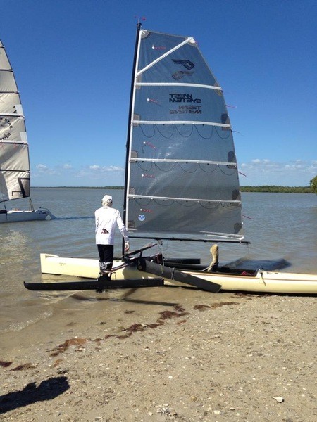

    Lombard Foil Assist Small Tri
    This was just found on Freds "Foilers!" site and is a tantalizing glimpse at a Marc Lombard designed small trimaran with "C" ama foils and a rudder t foil. No details unfortunately! Nothing on Lombards site either. Just guessing: 16-18'?
    UPDATE-I wrote to Fred and he's going to try to contact Lombard.....

  12. rcnesneg
    Joined: Sep 2013
    Posts: 456
    Likes: 6, Points: 0, Legacy Rep: 58
    Location: Utah
    rcnesneg Senior Member
    Woa! That looks very tantalizing! Thanks!
