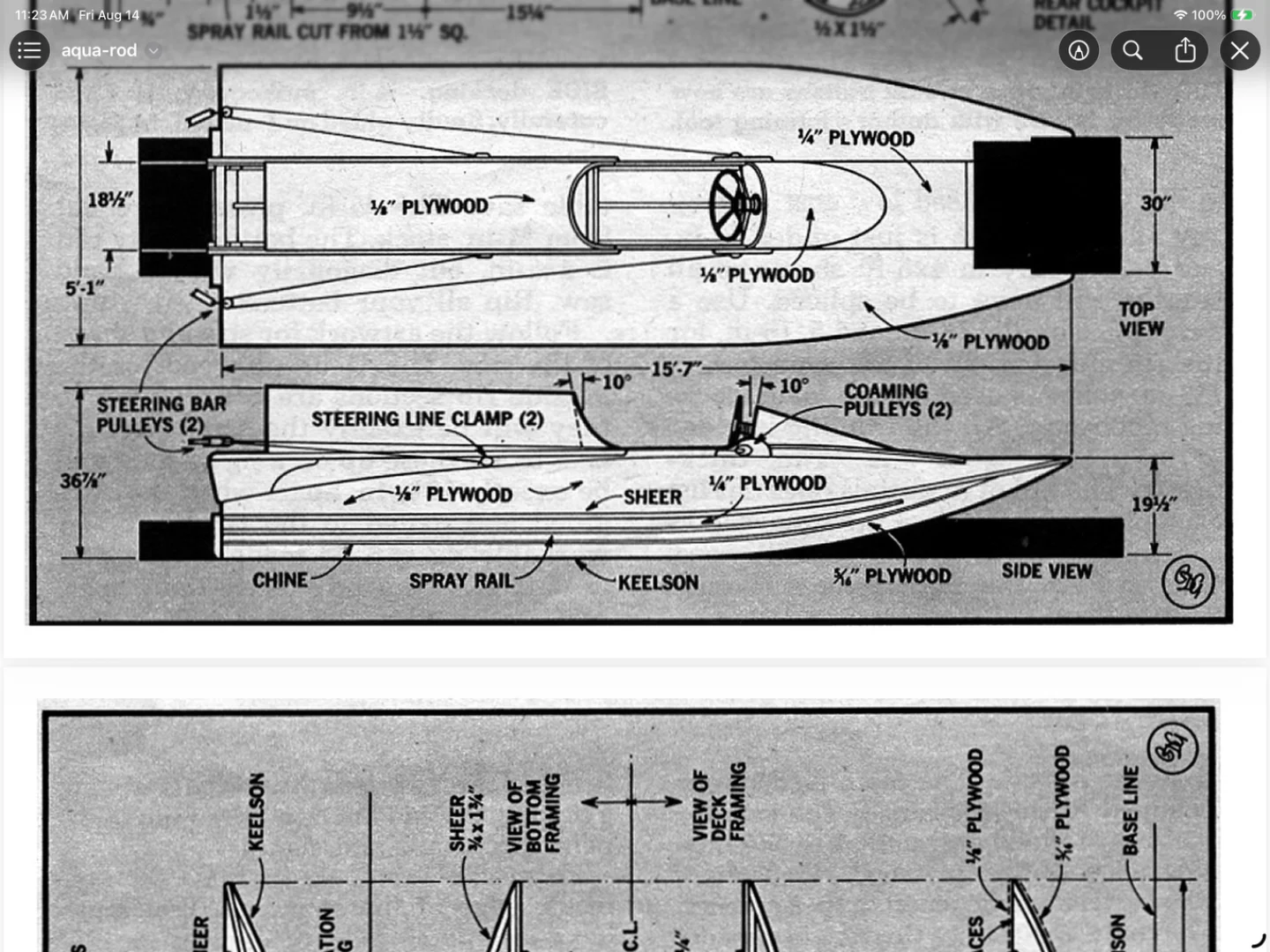

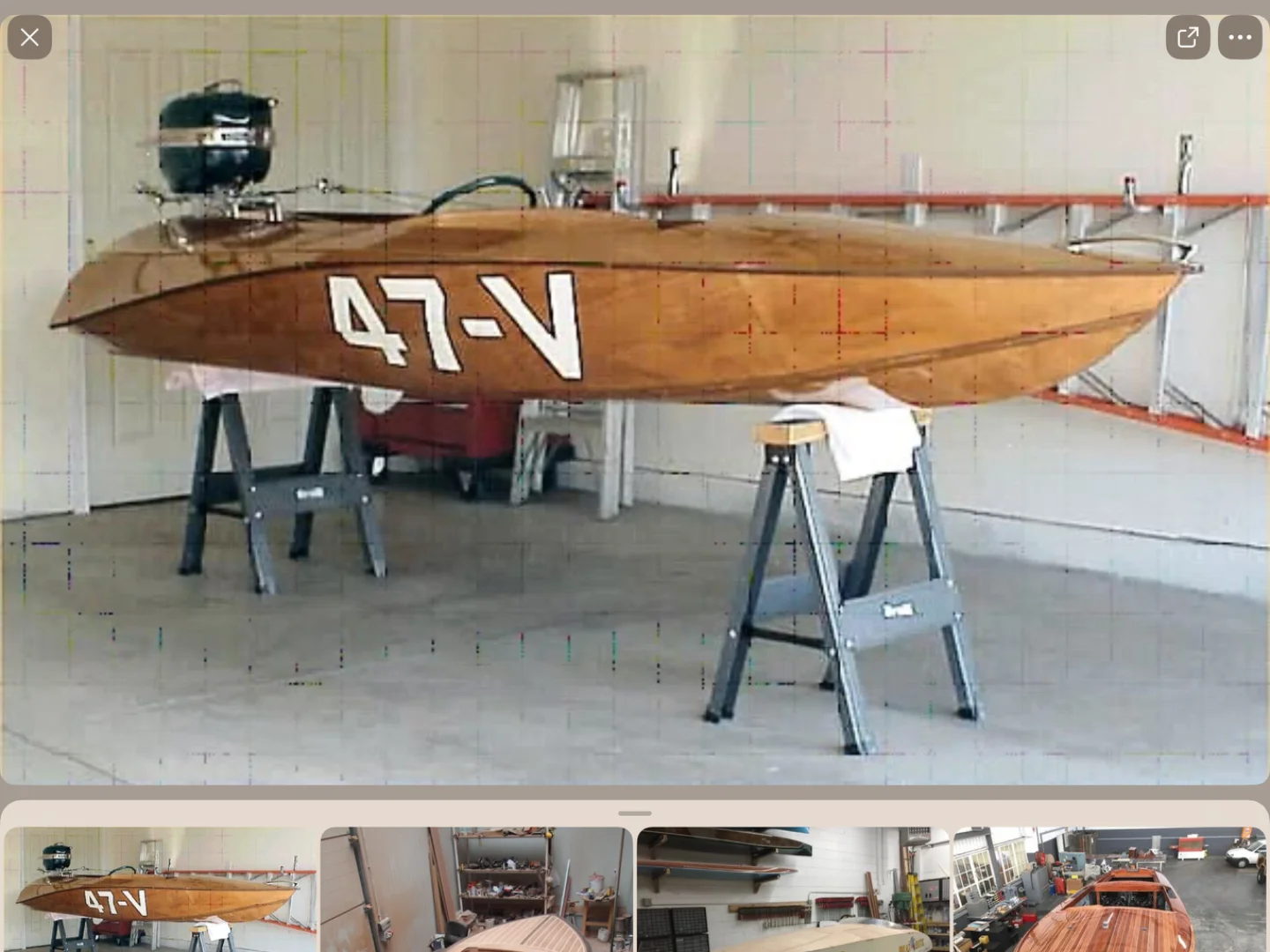

This is what I’ll build but I’m going to cut 4’ or 5’ out of it and from everything I’ve found out ,yes a mold is too much money as well as going the fiberglass route .so I’m going to make it out of wood ,I used to own a sawmill so I have a lot of cured wood in a building out back ,white oak ,pecan,cedar ,a little black walnut .im not in the best shape but I can get this done and I just didn’t want to build a boat and find out that I should of made it a 2 seater .IM hoping a young fella looks at this and has too have it.i used to build really nice homes in buckhead Atlanta,they inspired me to buy a crane ,they were 3 storied monsters ,12’first floor walls and so on .16 sq ft of area to fit the stairs in that had to meet code .but as far as market research,well I don’t speak that language.and I’m not going to go ballistic with it ,maybe one every 3 or 4 months .that why I was wondering what y’all thought had a better chance of selling.tunnel or the v hull thanks y’all have a good one.
Rather than trying to “cut 4’ or 5” out of those boats you might try looking at Glen-L or Clark Craft plans. They have smaller outboard powered boats of similar style.

Op must have an idea of a shape, boat that size should easily fit in an average garage bay.
Seems like a plywood boat that could act as a test platform as well as become the plug makes the most sense. Balancing a boat that small and getting it right first go around is a long shot. Probably going to have a few iterations before you get it just right. Not terrible hard to make a mold off a plug, easier than getting the plug faired and ready.
Im working on a new iteration of dingy, about the same size as your talking. Last one was with leftover core and built as a one off. Turned out a bit heavier than what I wanted as well as to deep a v for beaching. Next one is going to be out of a mold, with high speed low drag materials and thinner core. Guessing Ill be about 500 in the plug, maybe another 700 in the mold. Between the carbon, epoxy and core Ill be more into the first one out than the nicest inflatable currenly in its size range. Thats assuming my time is worth 0... going to make those expensive carbon dingys look like a bargain.
* just realized the op responded while I was typing
This thread has got me thinking that I need to make a new dinghy, because after 15 years or so the one I made has seen better days. It is going to be about the same size as the old one (8’6” x 3’6”), but I want to modify the bow somewhat.
I’ll start a new thread as I get going on it.
The new plan sounds great. It's right inline with your current skills, you already have the materials to start the project, and you don't need a specialized shop just for this.
