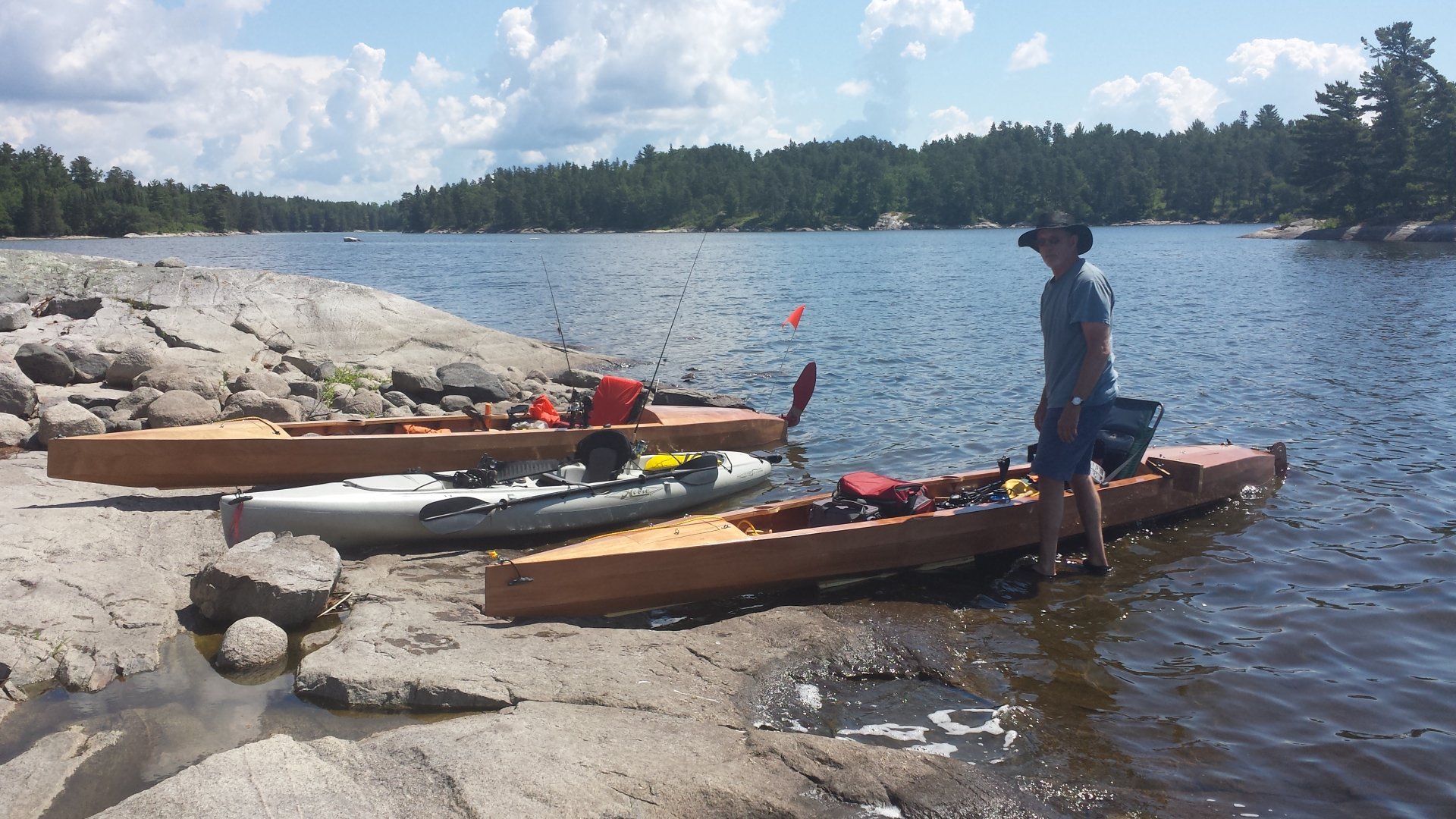

    Sorry to be "late to the party".
    I hope your purchased boat plans are working out for you. I'm not trying to sell you anything... just telling you about my similar experiences.
    I'm an avid kayaker and novice kayak/small boat designer/builder/operator. I'm very familiar with your Hobie Revolution sit-on-top as I used to own that same model as well as an I-14 and a Tandem Island. I'm attaching a photo of my Revolution 13 in between 2 of the wooden kayaks I designed and built. Those kayaks were purpose built for week-long expedition fishing trips we do in Canada. Those boats (almost identical) were fitted with Hobie mirage (pedal) drives. The boat in the foreground (my buddy's boat) was also fitted with a motor mount. He started with a 2.5 HP 4 stroke and was able to travel at 9 MPH. Later, the he switched to a small trolling motor/battery but his speed dropped to 3.5 MPH. For our needs (distance and speed) the gas motor was the better and lighter solution.
    This wooden kayak is self-bailing and offers a very dry ride until the waves get big enough to crash well over the bow and into the boat. Then you can get a bit wet. The added floor structure makes the hull very strong and can easily accommodate load points for wheels, but the extra strength has resulted in a hull weight of 115 lbs without the motor or battery. This kayak is 18.5 feet long with a waterline beam of 26.7 inches. We built these as tandems, but for the fishing trips we always had just 1 guy in each boat due to the large amount of camping gear we took with us. There's a small hatch forward, and a very large hatch aft. With the low CG it is easy to keep upright, but the narrower (than Hobie) hull form results in much better speed when pedaling, paddling, or motoring. These boats are made using 4mm marine plywood that was machine cut from my design files. Construction method is stitch & glue using epoxy and the exterior and interior have a layer of 6 oz glass cloth. Overall, this design has served us very well. I sold my kayak and designed and built a 17 foot motor beach cat that uses a 10 HP motor. My buddy still owns his kayak. I'm in the early stages of designing my next boat, and I'm going to be asking for some help from this group before I get too far along on that one.
